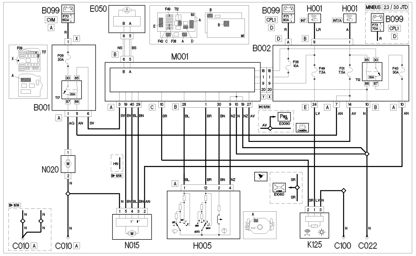

Hello,
That's the diagram, all 2009 x250 engines except the 2.0 l Ford engine.
N015 beeing the wiper motor, N020 the wiper liquid pump, C010 the ground point, M001 the body computer and B002 the fusebox by the driver's knee. Fuses F43 and relay T12 seem to be involved. The BCM reads the state of the wipers lever, so no direct contact between the lever and the motor. All goes via CAN. If so, there should be a possibility to make a test in MES. (EDIT: I couldn't find one).
Apparently there was a technical note released by FIAT saying that the ground cable can be faulty (probably the black one on the pin 1 of the motor). Try adding another ground cable from the battery to confirm / eliminate the cause.
I'd also check the contacts of the fuse and relay.

Hello,
Are you 100% sure the new motor is OK?

I wouldn't believe a multimeter with SEVEL earth cables :D Seriously, it won't take a lot of time to make a temporary earth cable to check. The technical note was not released without cause.
