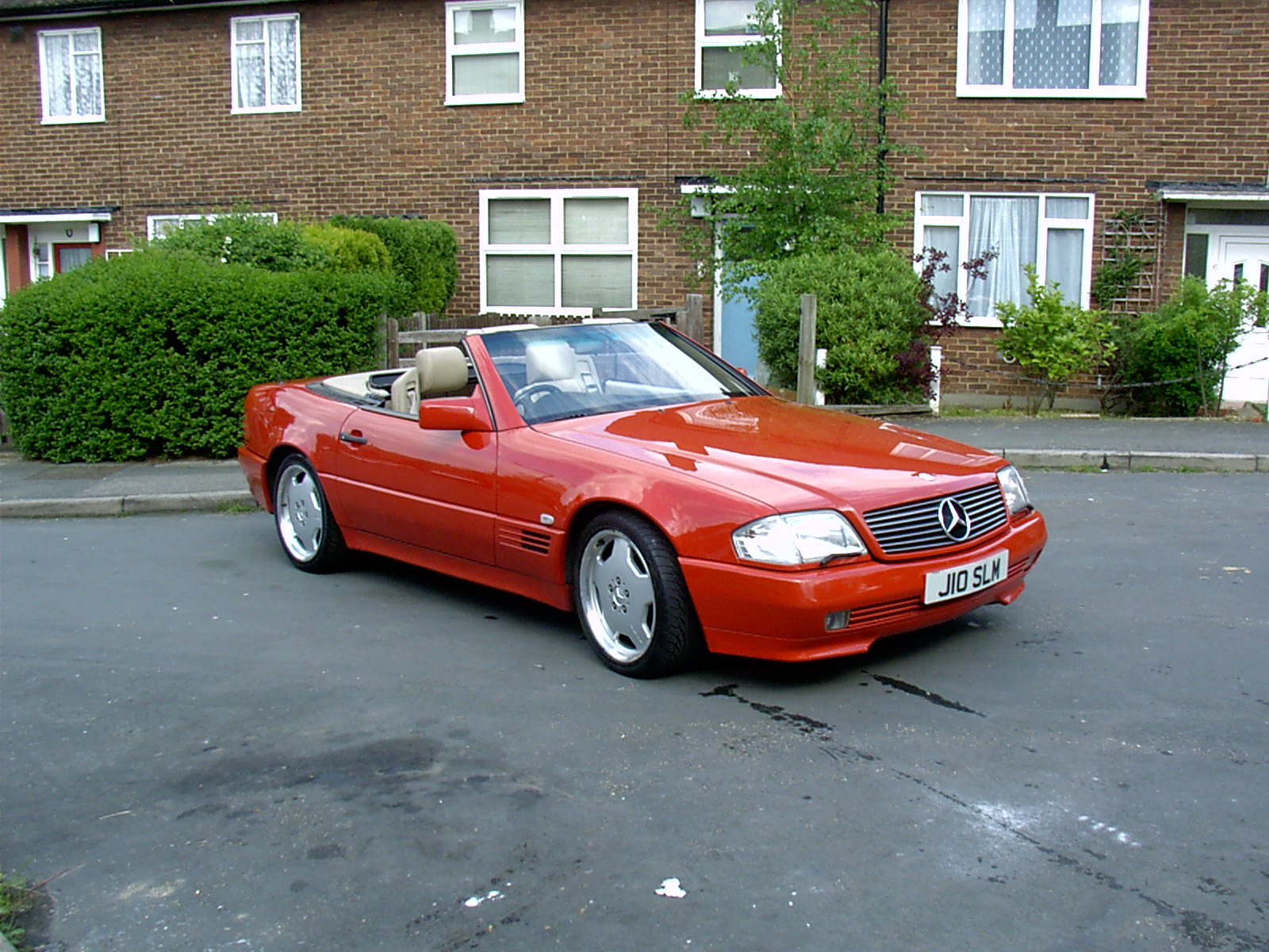

My real baby is my Mercedes 300 SL 24V I have attached a pic, unfortunately I have a real baby arriving in a few weeks time so she has to go.
Looking at a Citroen XSARA Picasso hdi which seems to tick all the boxes as a family car.
Will of course be keeping the uno for work and running around in.
Pete
