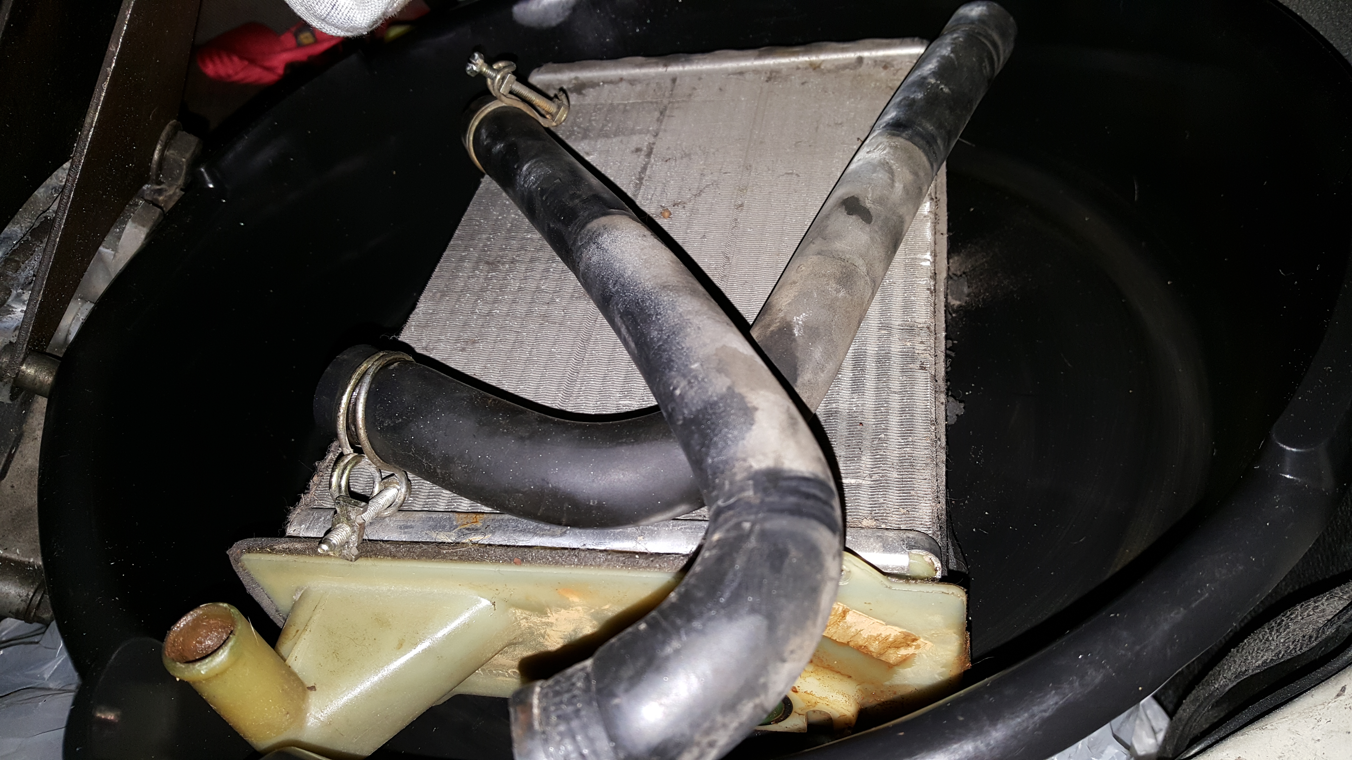

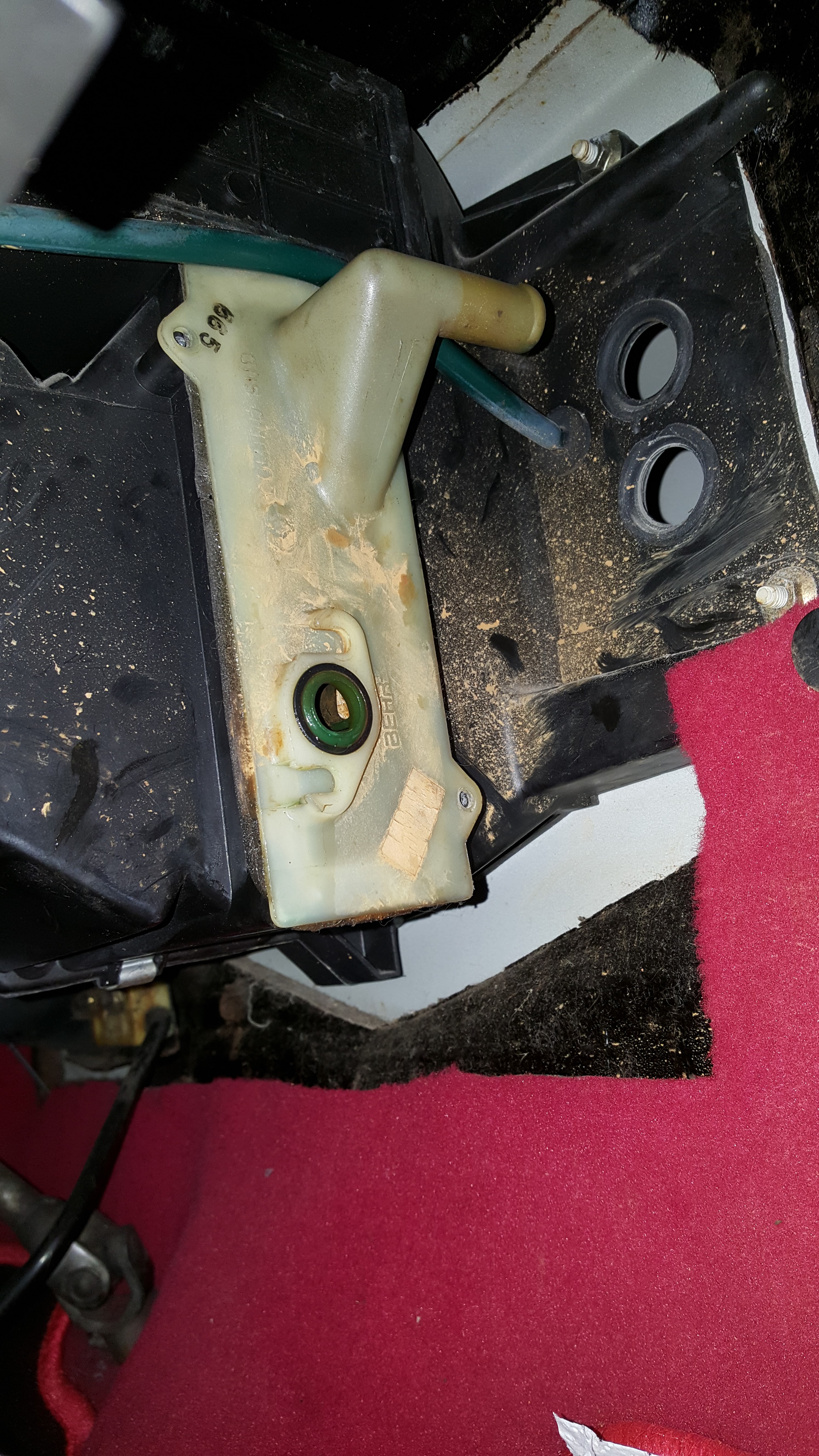

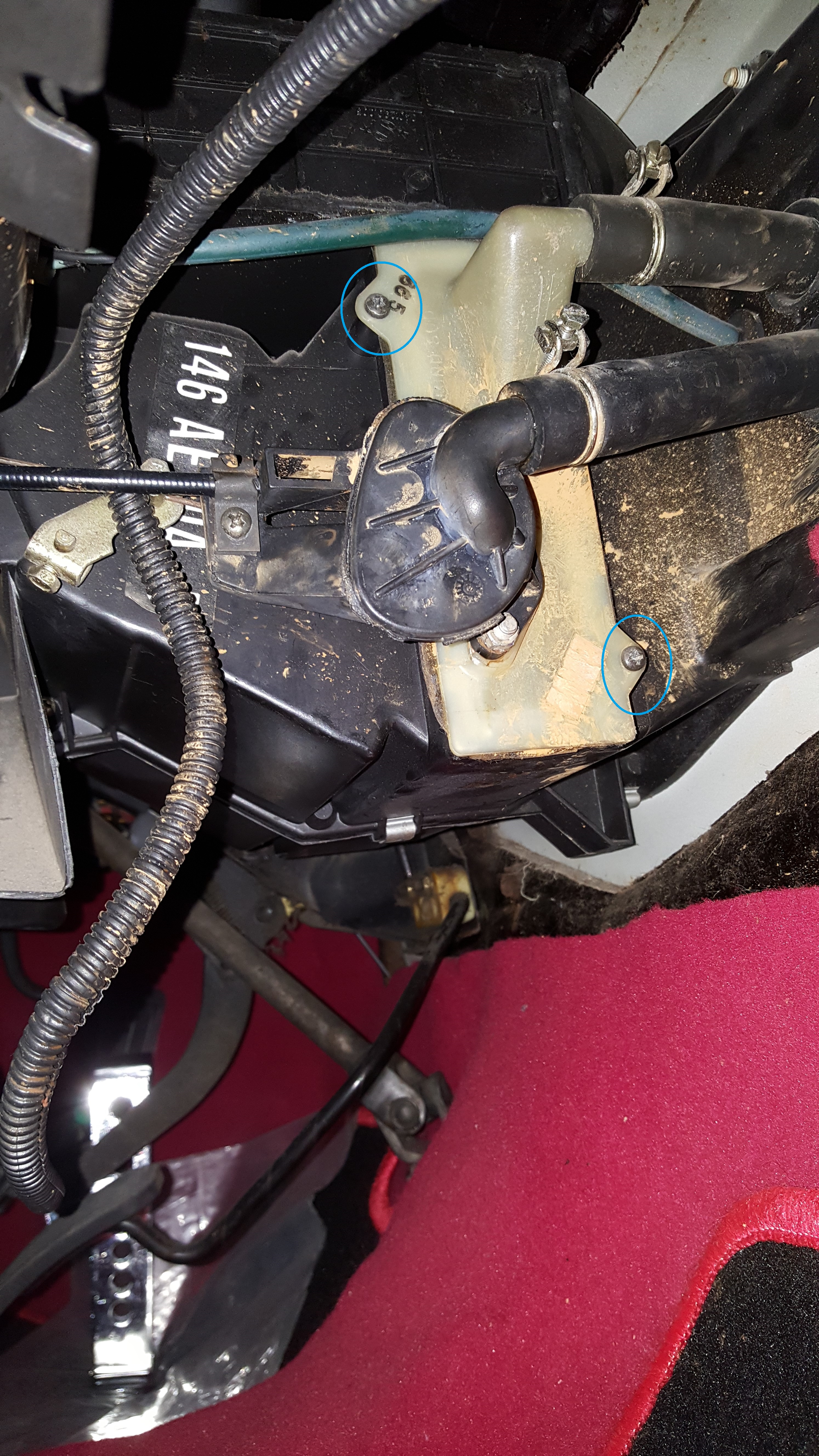

How can I remove the heater matrix? I can see it's held by 2 bolts.
I've removed them but it's stuck. shouldn't it be easy to slide it off?
Do I need the square rubber gasket? the new one came without it.

Ok it came off at last.
It was blocked as hell.

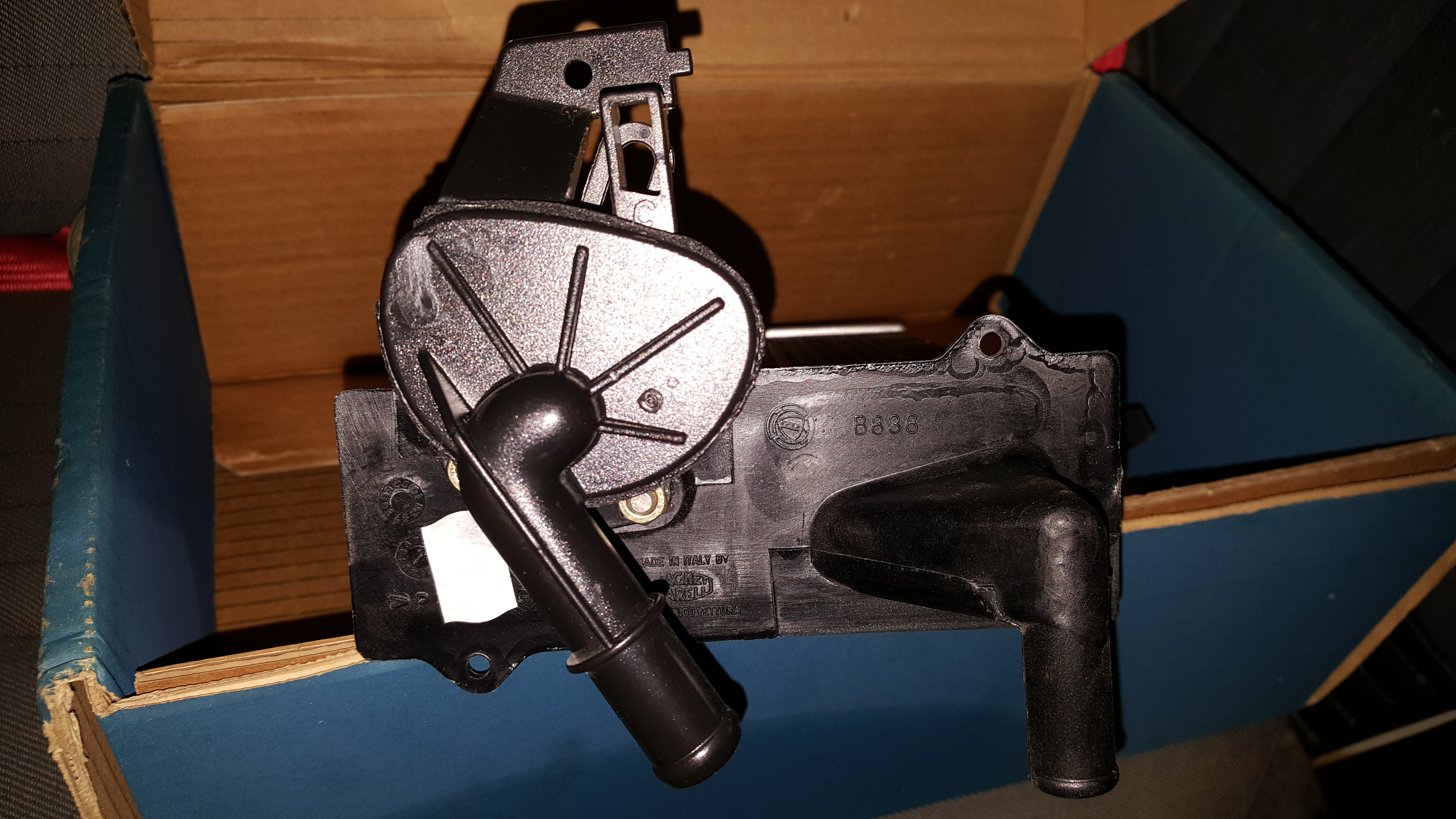

I've installed a new heater matrix,
warm air is coming out the front vents but absolutely not HOT.
Using paraflu, thermostat is new, engine gets to operating temp (middle of the gauge), both matrix hoses are hot to the touch (even inside the car).
Air only comes out when I turn the fan speed to 1, when fan is not on, I get air from outside when the car is moving.
Air is not coming out from the windshield vents, but I can see the sponge door is closing when changing from leg to windshield knob.
Maybe the heating system of the uno is just s***?

How did you manage to remove the matrix? Did you remove the central console?
Hi
nope, look at the first picture
It was held by 2 bolts, I just pushed it out very hard and it finally came out.
Why was it so hard to pull out?
Is your car is left hand drive? The pedals get in the way in my right hand drive..
yes it's LHD
it had some kind of rectangle gasket that covers it, so it came out eventually.
The inflow is the bottom pipe (valve pipe) and the outflow is top pipe, right?
