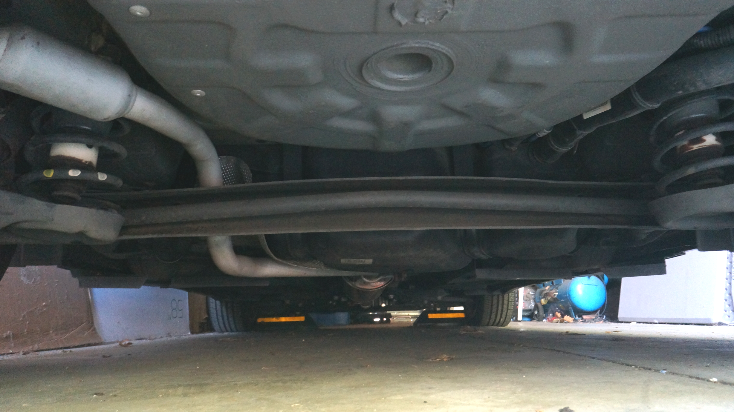

As for the underside, nose to tail scrub, Dinitrol rust treatment and waxed. Missing grommets replaced so almost ready for a paddle 👍.
