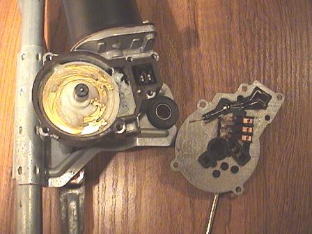

The contacts, where you were working, tells it where to chop power and stop the wipers at the parked position. The copper coloured electrical tracks stop and cut off at the park position. There is no conventional park switch like you find on some cars
The tracks need to be clean (this one had way too much grease) and the contacts need to be making good contact so check the spring has enough pressure to keep it in contact with the tracks
There's no controlling electronics in the motor just power in and earth up one end and the position sensing is done just with those 3 contacts and tracks which feed back to the wiper switch just where the wipers are

As there's nothing wrong with the motor, it's just being told wrongly where to park then I'd still go for the park position sensing mechanism of the 3 contacts springs and the sensing track.
Make sure the 3 spring contact pads are clean and bend the springs as necessary to make sure they're making strong enough contact with the tracks
There are 5 contacts in the wiper motor electrical connector. The 2 outside ones are the motor power and earth so you don't need to bother with those. The 3 in the middle are your park position sensor

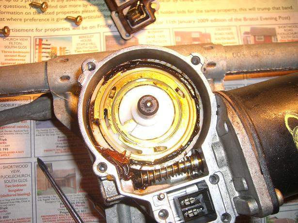

Now that makes a big difference if they start and then just stop, especially if they just stop anywhere and don't park. If so then read this thread from the start :)
The surplus grease in the motor congeals, especially when it's cold and is a great insulator so there's the poor contact. Just wipe it out leaving just a small trace of grease is all that's needed then.
