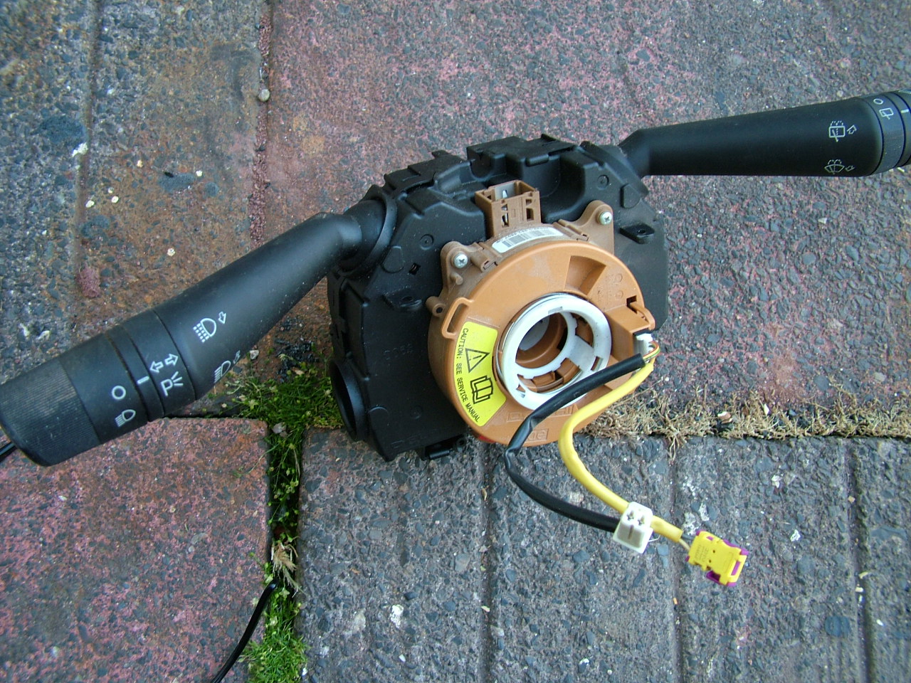

I think you will find it is a complete unit with both sets of stalks as assuming you have airbag in steering wheel the "squib" which transmits the power to the airbag has to revolve around with the steering wheel and even if no airbag as some vans didn't, the switch mechanism is probably built accordingly.
Incidentally in case you are unaware, disconnect battery and wait for a 15 minutes or so before working with airbags as people have been killed by them going off with face near steering wheel!!!
Just to give you an idea what I mean this is off a 2010 Fiat Doblo so you can see the two switches but also the airbag "squib" arrangement that sits around the steering wheel.
You could try spraying electrical switch cleaner spray in any holes and working it vigorously, it may work though modern switches are not designed to be repaired.:(
Thanks bugsymike ... I've got a left hand indicator that doesn't auto cancel so I guess that will be addressed also if I replace the whole mechanism. Two birds with the one stone. 🐦🐦 I'll also do as you suggest and try to get some electrical switch spray into the mechanism.

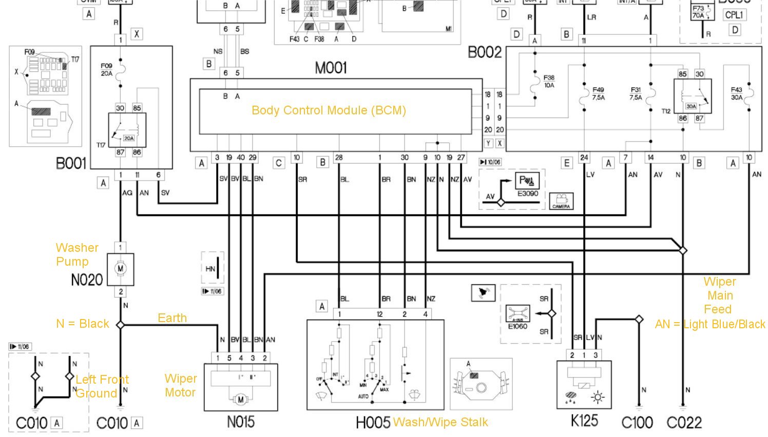

I agree. From examining a now old switch assembly originally from an Alfa 147, and from which I removed the added on cruise control switch, the remainder (lights and wipere are not separable. Further there is little to be gained by removing the assembly from the column.
The x250 operates both lights and wipers via the body compuer module, using resitive encoding to reduce the number of wires.
Attached is acopy of the wiper wiring diagram, which was originally postrd by @Anthony489. While resistor values are not quoted, I have seen them posted by another member. Even witout the resistance values, it should be possible to check the operation of the switch, by checking for decreasing reistance values between connector pins A1 (wipers) and A4 (earth) as the switch is moved from off to full speed.
Thanks Communicator .. that explains why I only see the whole assembly advertised on Ebay. I'll hire an auto electrician if I need to do anything with the wiring apart from plugging the connections in.

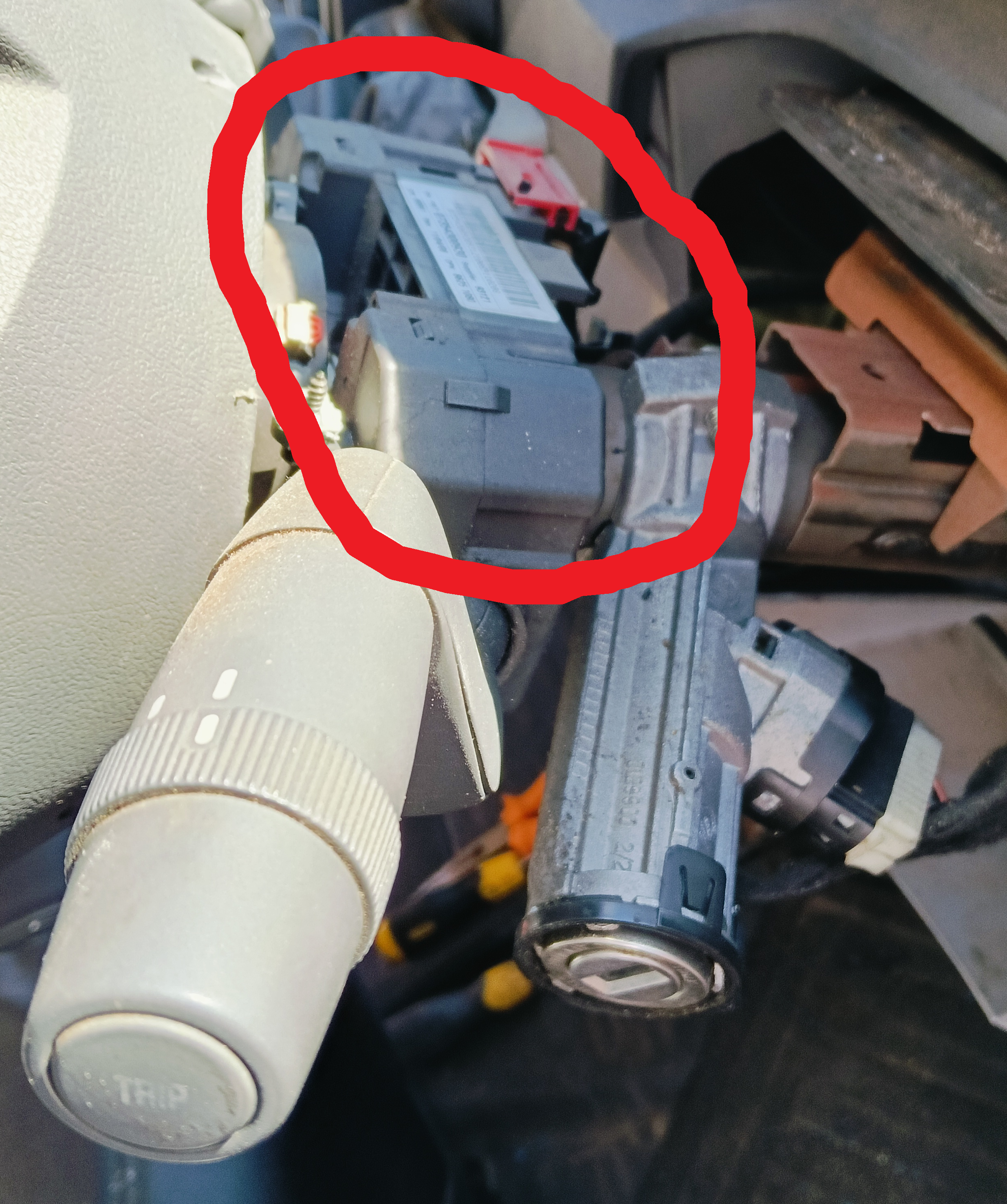

Thanks for all the responses. I previously did a search on YouTube and found a somewhat relevant video (Quick Guide Wiper Stalk Removal Repair Vauxhall Vivaro Renault Traffic .. ) but it was not similar at all to the mechanism on mine, hence my question to the esteemed members of this forum. :) Very telling (in my opinion) was one of the comments "Why not buy one on Ebay?" I think that is good advice and advice that has also been provided in this thread.
