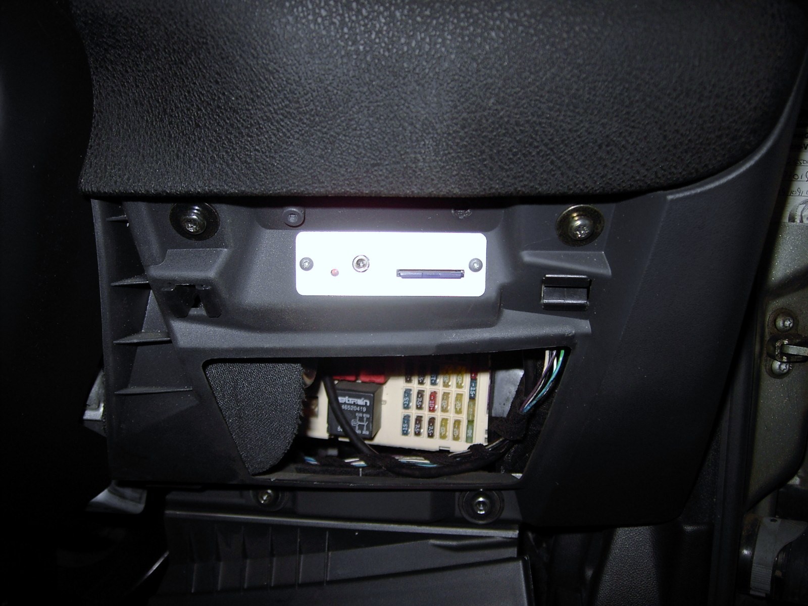

Perhaps this is a problem with the CN+. The LoudLink I have fitted to my CN+ also needs a soft reboot sometimes.
