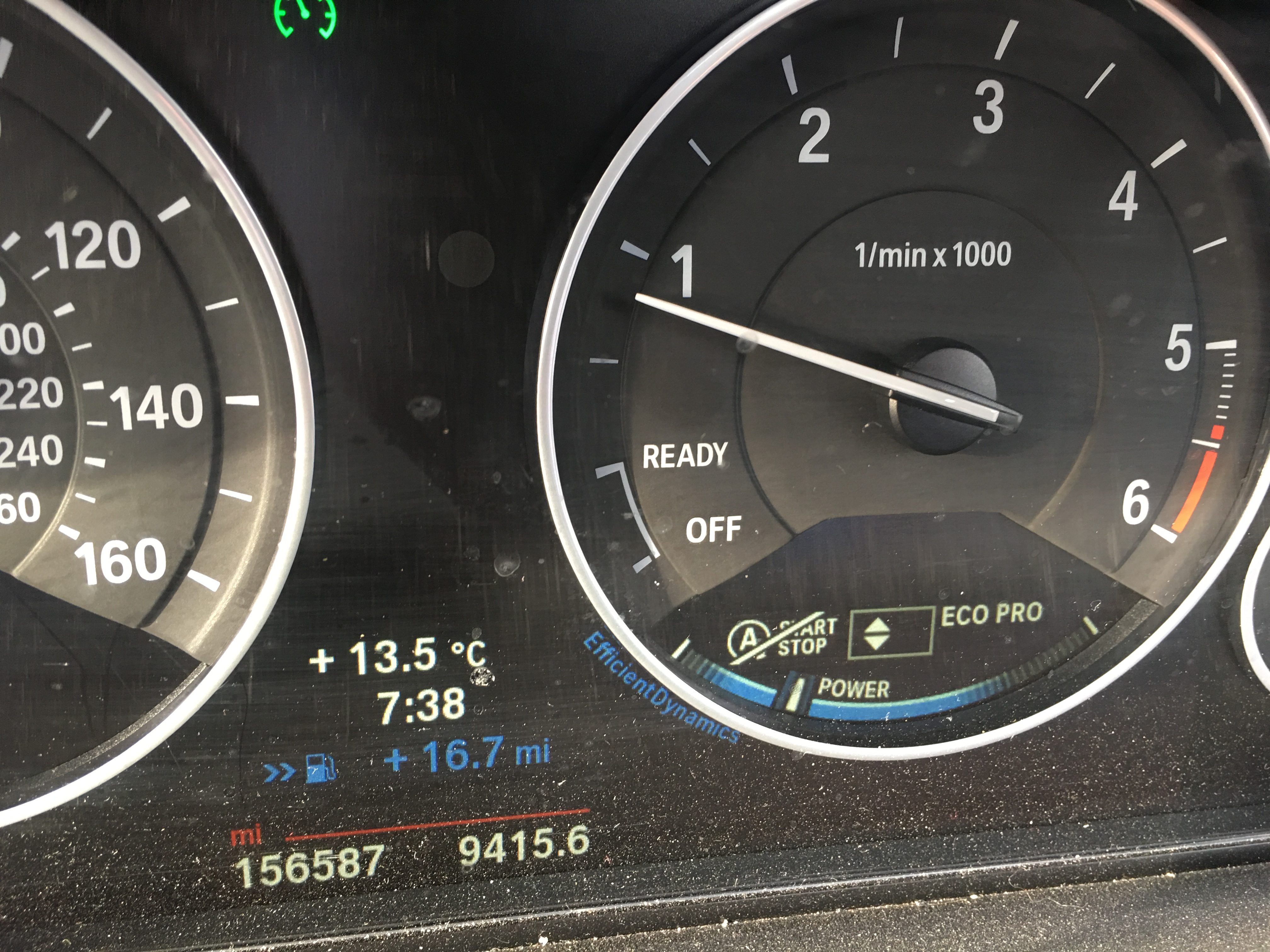

I don’t think S&S is as bad as people say, just the implementation.
That’s the warning I get in my BMW of many miles when S&S is inhibited, in this case because I’d just reversed into a parking spot. The 500 shouts at you when S&S is inhibited which is a bit stupid tbh.

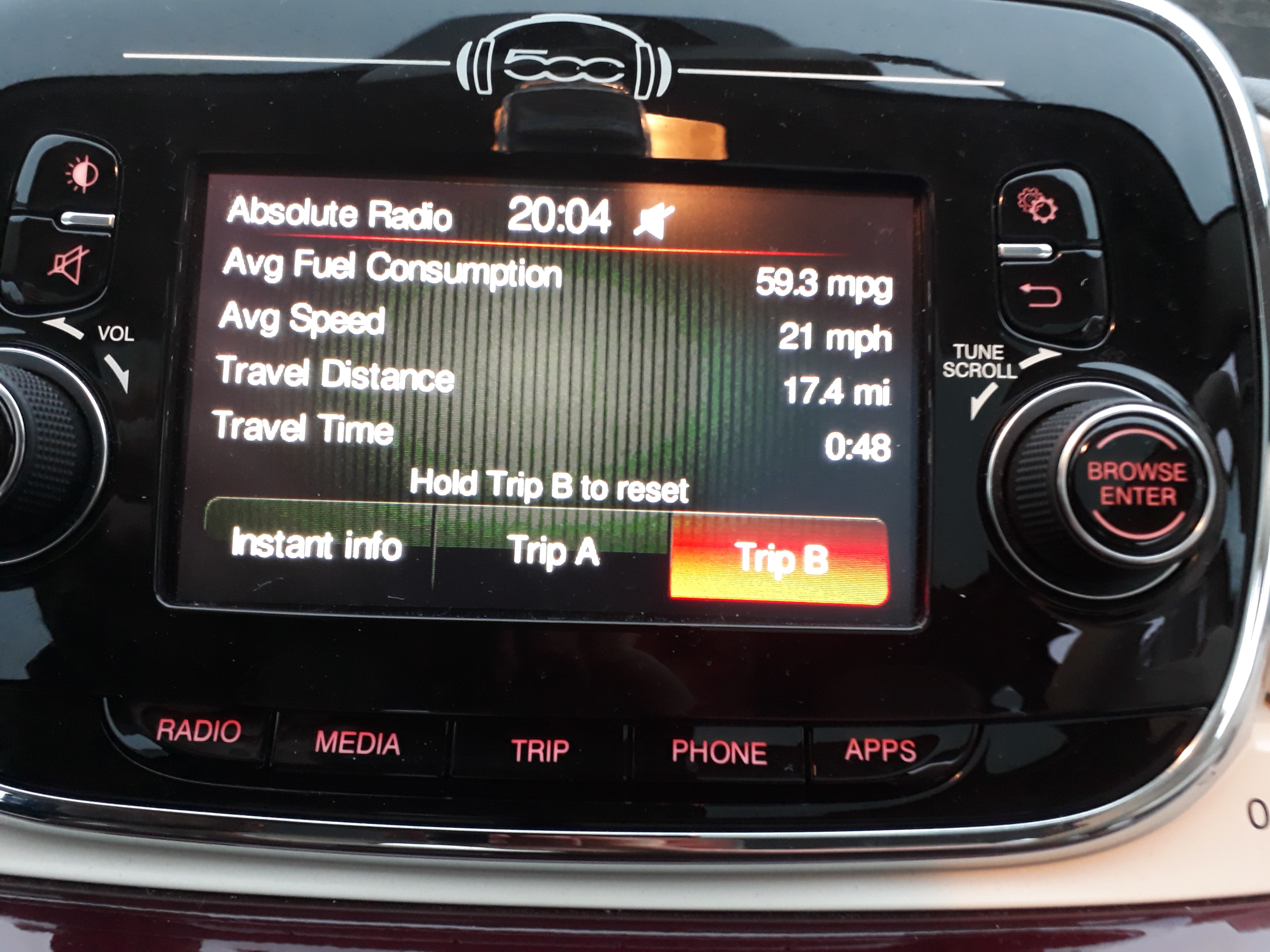

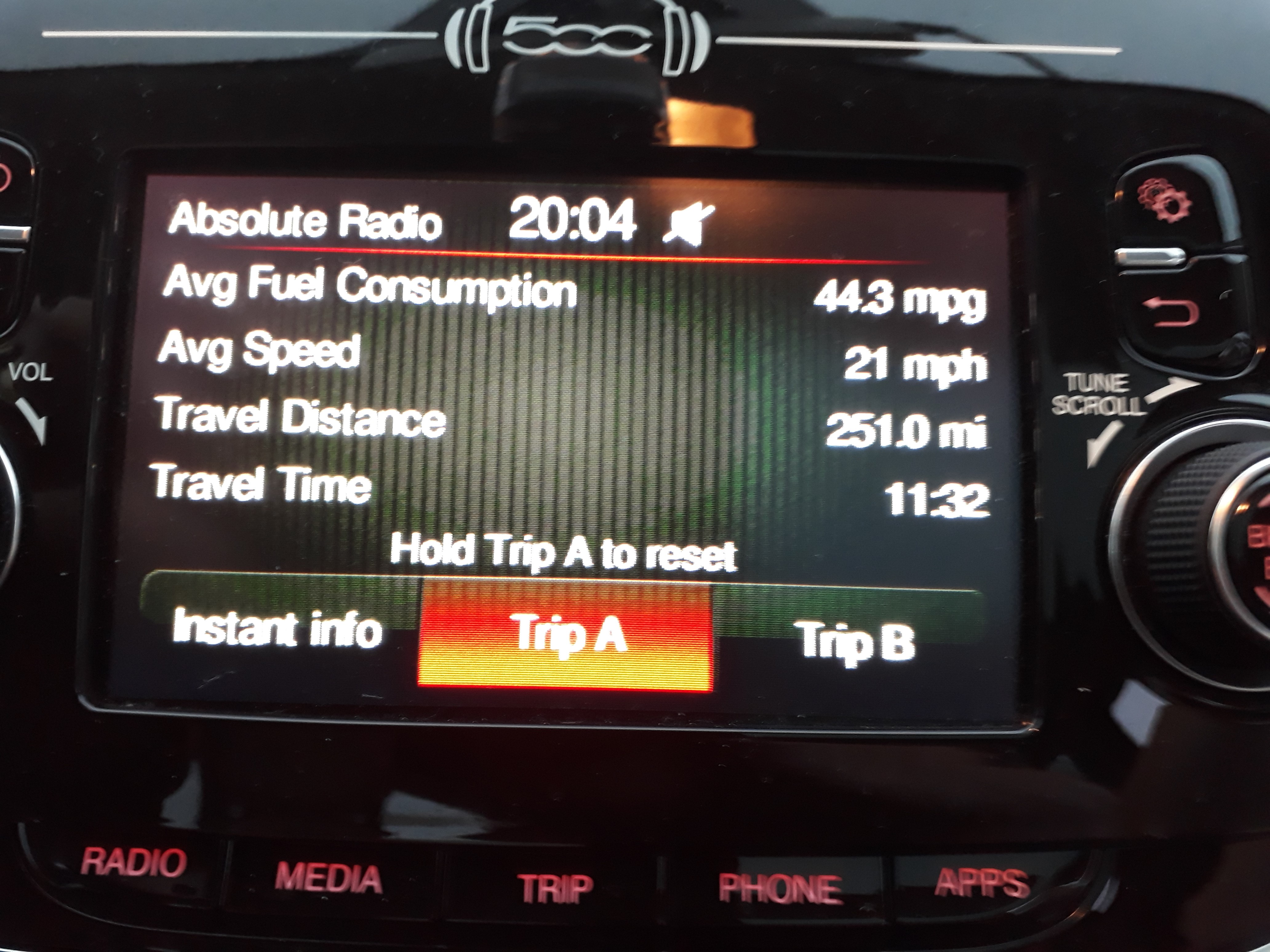

At the risk of trying to bring this thread back on topic to the twinair.....
Mrs Bee changes gear about 2/3 up the rev range and gets this for fuel economy on her commute, which is a similar distance to mine:-
I haven't driven the twinair for a while and thought I would give it a spin on a recent two way commute. Keeping up with traffic, no harsh acceleration or braking, using stop/start when stationary, not driving like a nun and not otherwise deliberately eco driving. I got this:-
Less miles than trip A so statistically less representative, but I wasn't trying and easily got that difference in fuel consumption. In comparison, my 118 BMW had a differential of 37mpg versus 41mpg, so not a wide gulf. We had a similar experience of marginal efficiency differences with the 1.2 500 whenever we swapped.
The twinair fuel economy is way more sensitive to how it is driven.
The same could be said for most downsized engines. The smaller and more heavily boosted it is the more the driving style of a given user matters. You take the old 1.4 for an economy drive and measure it...then razz it and measure it you'll probably get 20% mpg difference in the extreme. Do the same with a TA and you'll easily manage 50% difference because of the design. it has speed or economy not both..you can use one sparingly to get the other on average but it makes them very usage dependent.
