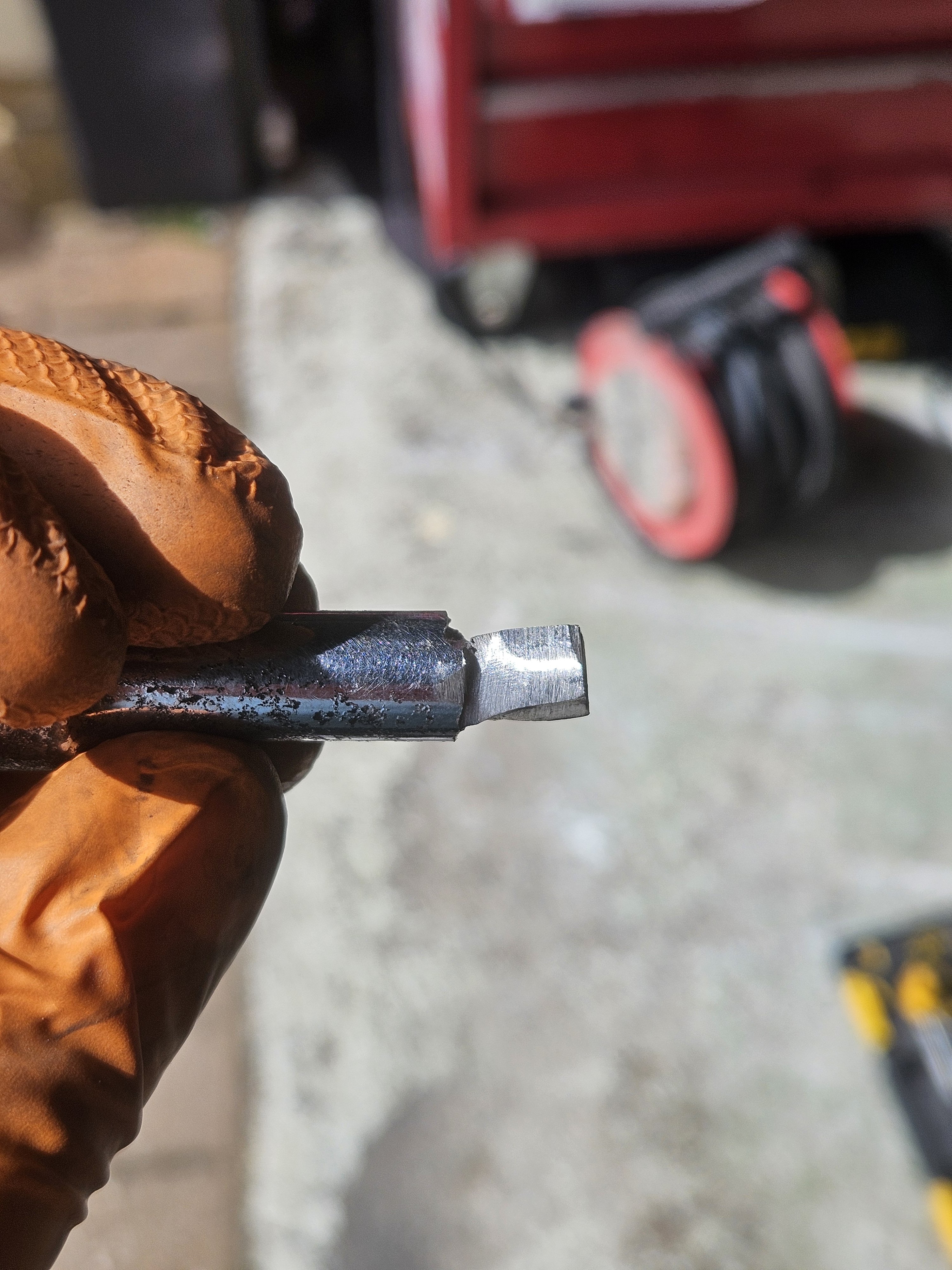

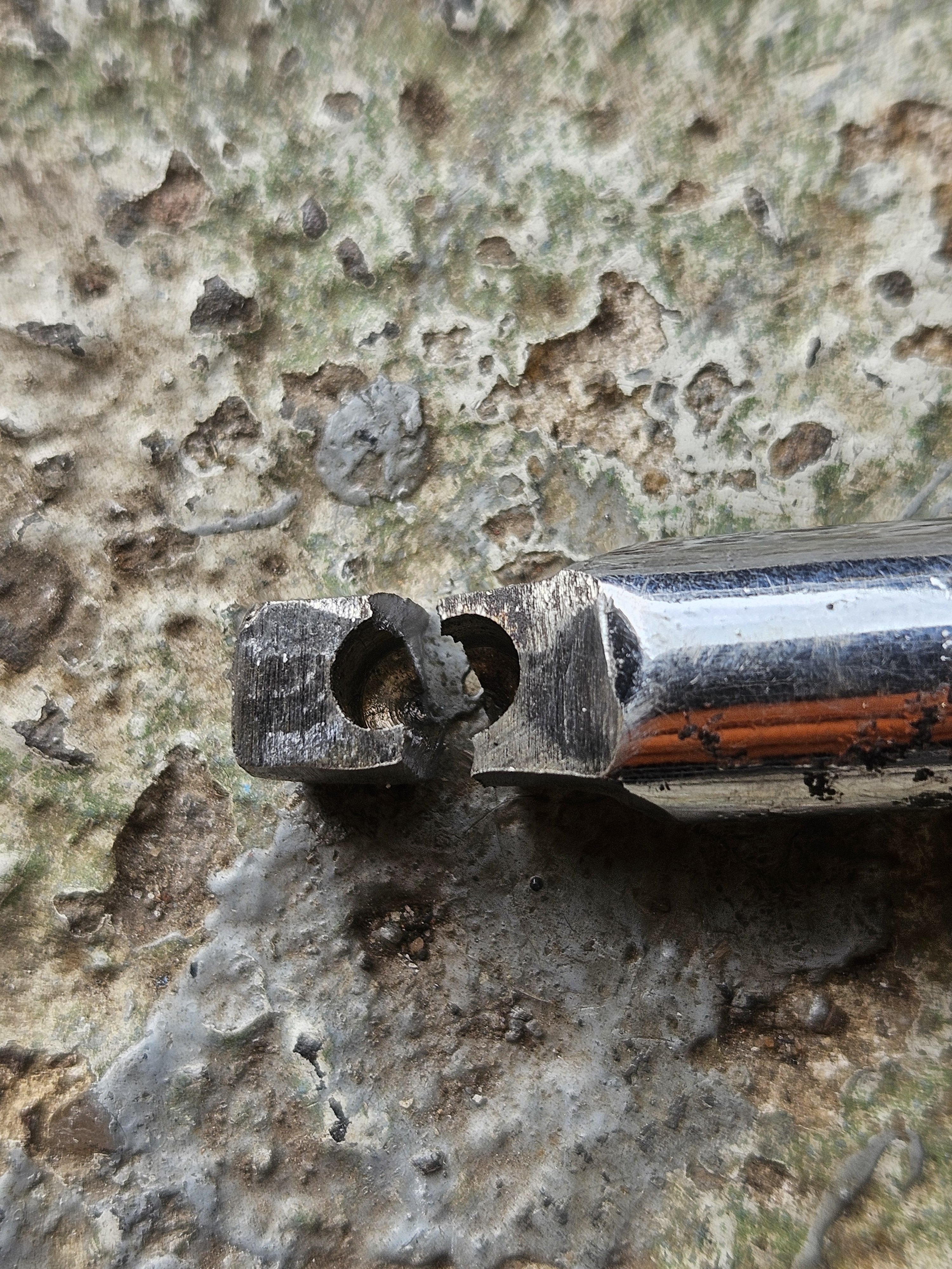

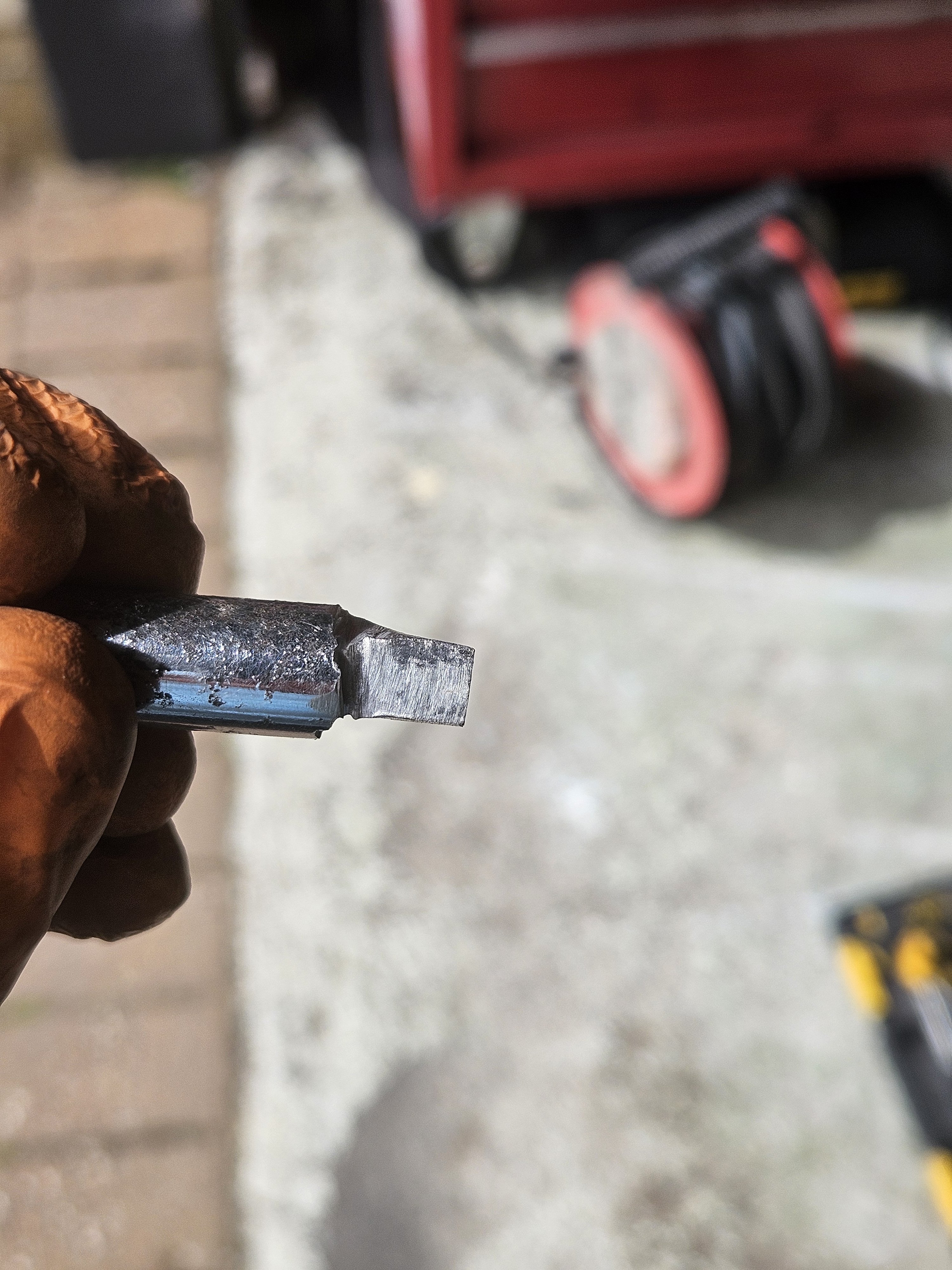

Then I tackled the aux belt. Old one has perished as you can see here. I didn't have the 7mm square bit, ordered a set on Ebay but as it won't be here until next week, I made my own out of an old extension bar ground down. First attempt shattered due to the ball bearing causing a weak point. Ground it down again and finally managed to loosen the tensioner. Looked afterwards and it had twisted my home made tool, but it got the job done at least!
