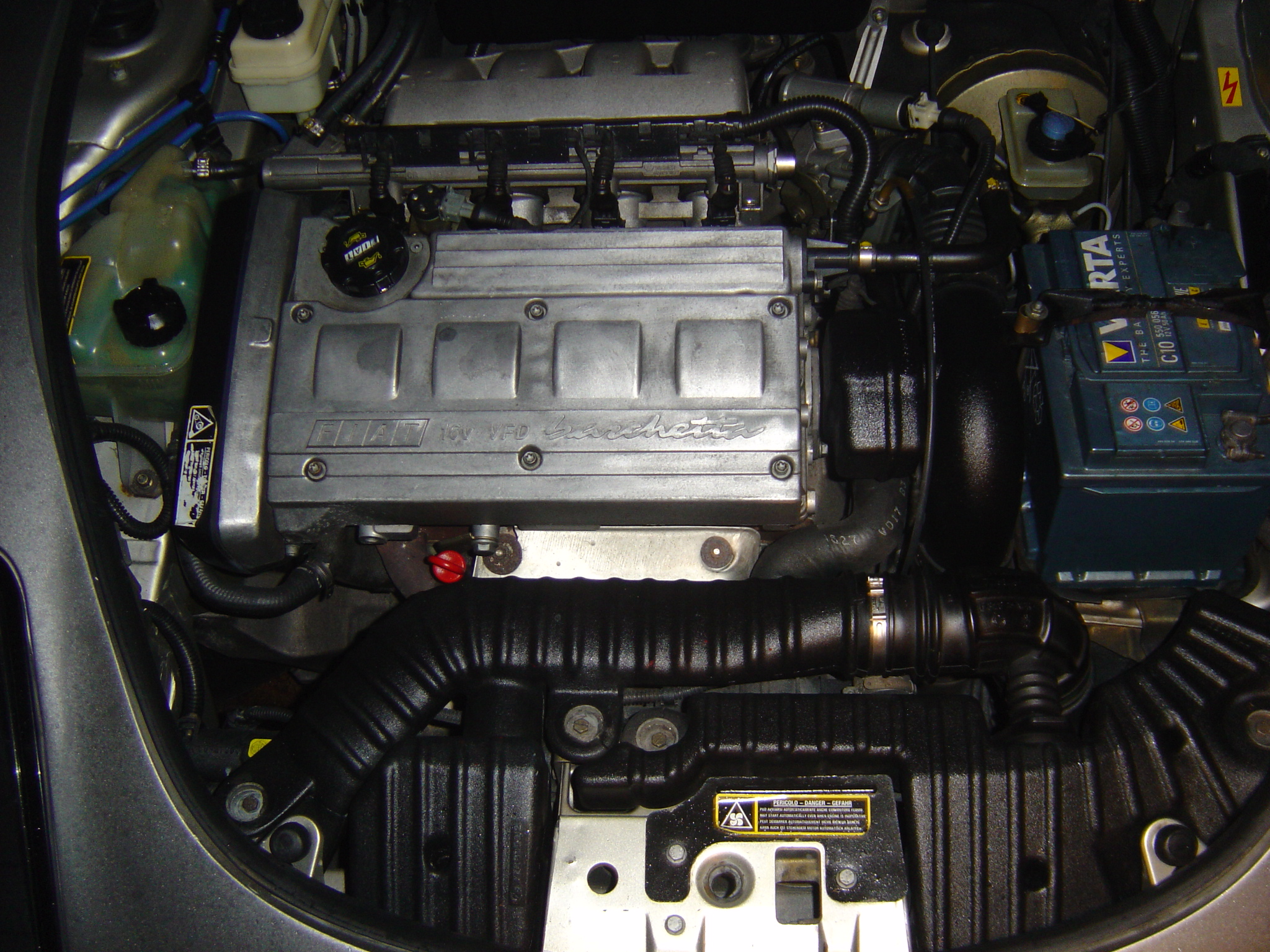

Doubt you need these pics but here you go anyway. Love that blue engine paint. I want it on mine.
thanks nic photo great is your abs unit as big as mine cant quite make it out need new eye.
looking forward to seeing the new cover blue would be good spray dont brush we have all seen how good that looks (n)
have you got lucas brakes too?
No abs in mine. I have the high temperature blue spray ordered. All I need is for the wind and rain to stop.

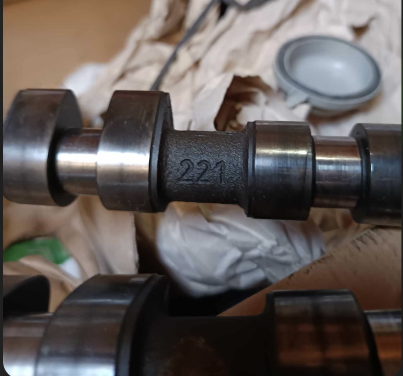

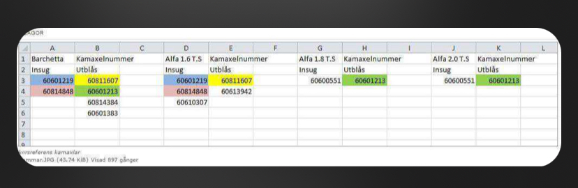

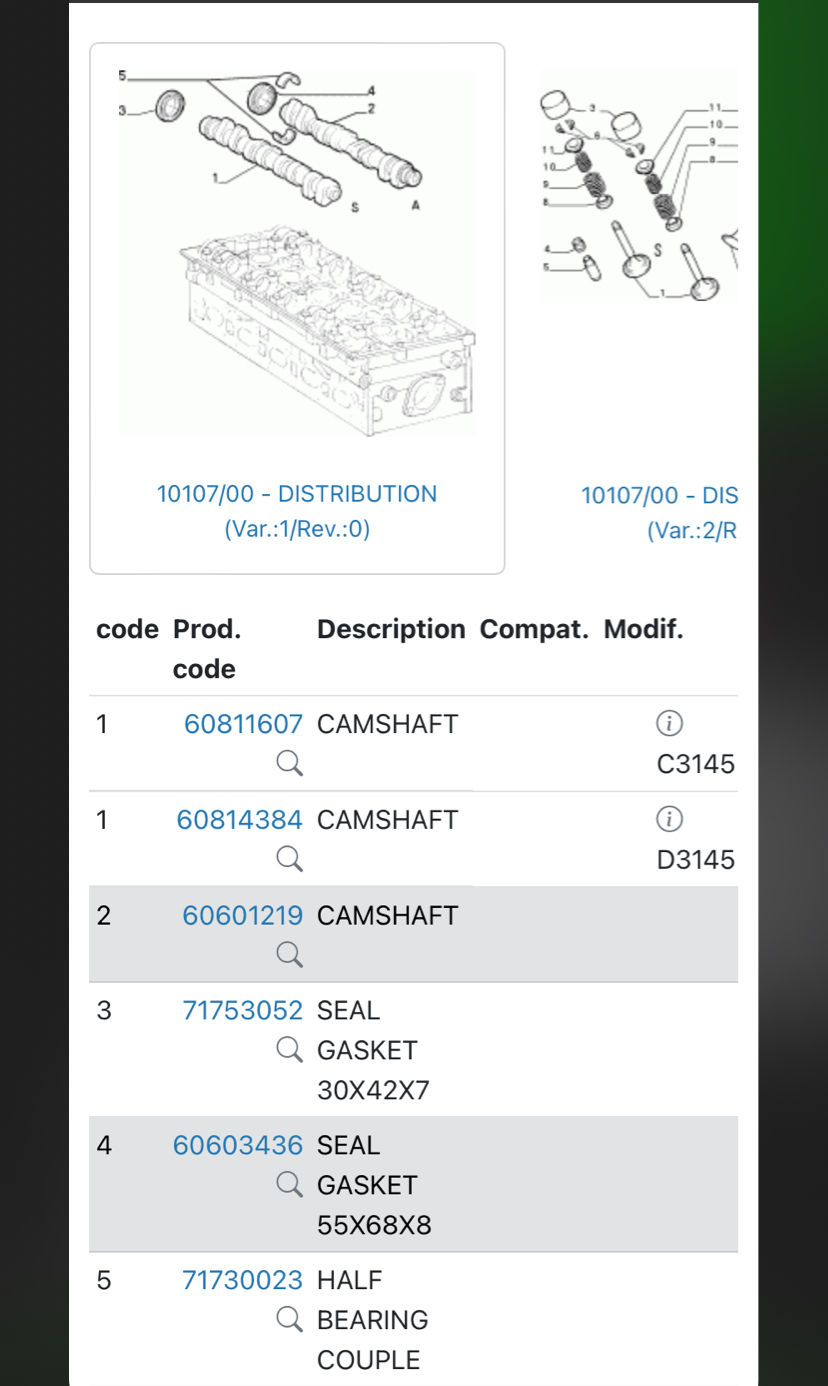

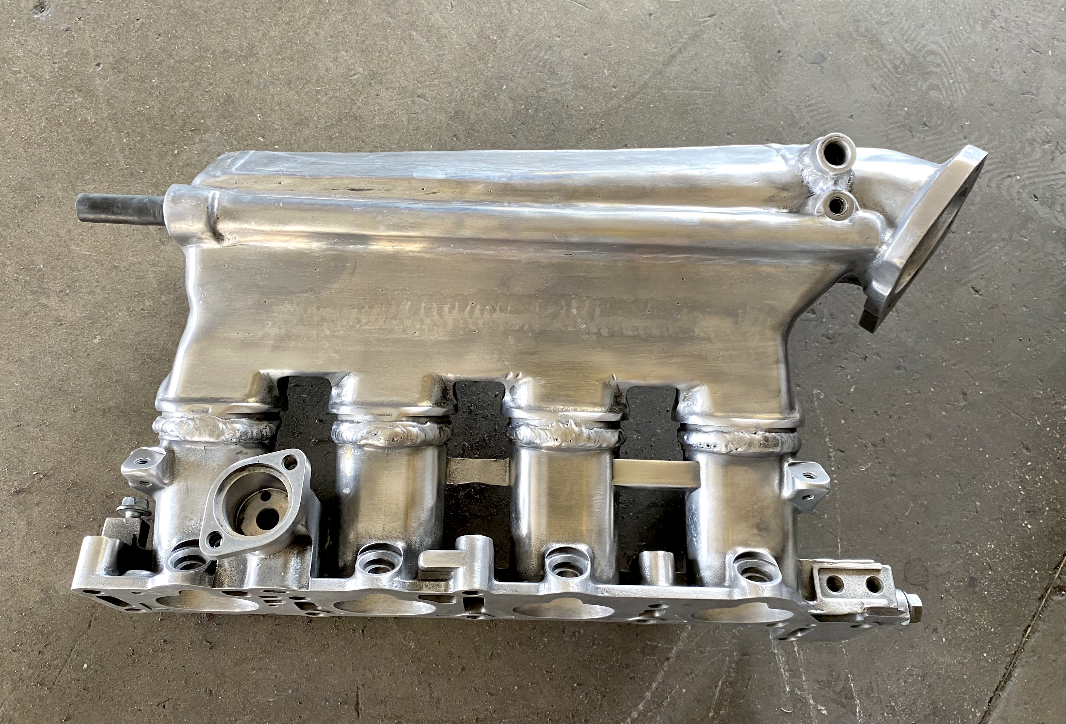

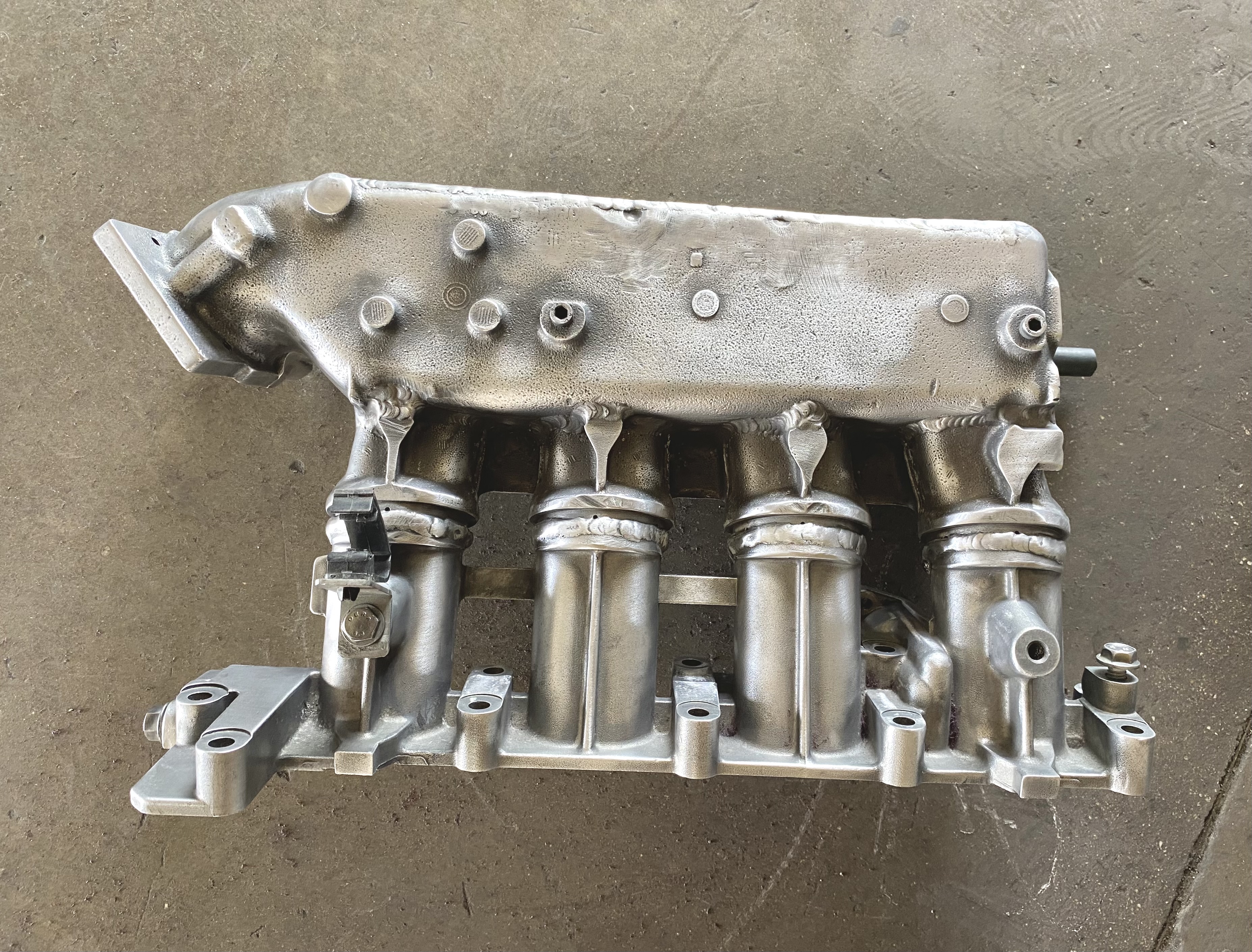

I know this is old thread but now I’m tinkering with the B again have discovered that the first Barchetta’s off the production used the cams from the 2.0 Alfa TS . 1213 and 551 hence maybe the more bhp they had before being de tuned slightly and used slightly lower profile cams

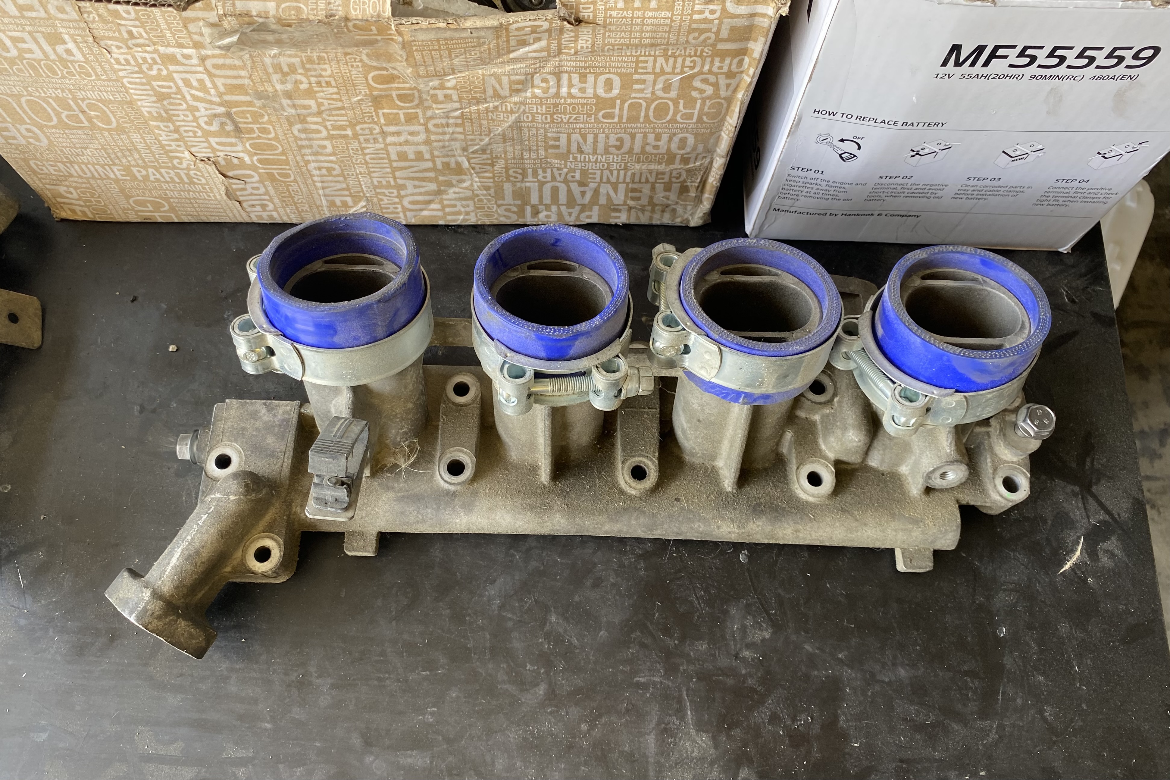

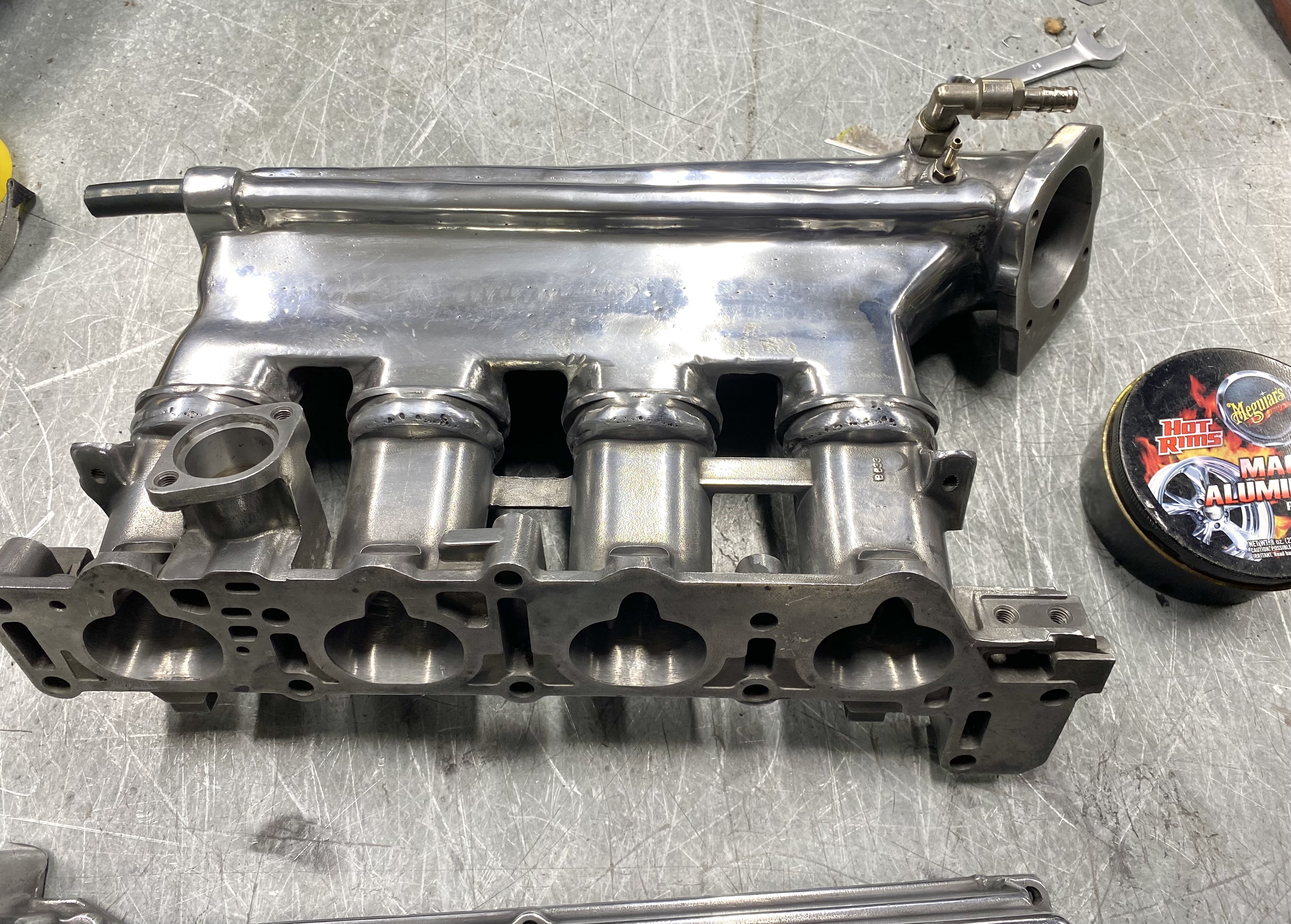

Also as built a performance head from a 97 model , I’ve discovered the metal inlet manifold had been changed modified too.
My early one 95 model had a water pipe that runs through it and the later one not . My nephew says it was to do with the cold idle but here in Cyprus with the heat I don’t need so have done away with it with the new intake system .
You can see the difference in the photos .

after purchasing 2.0 ltr Alfa cams as an upgrade it came to my surprise , I already had the same profile Installed from the beginning.
I have now purchased the 2.0 Alfa JTS cams that have a better exhaust profile .
