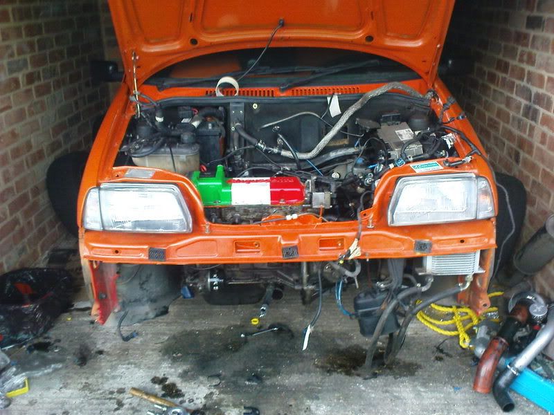

Yeah, Hammerite Smooth is fine all over the engine, apart from the exhaust. I have used it on blocks and sumps, and pandasport painted his 16v cylinder head extension white with the stuff :)
Progress looks good (y) Compressor is the same as mine :D Halfords jobbie?

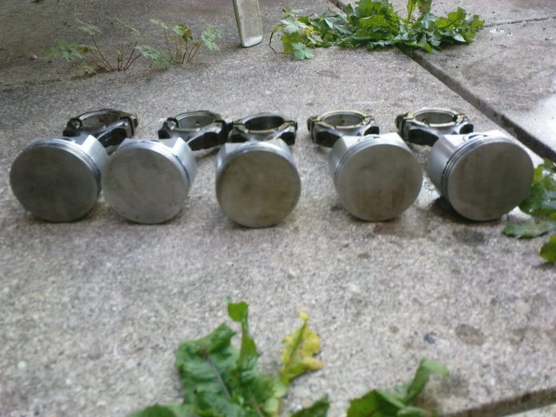

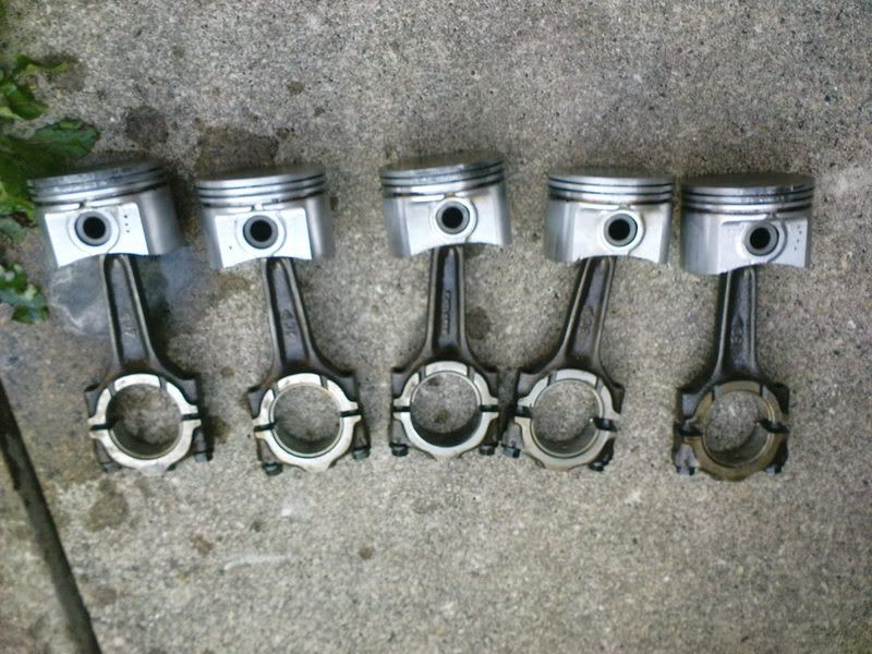

Also just noticed you have a mix of Class A and Class B pistons in your set, which seems a bit odd.
Class B pistons will be slightly larger than Class A pistons.
Think all standard sized pistons take standard rings, but oversized definitely take larger rings. And if your bores WERE class A, a class B piston may be to close at the skirt and wear or seize :eek:

did use etch, just 2pac doesnt seem to like petrol and stuff methinks, had a look at lennys 16v pistons and he has 2 different types the same as me so must just be the way they were *shrugs*

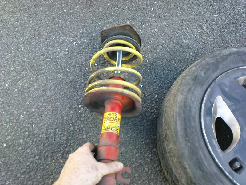

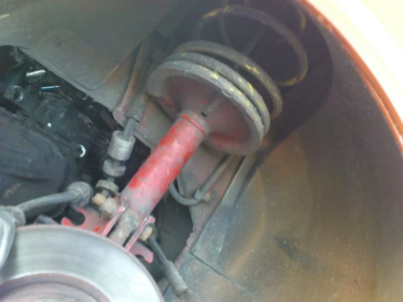

right small update first off suspension! apex shocks and springs all round 40mm drop still
on winter wheels now as am paranoid about damaging the at's classics in any way

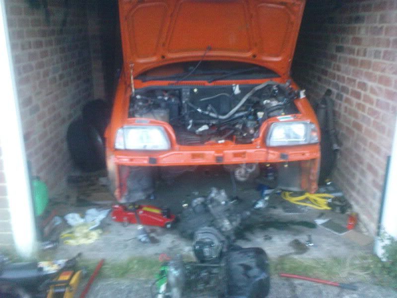

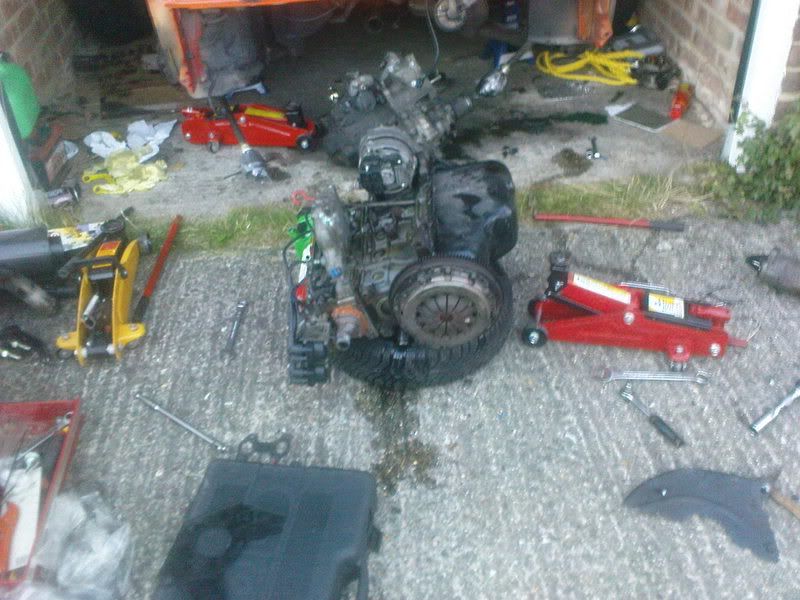

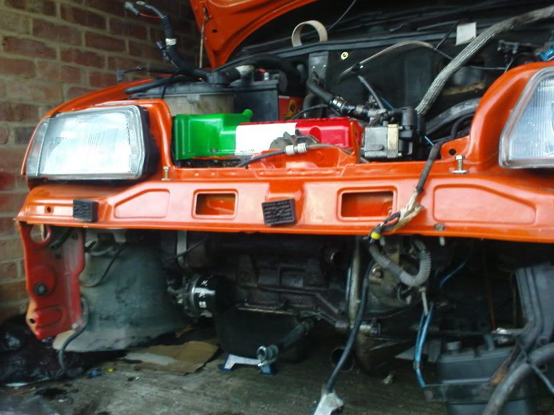

and onto removing the 1108 highboost engine
empty bay again :(
gbox off
turbo gudgens

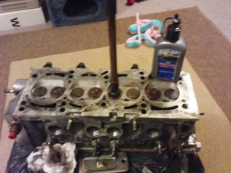

also been rebuilding my head on the 75 engine grinding valves by hand is quite hard work !

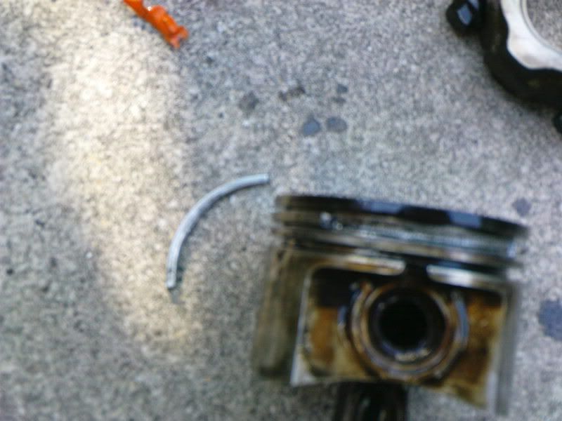

also found out why my 1108 was running permanently rough
part of piston snapped away where rings go not as bad as some of the melted cinq pistons ive seen tho
and finally i have x5 low compression van-aaken pistons if anyone wants these give me a shout as they will be going on ebay with the rest of the stuff i have to clear out!
they should be cut in most of the way, and if needed, lapped. Lapping shouldn't take more than 5 mins per valve though :confused: Took me about 2-3 hours to strip, relap, and rebuild the 16V head
Yep, i seen that before :eek: :eek:. The lands cracked. Was it only on one of the pistons, or all four. If it was just one, whihc piston? Any signs of det around the piston face?
