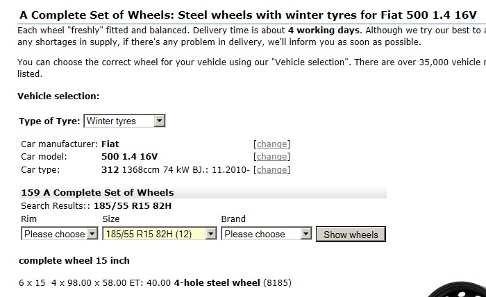

I haven't got the 'old' 500 handbook but I thought it stated E40 for the steel rim and E35 for the alloy in the 15 inch. On the mytyres web site it states E40. Its worth noting that on the current handbook it states that the 15 inch with E35 (the alloy) is not suitable for chains.
