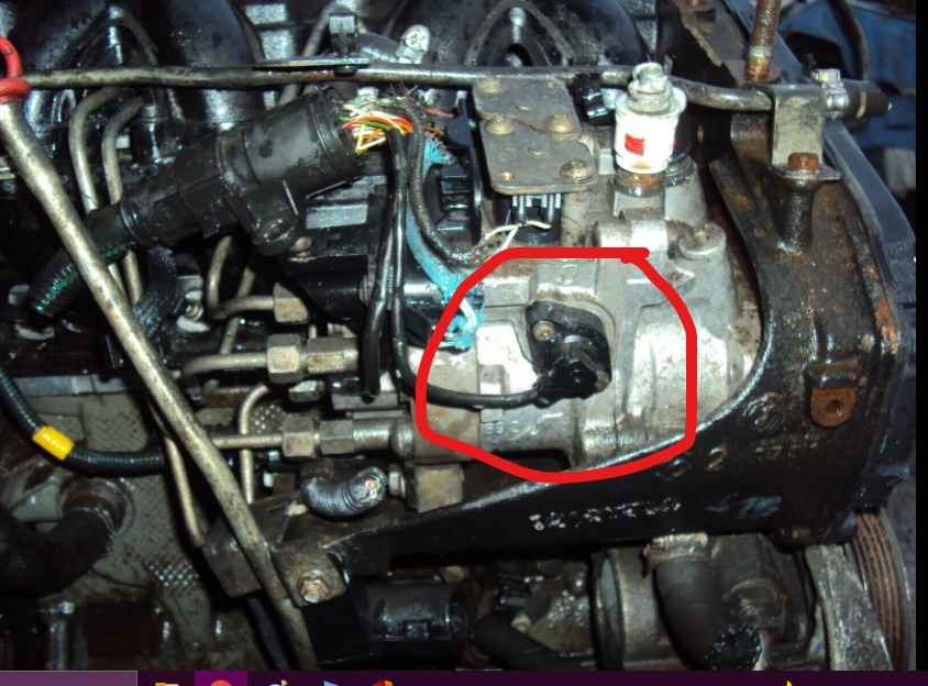

I know this might not help at all as it's a general statement for all cars. It will be located somewhere near the top of the block, on the head, on the intake manifold ususally near the timing cover. Saying that, I've just come across this picture of your engine type. Could this be the sensor location? Looks right, top of the engine, near timing cover.

Thanks a lot guys! I did not expect so many and fast answers :)
I will take the advice to see if the replacement of the crankshaft sensor will cure the problem before I do anything more. Also thank´s for the picture on the sensor which I have now located as some kind of rotor sensor for the injection pump...but it was the closest this far..! :)
If Your engine has that type of injection pump it does not need a cam shaft sensor .
Ok, that explains the problem finding the sensor! Yesterday I took a ride with some stops and the car started every time! So if I´m lucky it was the crankshaft sensor that caused the problem, the next days will tell.
