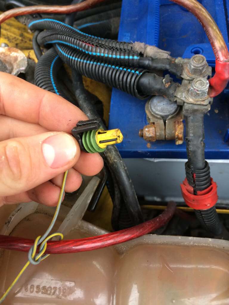

mati6565 New member Joined Apr 25, 2015 Messages 43 Points 10 Mar 24, 2016 #1 Anyone knows where should I connect that ? Where does it lead it to?
cc1 Patron member Joined Feb 3, 2006 Messages 2,661 Points 476 Location Nottingham Mar 24, 2016 #2 Oil pressure switch.
g8rpi Moderator Staff member Parked in the garage Written a guide Uploaded a resource/download Joined Nov 11, 2013 Messages 4,644 Points 1,330 Location Cambridge Mar 24, 2016 #3 That's worrying, It looks like it was deliberately tied back. So either it's just a faulty switch or the engine has low oil pressure Robert G8RPI.
