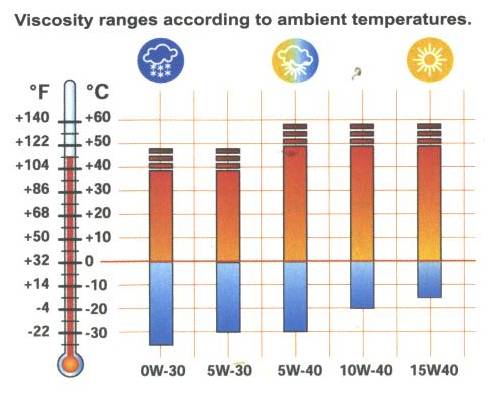

But what is the correct oil?
Fiat say 0w30 for the Ducato
But then they have to give a grade for worldwide use
And we live on an island surrounded by water warmed by the gulf stream so never get those extremes of temperature
The handbook with my Citroen Relay (X2/50) included a chart which says 5w40 (which I am using) is OK down to minus 30C
I have scanned the chart in the handbook and attach it here
