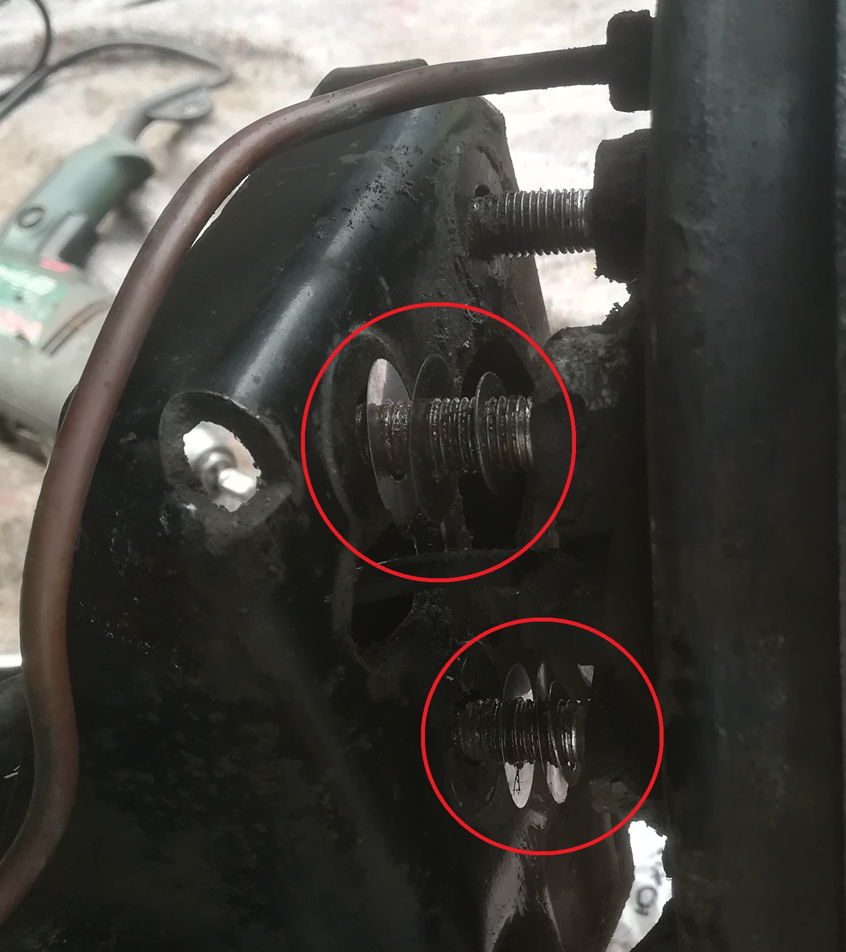

I did shim my rear hubs (more here) to get rid of excessive tyre wear.

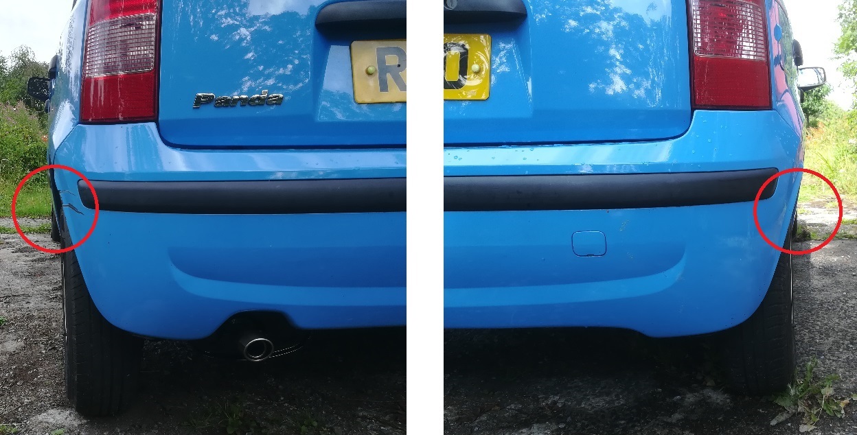

I could clearly see from the back of the car my left rear had much more toe-in than the right. My left tyre showed the distinctive 'feathering' on the outer shoulder consistent with too much toe-in.

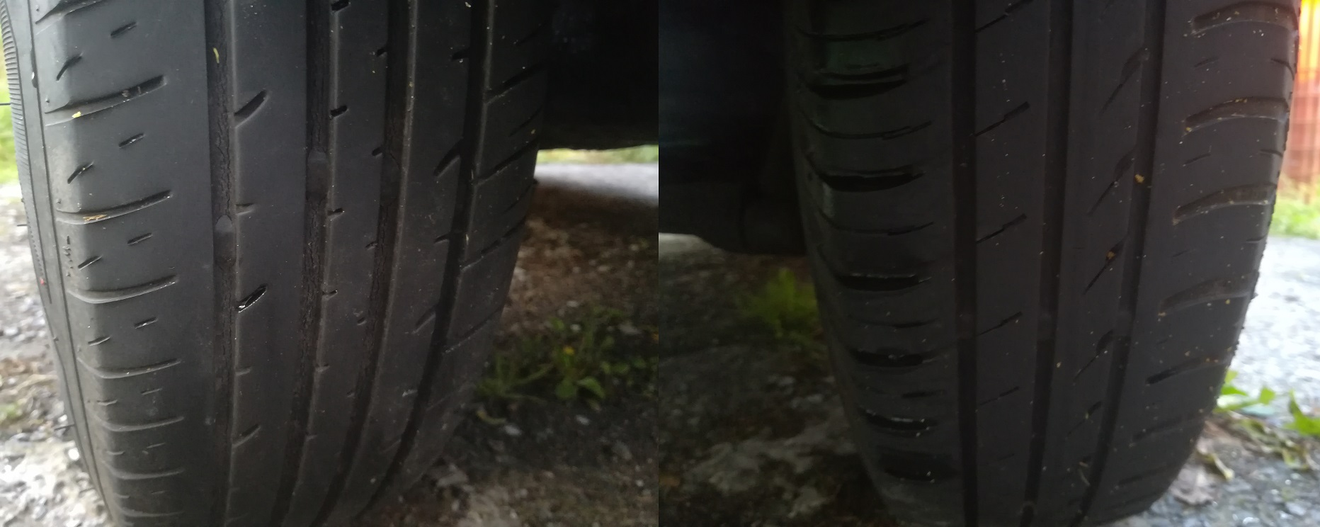

What is the pattern of your tyre wear? I agree it would be good to take more measurements before adjusting anything.
looking from the back
the left tyre looks old and cracked ? But the wear looks normal. The outer edge will slightly wear more with the built in positive toe and lean when pushing hard.
right is more concerning but hard to see in the photos.
