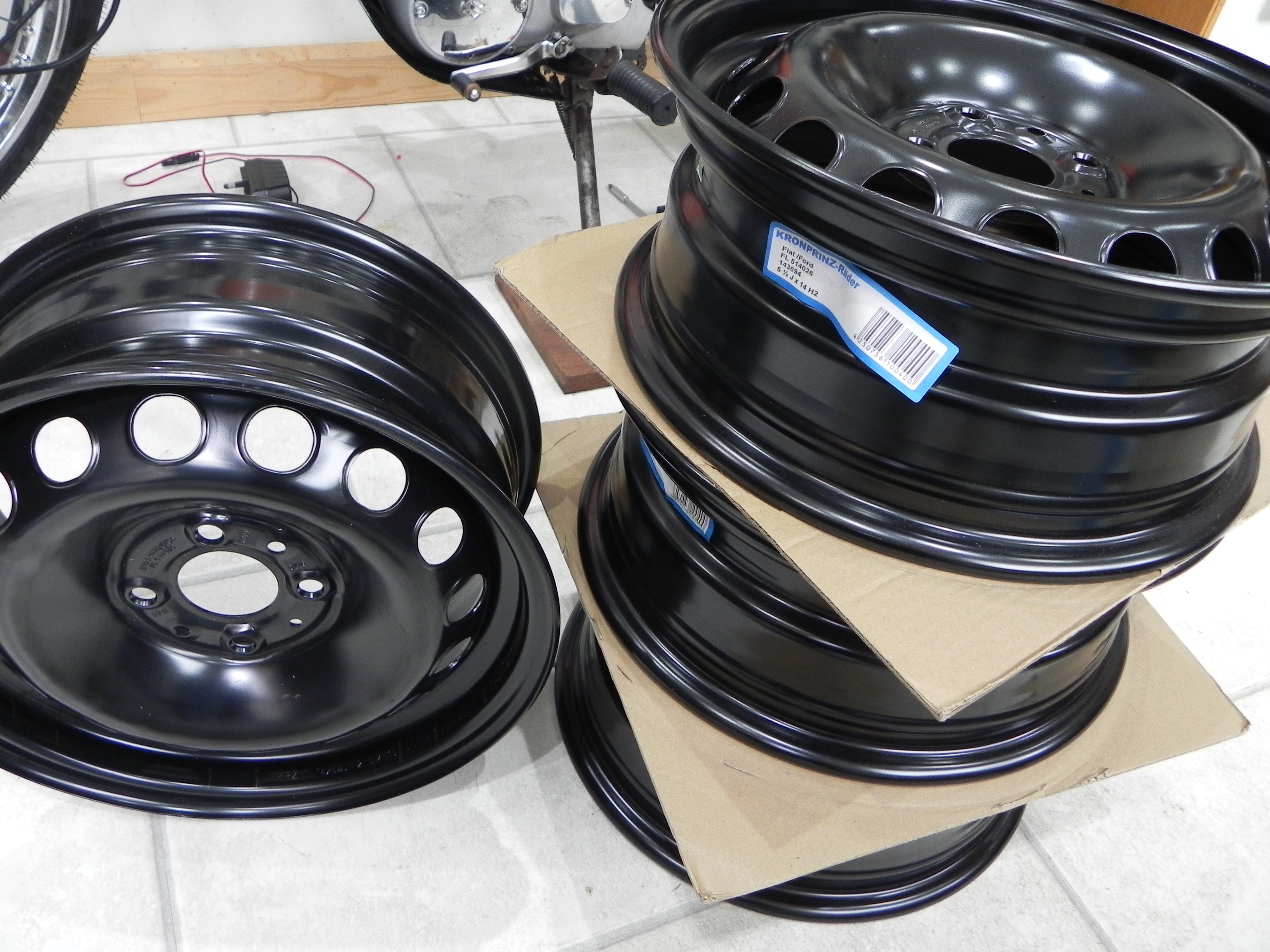

Hi all, what does ET35 or ET38 signify? Is it the offset?
I'm just checking wheel/tyre sizes for 500's and Pandas. The wife's 500C is on 16's with some newish 195/45 Potenzas. Sadly, the alloys are a bit scuffed so I'm wanting to get them refinished/powder coated. I plan to buy a set of 14" steels and have 165/65's fitted. Once the alloys have been done they can go back on the 500 and the 14's can go onto a Panda I've just bought. This is a lovely little car, 59plate with only 21,000 miles and presently sat on some 13" steels with 155/80's. The PCD's are all 4x98 on the 13's 14's and 16's. The parts man at the local Fiat tells me 14's will fit onto the 500C. The only differences I can see on the website I've looked at are the above mentioned ET numbers.

Could someone tell me if 165/65's or 175/65's are preferable, please?
According to Blackcircles' excellent guide, the 155/80/13's the Panda is now on have a standing height of 22.76"
175/65/14's are 22.89" and the 165/65/14's are 22.44"
edit: handbook says 165's :)
Cheers.
