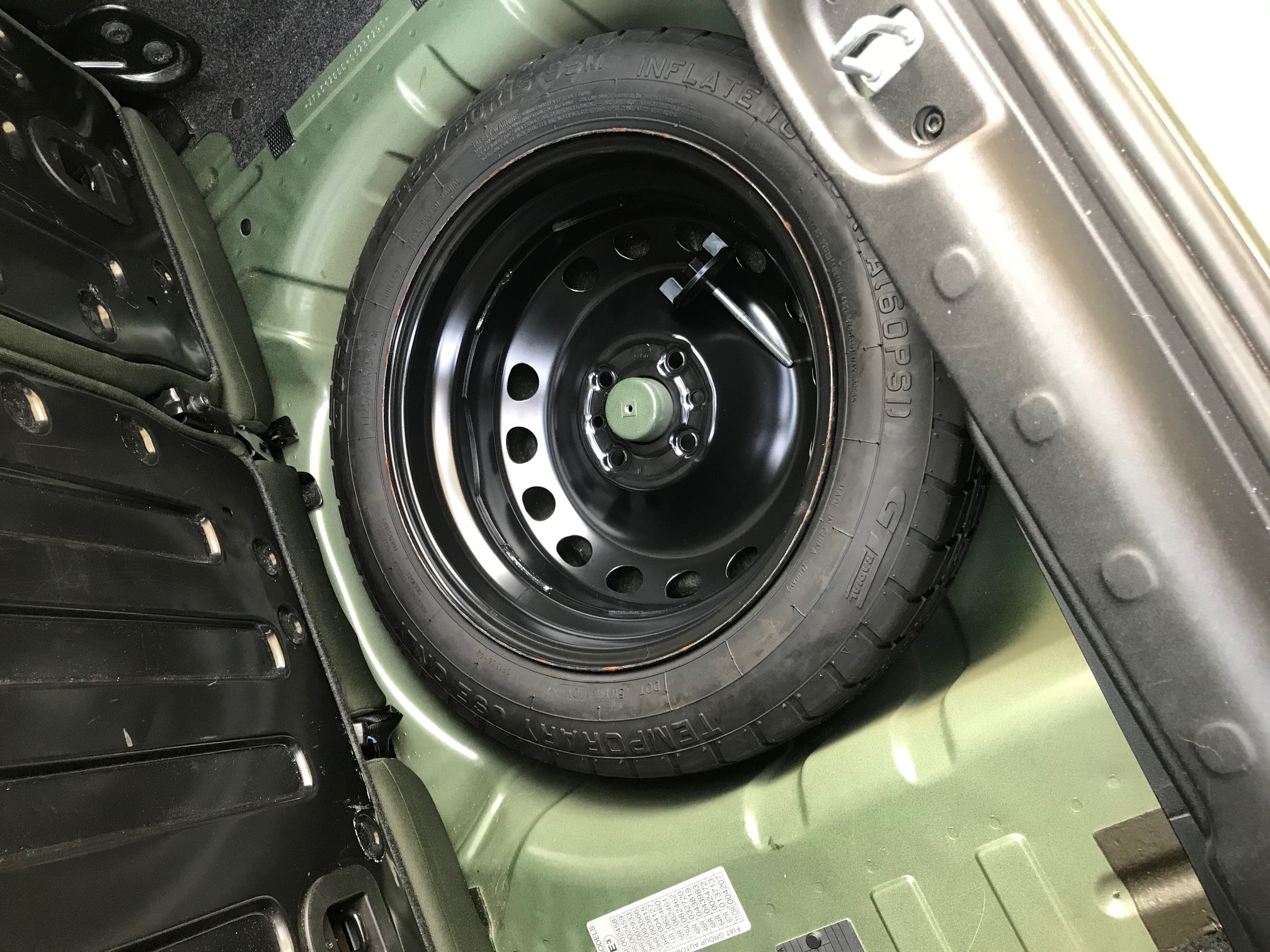

As per the title; all comments would be very welcome...
I was staring into space - that is, the boot-space of my 2014 Panda yesterday (as you do), and I noticed that the space-saving wheel is all wrong... It doesn't save any space at all. On the contrary, it actually takes up space!
With the spare wheel held in by it's screw-down clamp (that has an unnecessarly long thread!) I noticed there is a lot of wasted space below the wheel. There's not much space in the boot of a Panda anyway so I had an idea...
:idea:
Why not turn the wheel over? That way it could then be filled with a whole load of stuff - tools, spares, and other bits and bobs etc
(Yes I realise the screw-down clamp would now no longer do anything, but it wouldn't be difficult to make up a suitable spacer in order to keep it utilised.
What beggars the question however, is why did FIAT design the spare wheel to fit in this way?
Does fitting it in like that create some extra strength to the boot floor or am I missing something? It just seems so (obviously) wrong!

Ah - ok - thanks for that excellent link Eklipze3k - now it all makes good sense (y)
I have all the tools but they're in a bag in the boot - goodness knows what happened to the original round thing for the tools to sit in. :confused:
It's a good job I didnt get round to cutting the threads down on the screw-down clamp! :eek::D

My SAAB had a stupid space-saving wheel that I was dreading ever having to use, but luckily I found that a full-sized wheel could fit - so a money saving excercise rather than space saving; I duly acquired a proper spare wheel.
My neighbour's Peugeot Cabrio came with the next-to-useless 'tin of glue' - she threw that away and bought a s/h space-saver wheel and tools for next to nothing off eBay.
As for the round thing that the tools sat in, having re-read Eklipze3k's linked thread it now seems that the 4x4 doesn't have one, but rather a bag that the tools are in - which is exactly what I have, and they're still in their individual polythene sealed bags so have clearly never even been used.
That thread also talks about the jack for the 4x4 being larger than standard Panda jacks, so perhaps my original question about space-saving wheels not actually saving any space might have an unintentional ounce of truth in it! A little more investigation required on my part I think - I'll need to ensure that the jack will in fact lift the car high enough to remove a wheel and investigate turning the space-saver wheel over to utilise and create storage space.
You don’t get one with the 4x4. The standard Panda jack won’t lift a 4x4 high enough, so it has a 4x4 specific jack. This 4x4 jack is too big to fit in the plastic rubbish fitted to lesser Pandas, and so the tools are in a bag designed to Velcro under the front seat. (y)
As stated in an earlier post, I have indeed got the bag - I've just got to get round to checking the jack is the correct one, and that it will in fact lift the car high enough to get the wheel(s) off

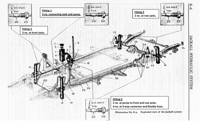

It's a pity cars aren't built with a Smiths Jackall type system anymore!
I think a similar system, but a pneumatic one, is used on race touring cars
