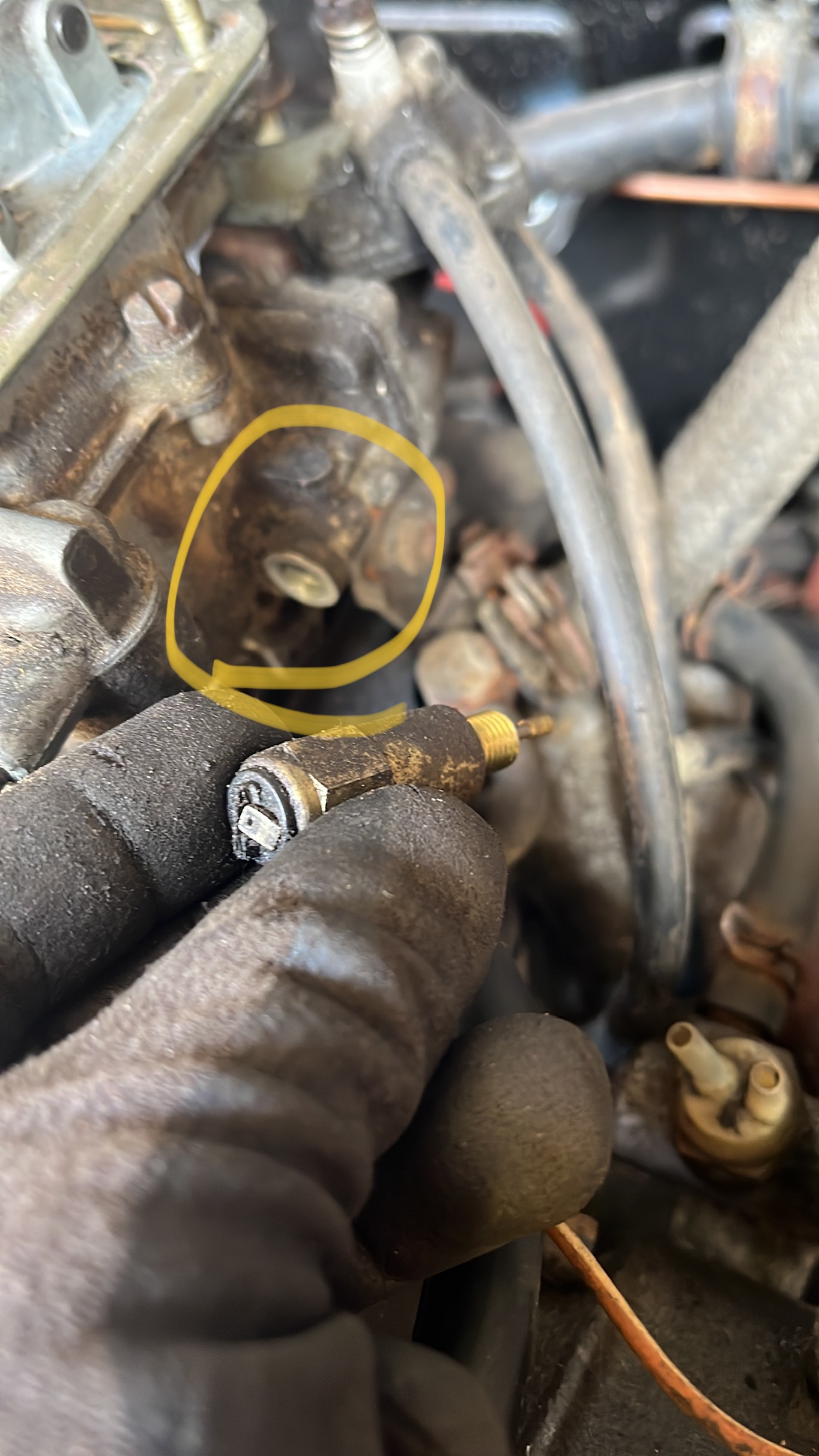

D Dalleb1001 New member Joined Apr 20, 2020 Messages 34 Points 14 May 18, 2022 #1 Hello, what is this sensor for and is it really needed? It broke doing assembling. The needle can easily be moved Thanks in advance Attachments 592DA7FF-4804-40E3-BD1B-878B8BC7435C.jpeg 503.7 KB · Views: 184
J4MALD1N Member Parked in the garage Joined Sep 21, 2019 Messages 95 Points 113 Location London May 18, 2022 #2 Looks like a coolant sensor given that it has one connector and is brass. Would be useful to know what engine and year your vehicle is to confirm this. Correction: It is a solenoid of some sorts. Have found a supplier selling something similar. Solenoids Weber 30/32 DMTENuova Ritmo 70/Uno 70 autostoria abarth , alfa romeo , fiat , lancia spare parts specialist , more than 20000 articles in stock and for over 20 years in the market www.autostoria.com Last edited: May 18, 2022
s130 Moderator Staff member Parked in the garage Written a guide Uploaded a resource/download Written a review Joined Dec 5, 2006 Messages 6,582 Points 1,712 Location Wrexham, North Wales May 18, 2022 #3 Looks like a fuel overrun shutoff solenoid. (cuts fuel into the carb progression holes when car is decelerating with no throttle pedal depression). However knowing the exact car model, year and engine cc would help
