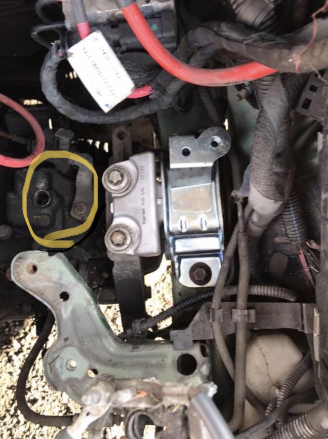

D Daniam79 New member Joined Jan 31, 2020 Messages 4 Points 2 Jan 31, 2020 #1 Hi all new here hope your all well, was changing the engine mounts on the gp and noticed it looks like something is missing, any one any ideas as to what lol?* Thanks in advance Attachments BA5D536F-3234-4FDF-BB0B-BC0F1C9738E2.jpeg 182.3 KB · Views: 84
Bernievarian Prominent member Joined Jan 15, 2017 Messages 2,993 Points 655 Feb 1, 2020 #2 Gearbox breather ?

OP OP D Daniam79 New member Joined Jan 31, 2020 Messages 4 Points 2 Feb 1, 2020 #4 Sorry 1.2 8v 2007,and looking at your pics deffo something missing lol but what ??

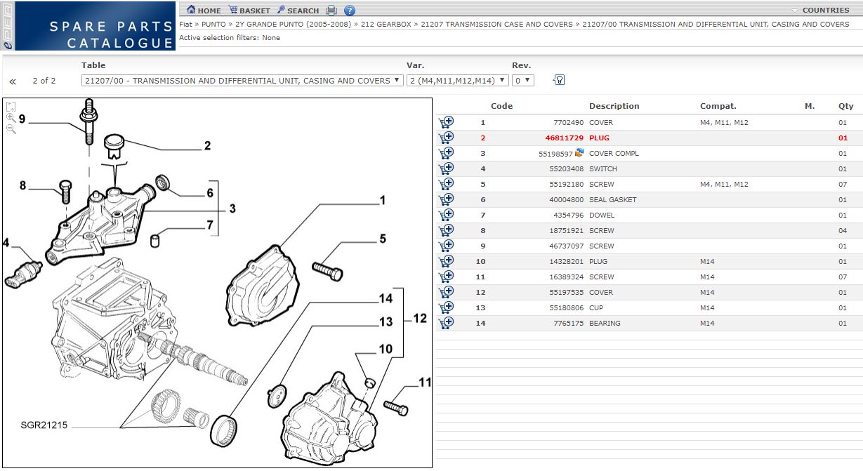

Davren Moderator Staff member Uploaded 10+ resources/downloads Joined Jul 6, 2008 Messages 16,421 Points 3,884 Location London, UK. Feb 1, 2020 #5 Daniam79 said: deffo something missing lol but what ?? Click to expand... As Bernievarian says above, gearbox breather plug. . Attachments GP Gearbox Breather Plug.JPG 137 KB · Views: 57
OP OP D Daniam79 New member Joined Jan 31, 2020 Messages 4 Points 2 Feb 1, 2020 #6 Great, thanks for the help everyone
