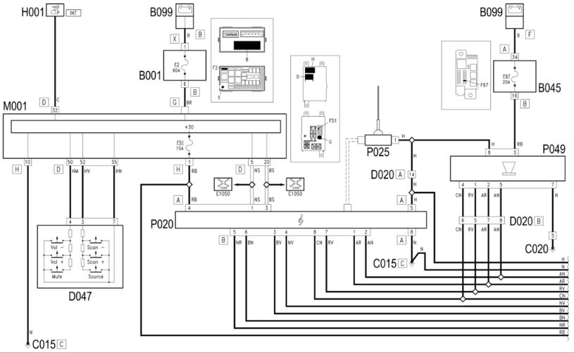

I trawled through eLearn (http://4cardata.info/elearn/199/2/199000000/199000000/199000000/199003749) and the only thing I could find was this:
If I'm reading this diagram correctly the part in question appears to be D020(B). Unfortunately the diagram has no legend so I don't know what D020(B) is. Moreover, the diagram doesn't clarify whether this part is trim dependent.
If someone can confirm what the part is, that would be much appreciated.

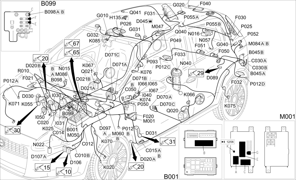

But anyway, not sure if it is of any help, but I found these wiring diagrams whilst perusing eLearn. Do you have a 3 or 5 door model?
3 door - http://4cardata.info/elearn/199/2/199000000/199000001/199000000/199003759
5 door - http://4cardata.info/elearn/199/2/199000000/199000001/199000000/199003769
The interia switch is I050, and D020B is nearby with a label showing a plug. There seems to be a few variations. This one looks a bit like yours, but hard to tell from the picture. Also D030 - Driver's Front Door Coupling.
It might also help to know what that plug looks like, how many pins it has, and the colour of the wires attached to it as the more detailed wiring diagrams list the wire colours which might help.
P.S. Might be worth having a look on the passenger side and seeing if there's a similar connector there (maybe D020A)?

Thank you for the detailed post. This car is a 5-door RHD.
There are no pending or historic faults being reported but there is one logged fault, U1706. Engine Management Light is off.
The passenger side does indeed have D020A connected.
The plug on the driver side is pictured in my initial post. It's fairly small with 2 pins inside.

As kindly requested by Charlie ...
P020: on board radio
P026: dashboard (Blue&Me) microphone
P049: rear center woofer
P070: Interscope amplifier
Definitely trim dependent and NOT related to any door gremlin ...

Apologies for not closing off this thread sooner. Thanks to all who helped me establish that the connector is for Blue & Me and therefore trim dependent.
