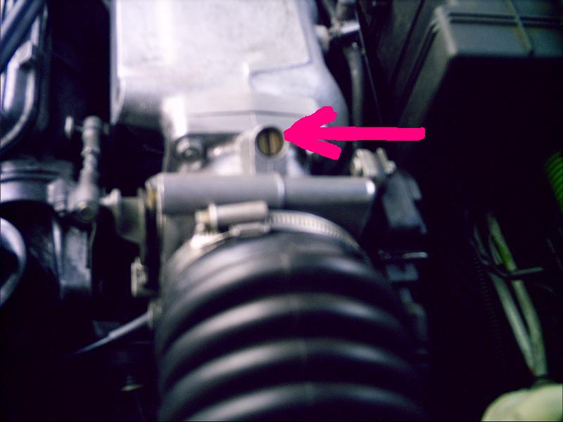

What is this screw for and what is the correct adjustment of it please (On top of the throttle body).....
Just a simple idle speed screw. This needs to be set correctly as the ecu wont control the idle speed as such, it can only "idle up" for cold start, A/C etc.
Idle adjuster screw.
To set it you'll probably need an emmisions tester or similar.
There might be instructions in a Haynes on how to set it up yourself e.g Run car to a certain temp then adjust until x happens. You might need a external Rev Counter. I forget what they are really called, brain not working, no breakfast!
Way ive set these up in the past, is to give it a basic idle setting, then take the car for a run using all the gears, stop and stopping. If the engine stalls, give it a quarter turn. run again and adjust if needed until the idle is nice and even when hot.
