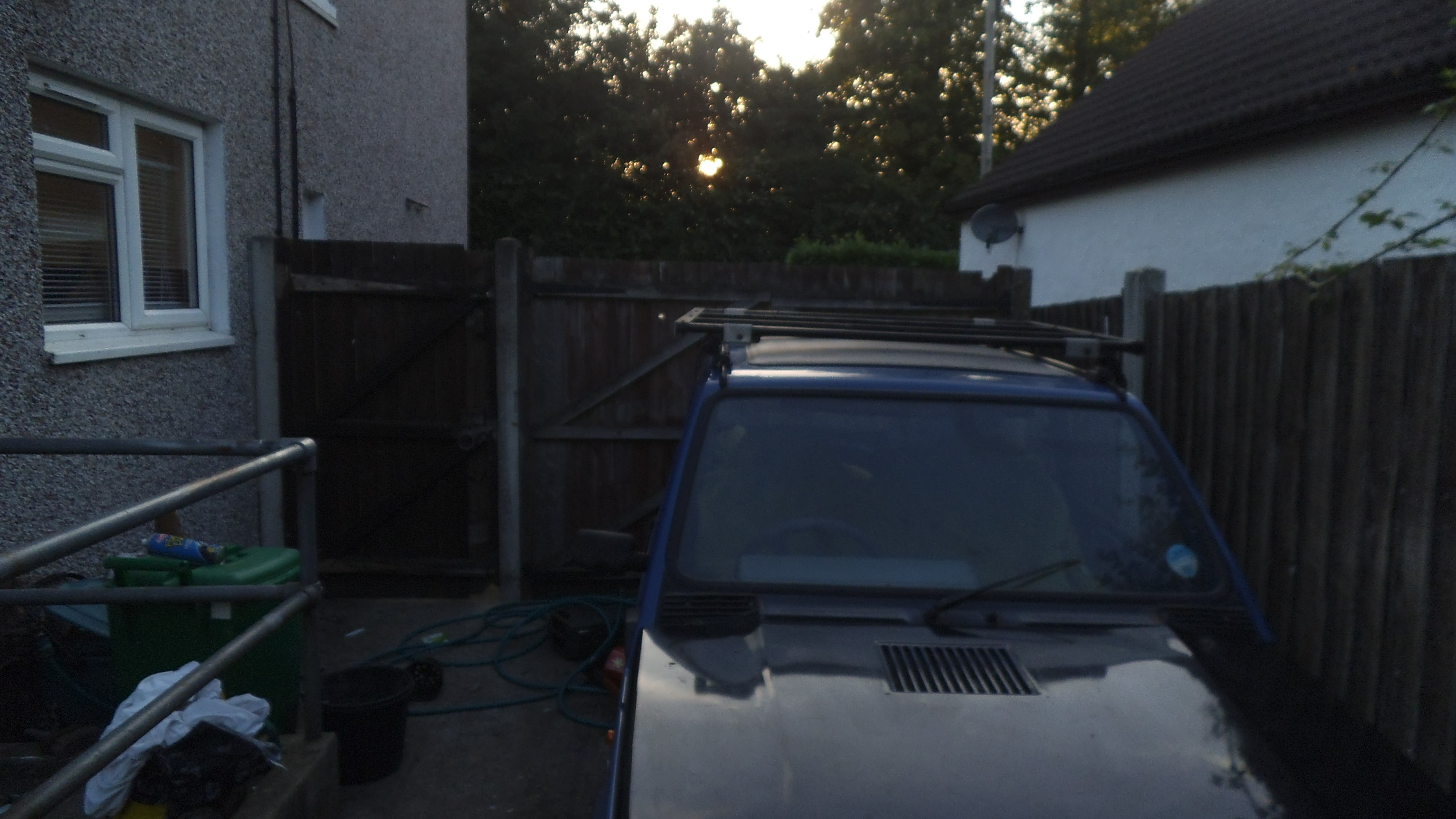

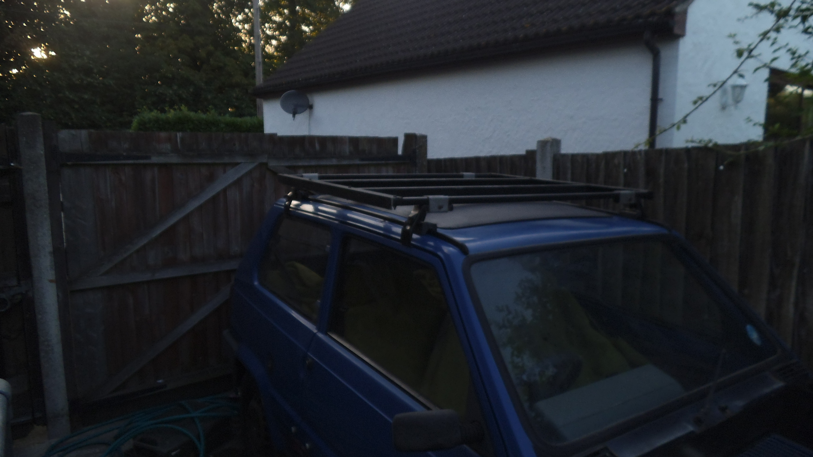

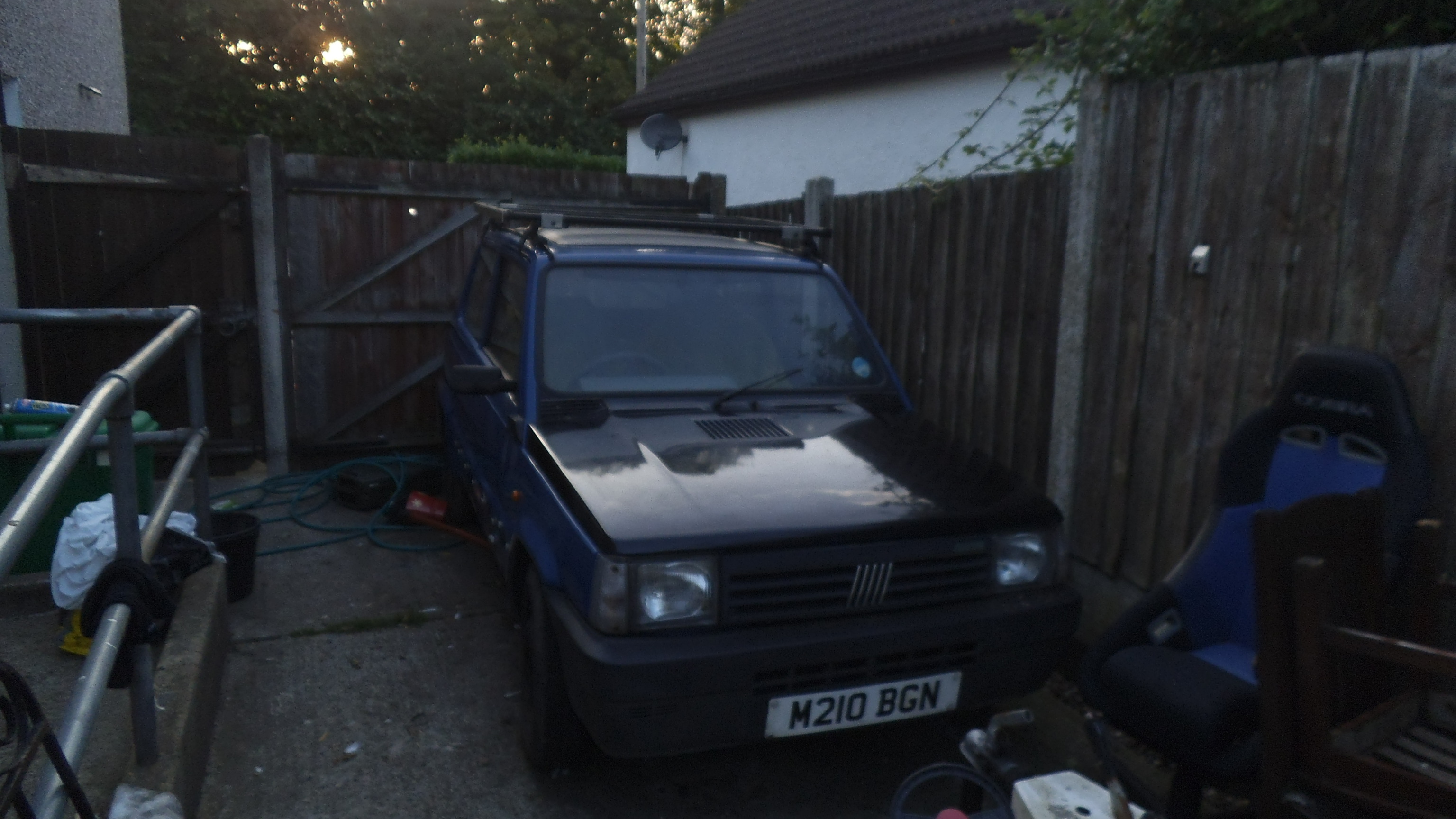

So I asked my dad a while back if the roof rack in his garage was off his old panda, he couldn't remember.
Seems to be a home made affair from just 2 bars and angle alloy, the feet looked very much panda.
So i tried it on Ivor for fit and it fits. not sure if i like it or if its even legal it is wider than the roof but not wider than the wing mirrors.
