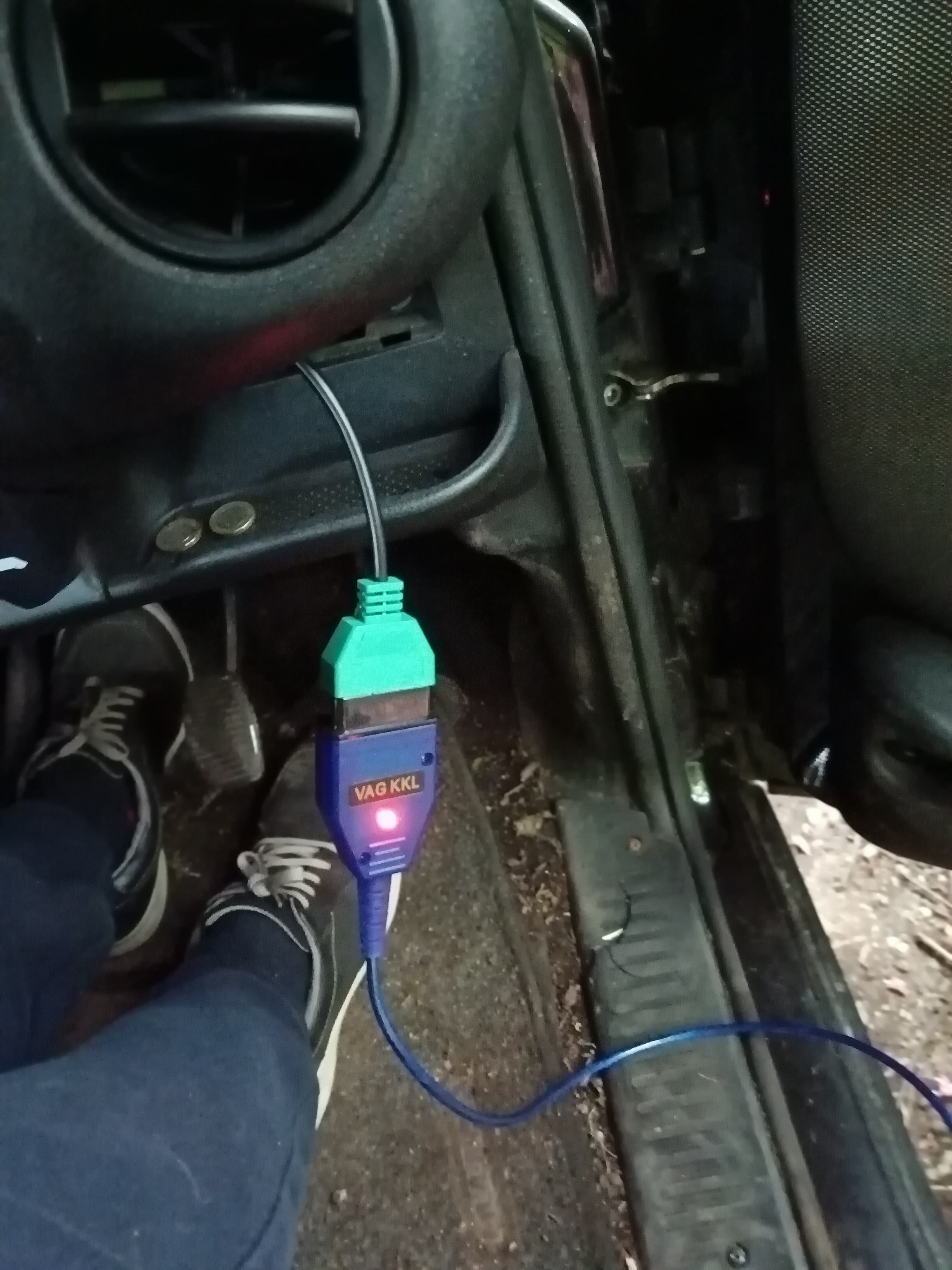

Yes, indeed it did need that combination.. (But it put up quite a fight)
I have not used KKL for ages, and not sure I've Ever used the Green Adaptor
BUT.. Did eventually get it to converse
HOMEPAGE suggestS KKL and ELM for most relevant applications..
But wouldn't connect.. Or throw errors

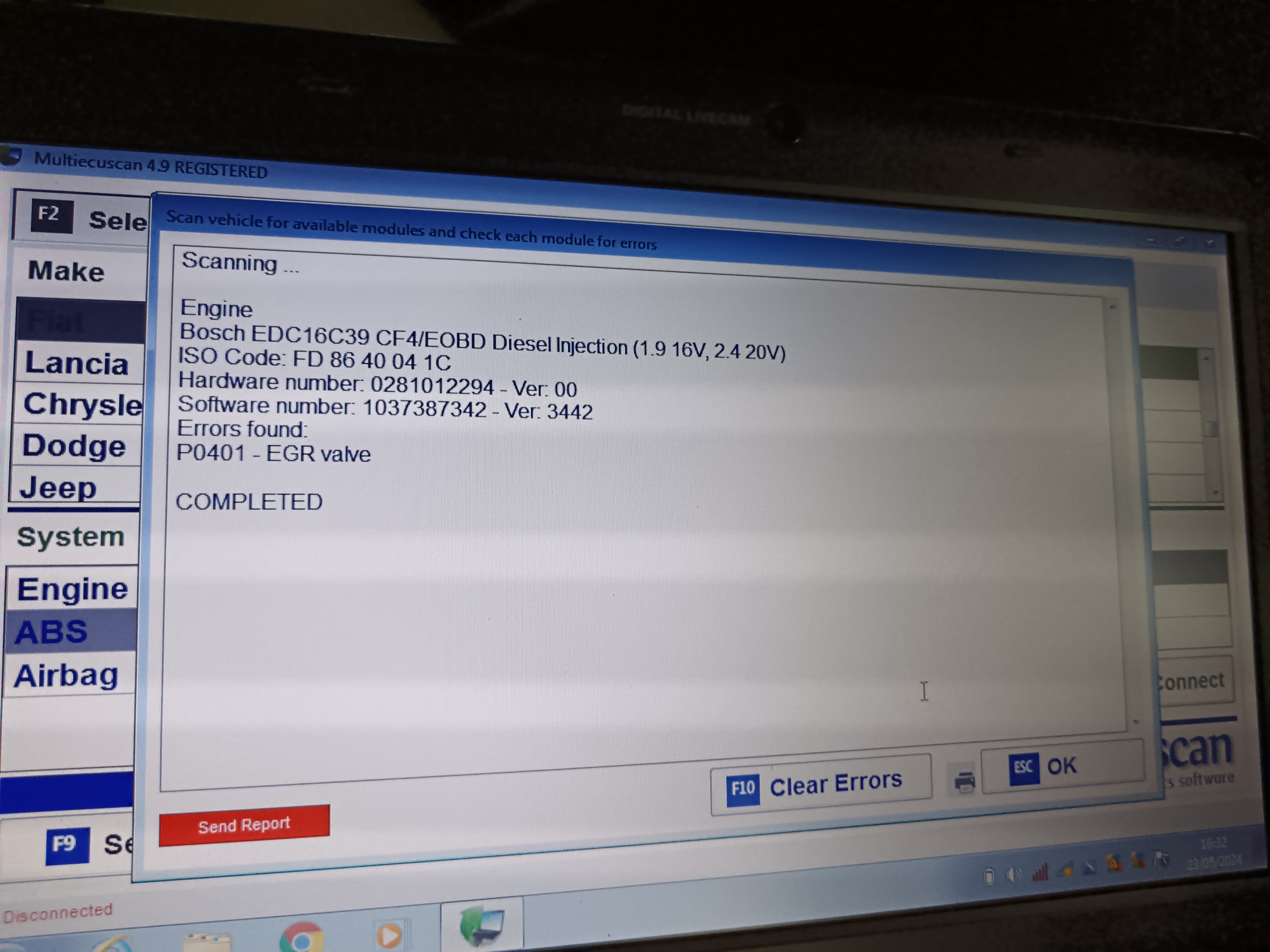

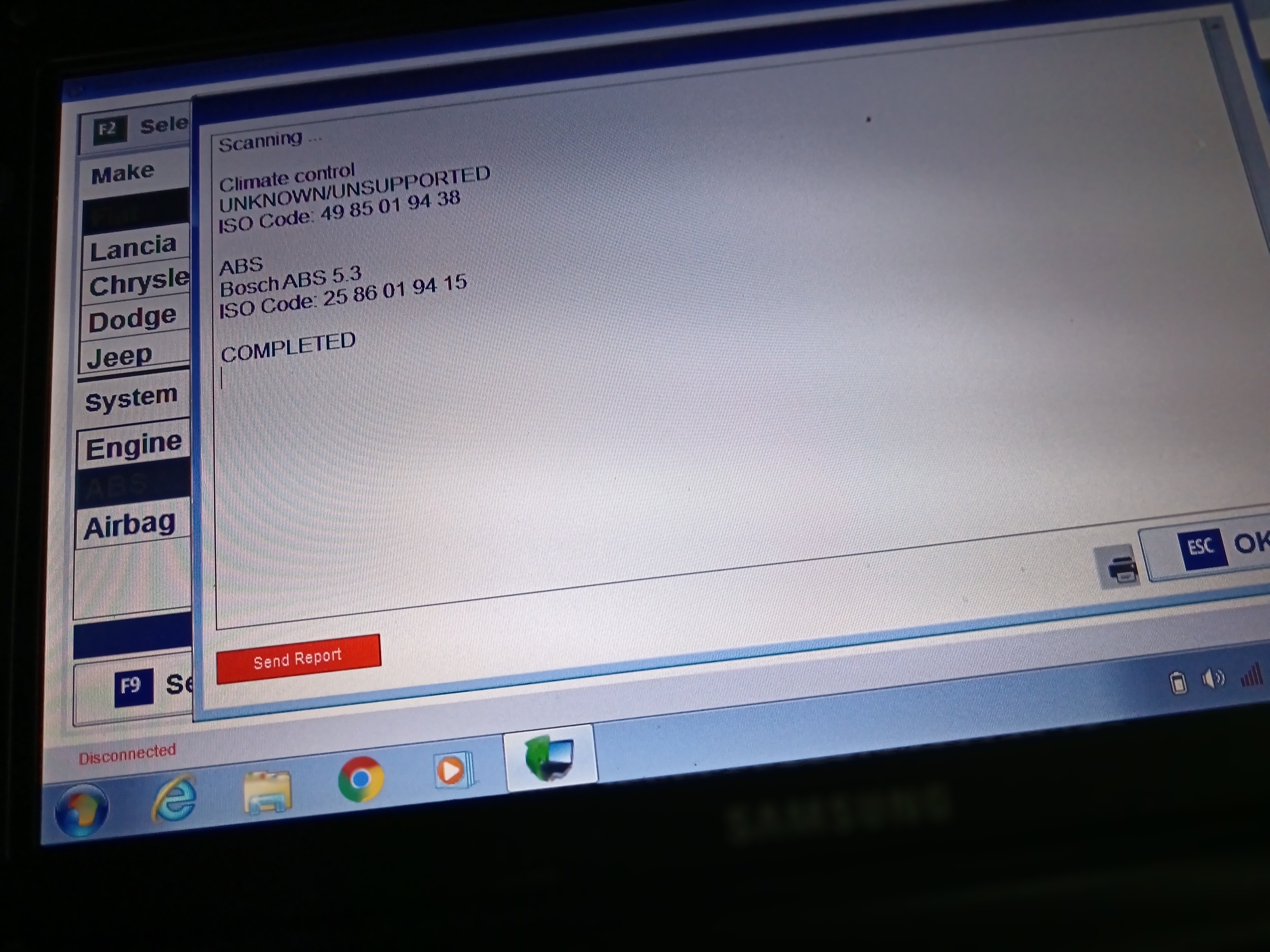

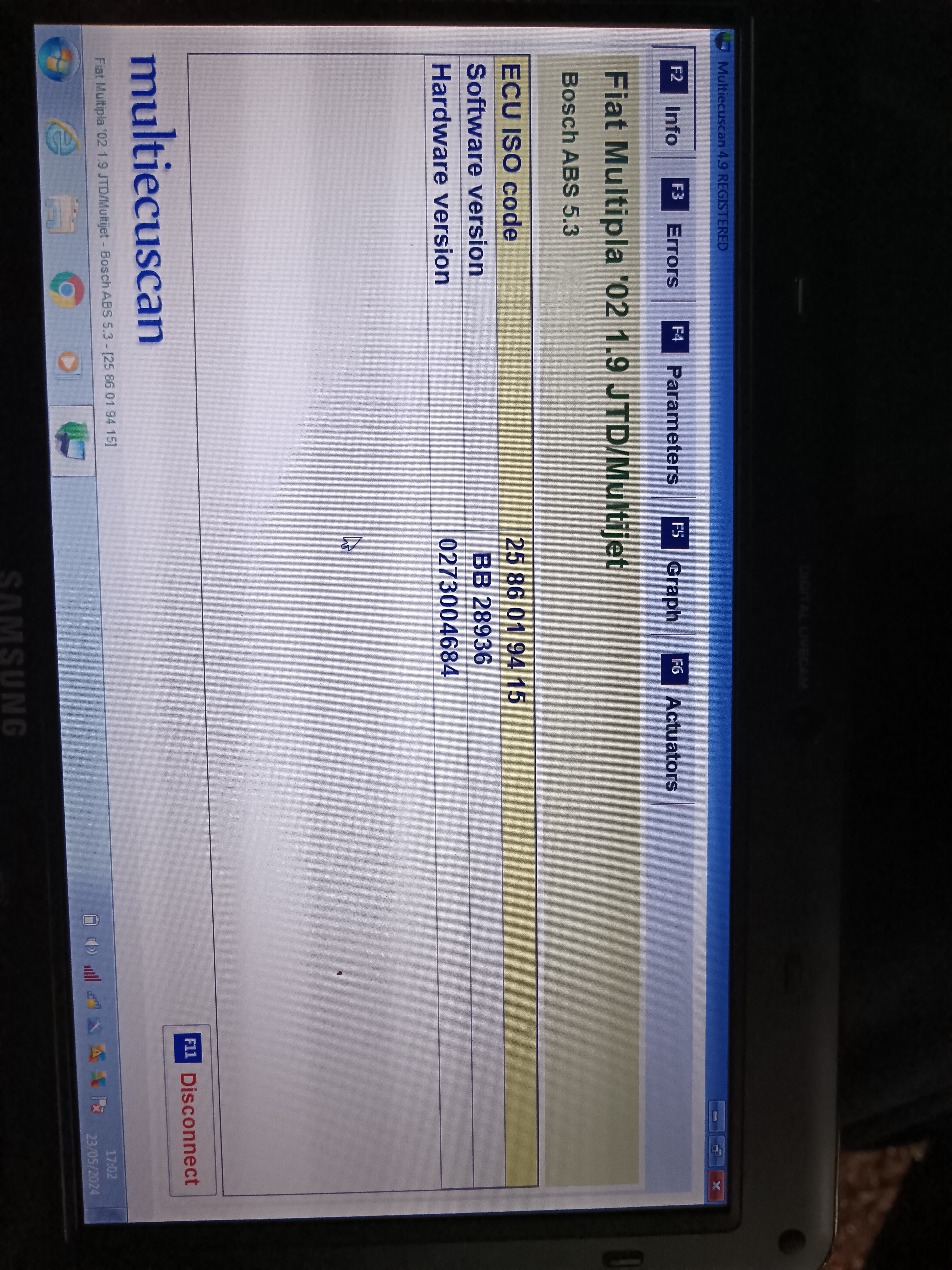

AND without it connecting for a Scan with the ELM.. I Couldn't ascertain what ABS unit to set-up for
After a while we got thereView attachment 445486View attachment 445483View attachment 445484

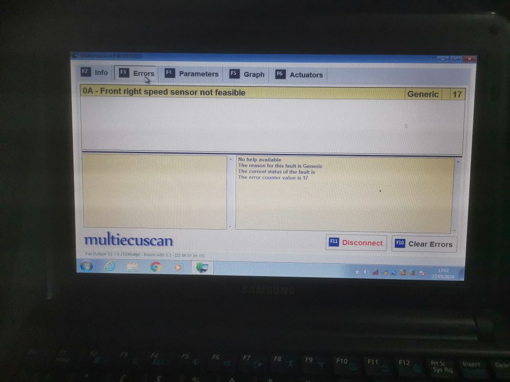

Annoyingly I don't have an image of the error code 😔
@ukjoe should have..
But the code pointed to RH Front wheel sensor
So an excellent starting point
The Error would clear in MES, but the Dashboard kept pinging the fault message 🤔
Owner stated this dash error message error is intermittent..
Look forward to updates 🙂
Thanks again to @varesecrazy for all the time he spent trying the various cables etc to get the error code. So got it and now will have to get around to checking the electrical connection and then the sensor itself. Thanks also to everyone else's contributions and particularly @jackwhoo and @portland_bill
