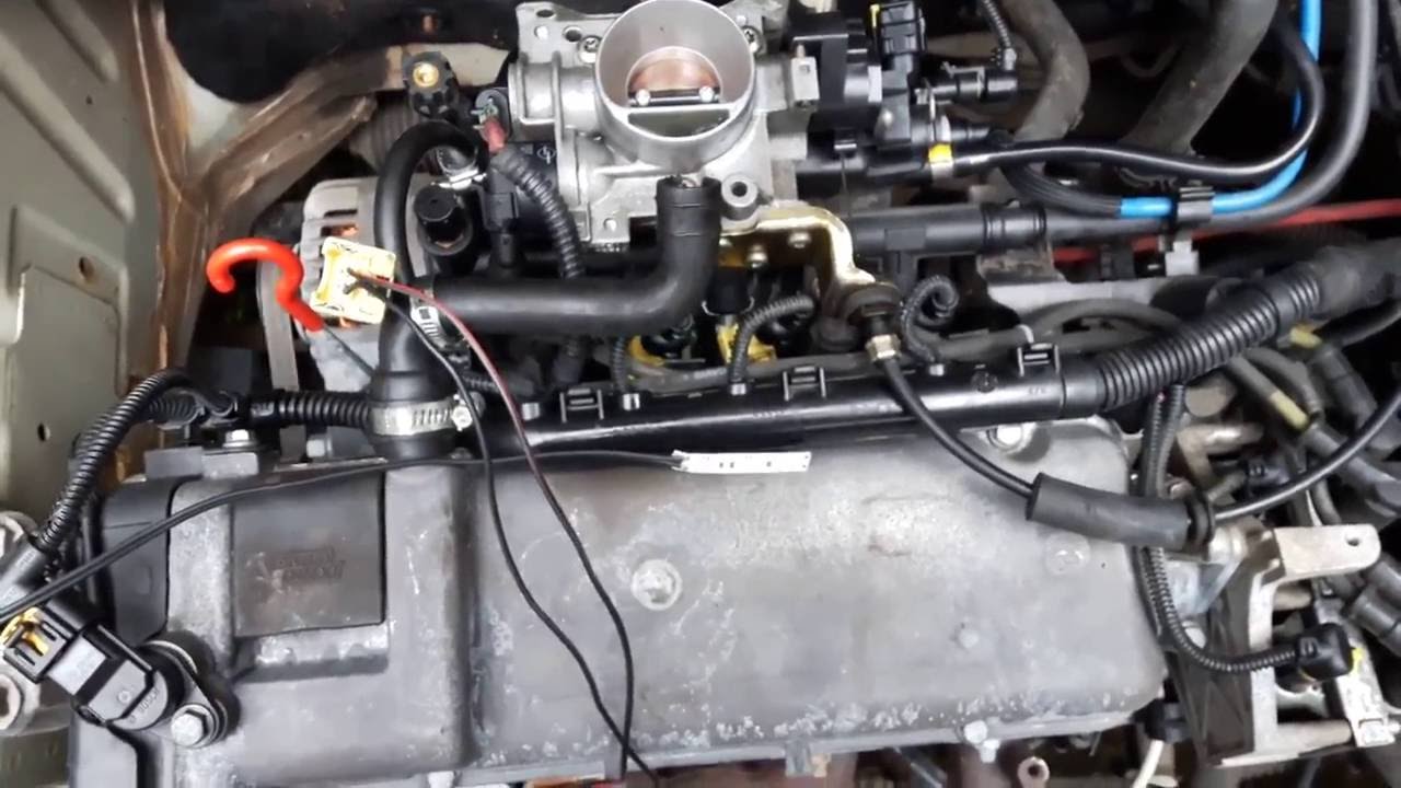

I have a Panda its a 1.1 Active at least on the V5C
But this Panda has twin plastic cam covers with the Ignition pack sitting in between, I thought the 1.1 (2008) was supposed to be a single OHC??

How different is it to a Standard panda pic on here..?
What covers the oil filler.. a screw.on cap or a rubber bung?
Yes, 1.1 & 1.2 Pandas are all SOHC 8 valve engines.
The 1.4 100HP is the only twin-cam 16 valve Panda.
Here's the 1.1 engine in a Panda with the air filter housing removed. Anything like yours?
This is quite an early 169 Panda, as varesecrazy says the oil filler plug changed to a round screw-on cap at a later date.
The spark plugs sit quite low down at the back of the head, between the cam cover and throttle body.
