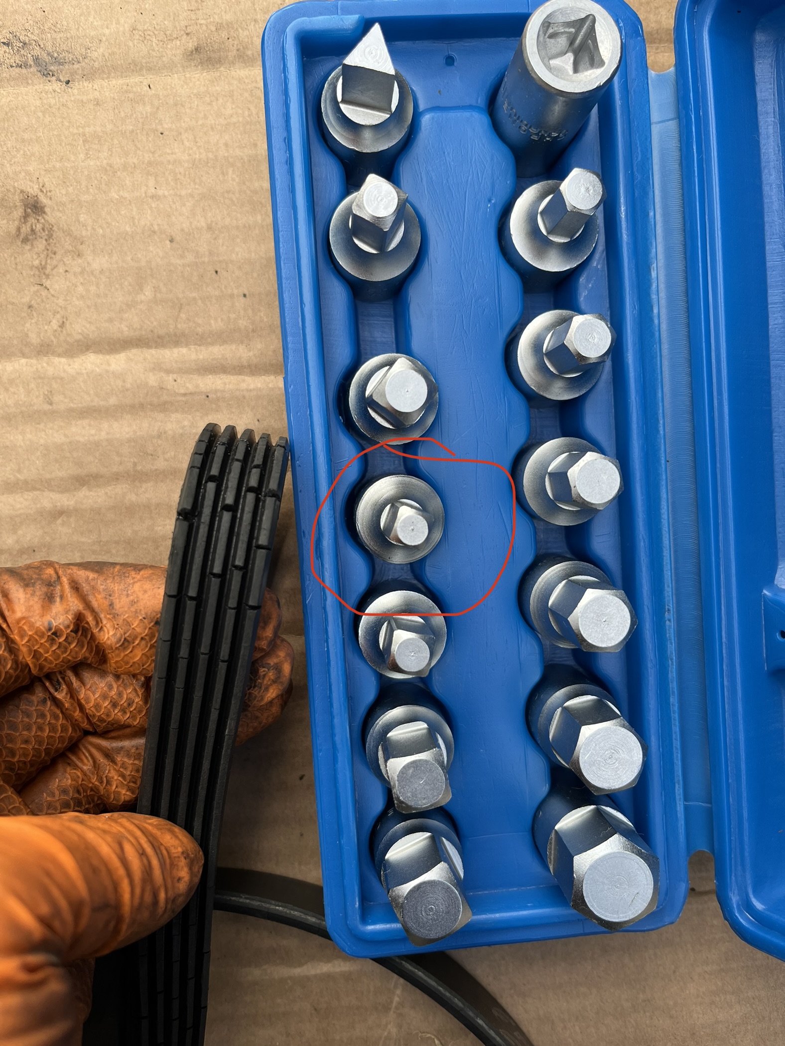

TA 4x4. Finally manged to obtain the 7mm square tool to relieve the tension on the ancillary (serpentine) belt so swapped that out; not been done in my ownership and it was ready for it!

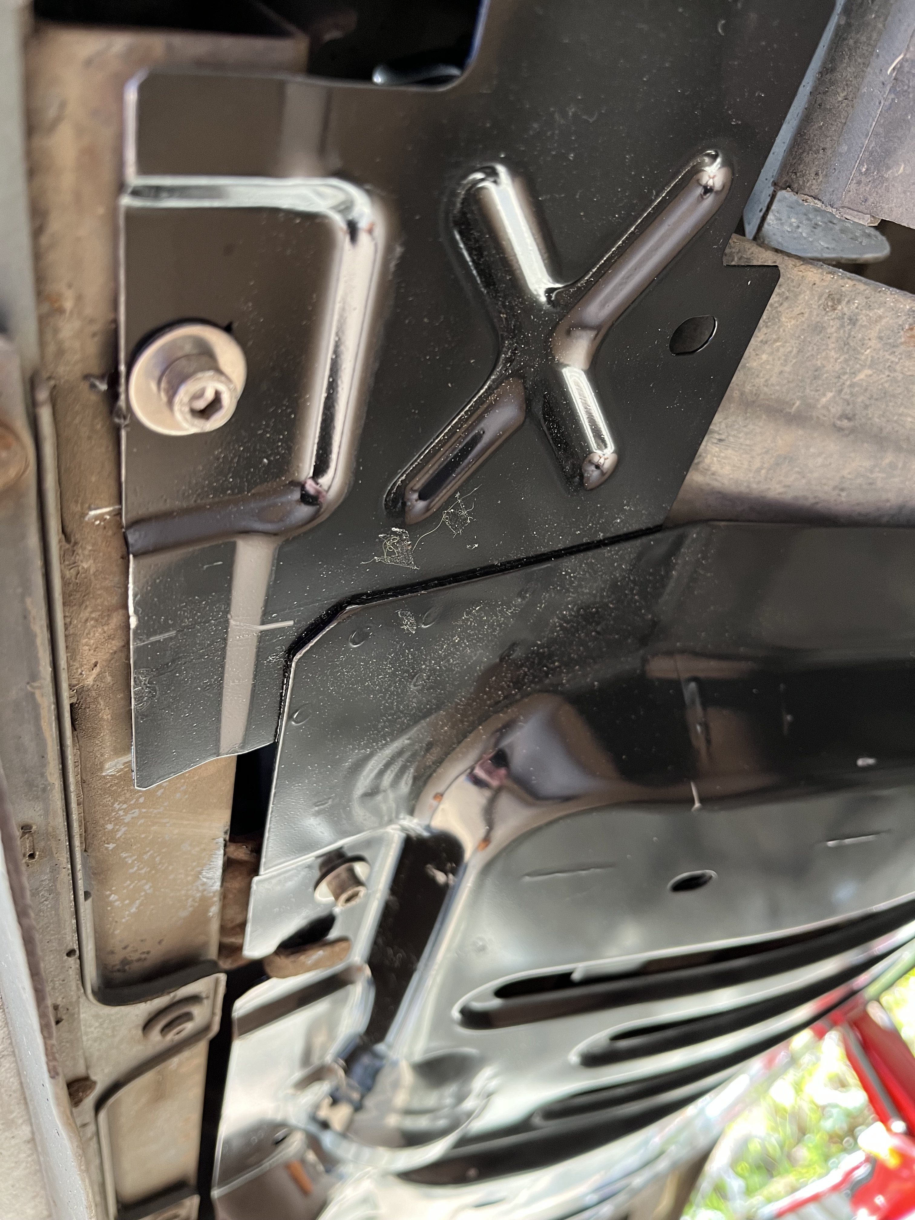

Also got around to fitting the new sump guard (as described elsewhere on here I abandoned thoughts of fabricating a stainless version despite buying the material). Gave a quick coat of Hammerite smooth and swapped now dodgy 10mm hex bolts to stainless allen bolts and washers.
View attachment 420990View attachment 420991
Is that a genuine fiat sump guard?
Yes; not sure when that post was but I took the guard off a couple of weeks ago to change the oil and it is still looking good on the inside (engine side) which is where the last one rotted through from (water pools up there). I found some old (clingy) motorcycle chain lube in a corner of the garage from many years ago and gave all those nooks and crannys a bit of a squirt. I'm sure that guard will outlast the rest of the car given the first one lasted 10+ years!
