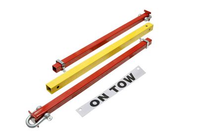

you must have a rigid or a rigid damped draw bar (not on the towbar but on the towing eye
like this
an on tow sign for the car

Where would I get one of these rigid tow bars in a hurry? Halfrauds?

Gizmo you need the light board to duplicate your driving/brake lights to the back of the towed car, so a plate in the rear car wont realy make you legal. How far you gotta tow your mate?Halfords do a bar for £30

To do it legally you'll be needing a set-up like so:
As mentioned, the Towing bar, on tow sign, and a beacon or two helps make everyone aware of whats happening.

You can't fit them to all tow bars but I've a Ball and Pin towbar :D
So I attached it to the pin.
Try Machine Mart they do 2 one solid
one with dampening spring.
One with spring is about £25 up to
2 ton capacity.

Thats where I brought mine. Was £26.99 about 9 months ago iirc. I went for the one with the dampening spring and it is rated to 2 ton (y)
Comes in a nice carry bag and the bar colapses into 3 smaller bits, and its always in the boot of the Stilo for the 'just incases', like the Pug incident was :p
