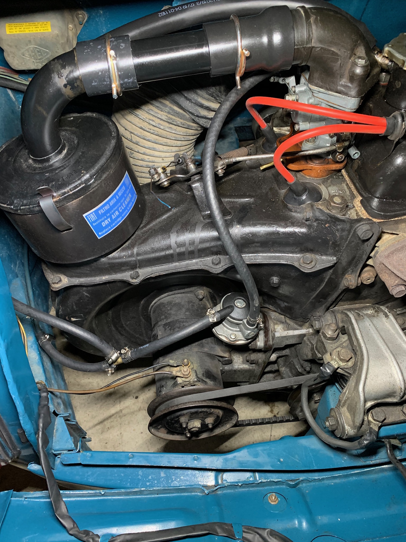

Yes, it can’t be a filter because it’s straight through and it does look like a silencer!!! Very odd. I have one on my 650 engine maybe I should take it off see if it makes a massive difference!:D

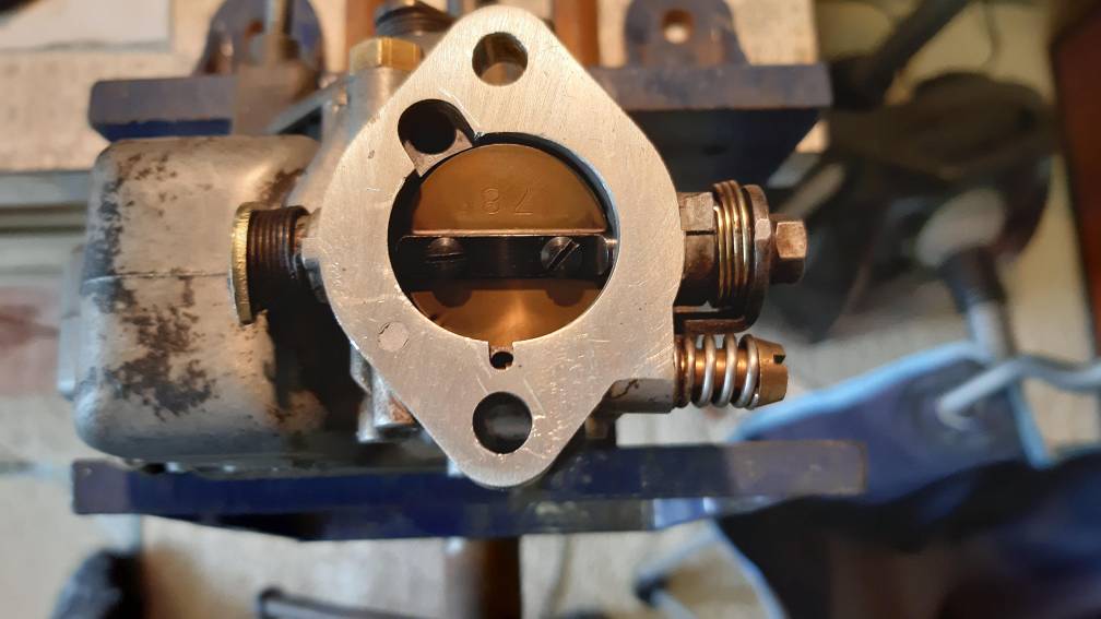

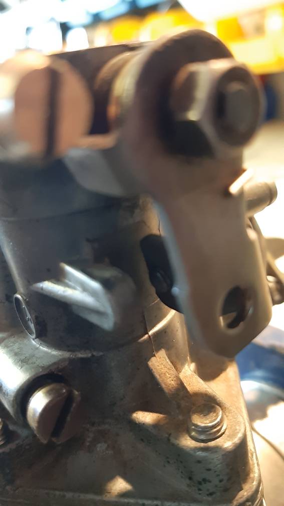

Raising a question here as it is carb related (but part of my ongoing saga on a different thread!).
I have rebuilt a 26IMB/10 using my original, one I had from ebay a while back and one from a "donor" engine in an attempt to rule out the carb as the source of the problem.
My starting point was getting the base as flat as possible.
All now rebuilt but I have a problem with the butterfly valve.
Essentially it doesn't reclose when the throttle arm is opened.

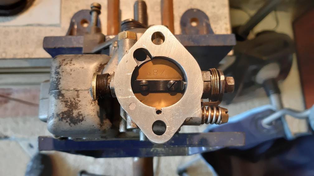

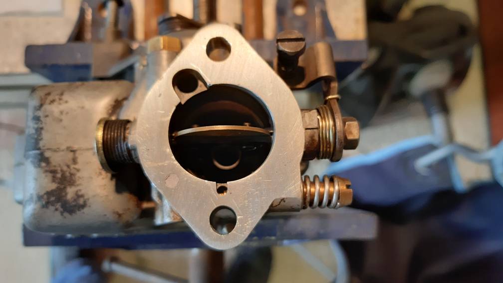

A few photos may explain.
(1) with the bolt at the end of the spindle loose, the valve closes on the springs and the idle screw rests on its stop
(2) and (3) with the bolt finger tight, the valve doesn't close fully and the idle screw is short of the stop (5mm?)
(4) if I tighten the bolt with a spanner, the valve doesn't close at all
I assume the bolt should be tightened otherwise it will shake off.
My conclusion is that something is rubbing or not fitted properly but am totally baffled what.
I should say that, having "smoothed the bottom" I did give everything a good clean and have also tried a couple of different butterfly disks.
Now I will try and load the photos in the right order!
Thanks all.
20200719_162908_compress52.jpeg20200719_162936_compress85.jpeg20200719_162956_compress3.jpeg20200719_163022_compress53.jpeg
Have you tried tightening the nut on the spindle with the butterfly screws loose then look down the carb barrel to see any light around the butterfly. Make minor adjustments on the butterfly until you get best fit and minimum light. Make sure the tick over screw is loose.
Thanks Toshi
Sounds so obvious (doh!).
Yes I think it seems to have worked. I also tried the couple of spare disks I had so hopefully now have the best fit and it seems to close.
Now to put it back on the engine and see if it makes any difference to the running. If not I think I can at least assume the carb is not the issue and move on to the next thing.
Thanks again...much appreciated.
