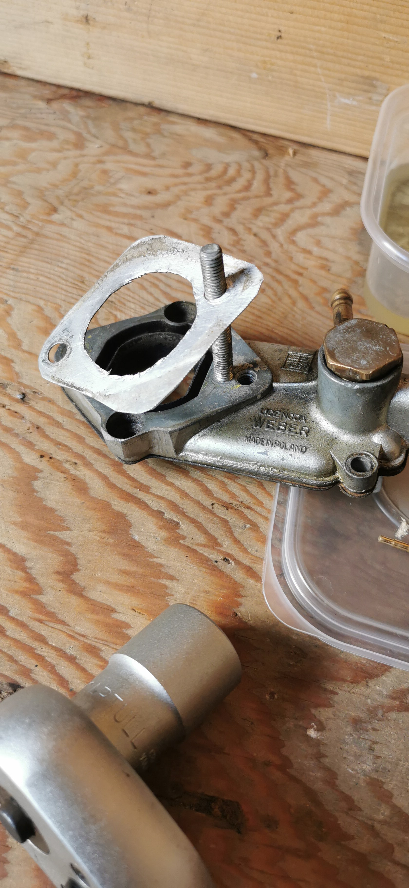

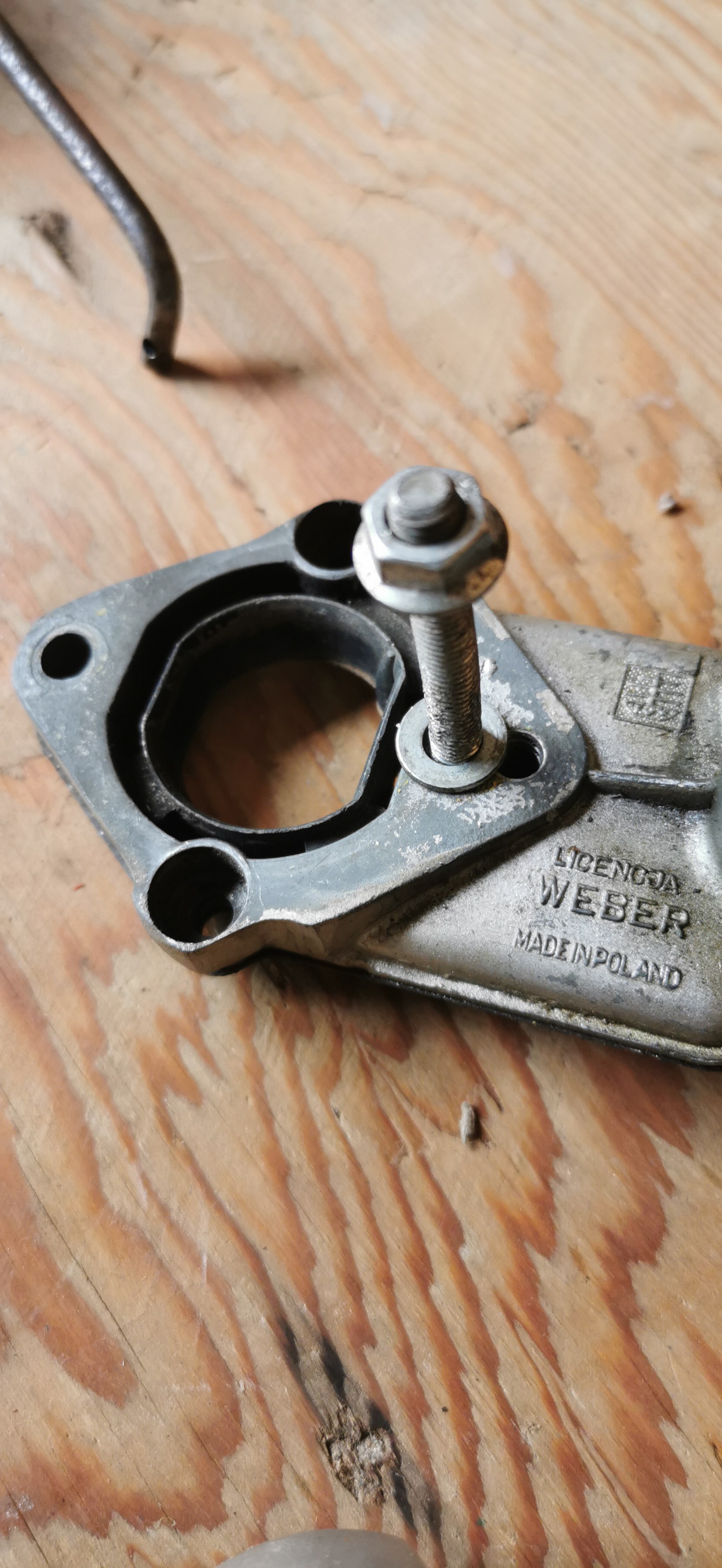

I've recently been asked to look at a friend's 1962 Fiat Nuova 500.
They bought it 'fully restored' from Italy in 2014 but it kept breaking down and has sat ever since.
I've never dealt with a 500 before, and decided to start by stripping the carb which kept flooding (float full of fuel) .
It has a Weber imb 28, which I thought strange as the engine should be 500cc for this car.
So my first question is, will a Imb 28 work on the 500cc engine or do I need to change anything?
My second question is, how would I quickly check the size of the engine, as the number doesn't match the car so has obviously been put in during the restore.
Thanks
In addition to my previous post:
I noticed whoever did the 'restore', drilled a new hole to fit the air intake elbow, presumably from the smaller carb. They made a new aluminium gasket to cover the original hole.
Why would they do this? Just as a short cut as they had the smaller intake lying around? Or is it an attempt to adapt the imb 28 to the 500cc engine?
Also, do you reckon having an open drilled hole loosely covered by the gasket will affect the carbs performance?
Thanks,

If it it the air-filter elbow that is warped, it is an easy job, with a sheet of 'wet 'n dry' on a flat surface (thick sheet of glass is perfect) to flatten it. If the float chamber is constantly filling with fuel, check (a) that the needle-valve is not sticking and (b) that the float has not got any fuelin it. If it has, renew it--they cannot be repaired. Has the engine still got the original mechanical fuel-pump? As forengine type,let us have the engine type---it will be on the machined 'flat', level with the fuel pump on the rear of the engine.

whoever did the 'restore, drilled a new hole to fit the air intake elbow, presumably from the smaller carb. do you reckon having an open drilled hole loosely covered by the gasket will affect the carbs performance?
I guess that whoever put on the 28 didn't have the correct elbow for it. Or there might have been an issue having the correct pipes for connecting to the air-cleaner. I have a metal air-cleaner lid from a 499cc combined with the 28IMB plastic elbow and it can be done with a mix and match combination of standard parts.
I don't think the spare tapped hole will be affecting anything but an inflexible aluminium gasket might. I would want to fill the surplus hole, get a proper 28 elbow and set things up properly. I've found that any imperfect connections between the air-cleaner and the carburettor can cause running problems so it's an area worth giving some detailed attention.
I have the same set up :)
Looks like someone has gone to a lot of trouble polishing that casting but neglected the functuality side.

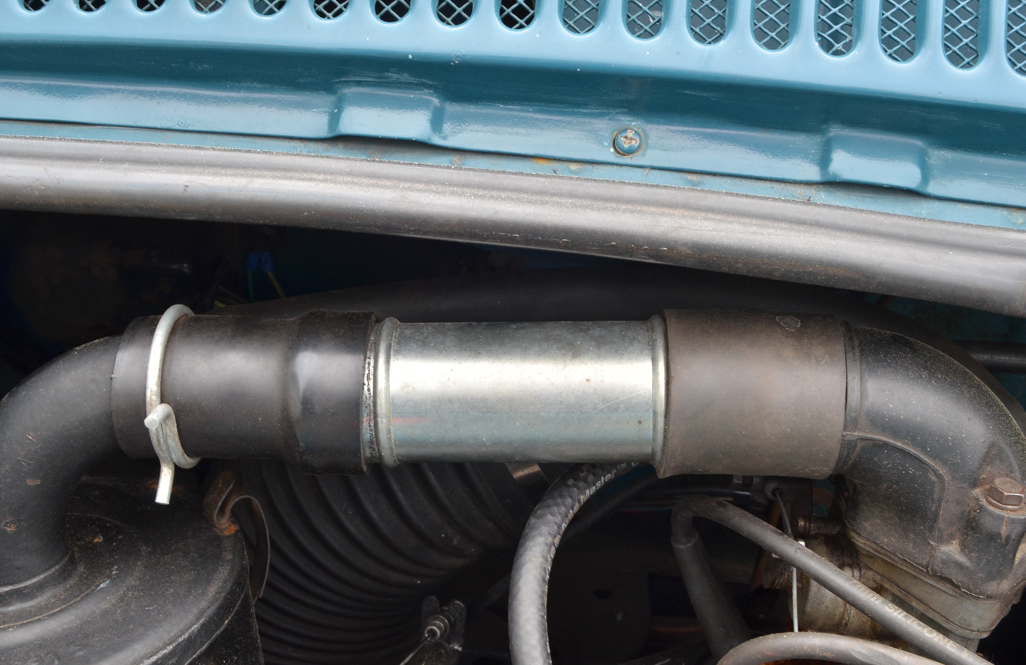

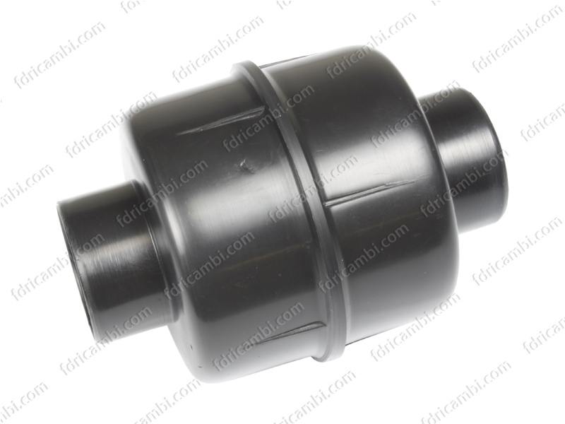

What was the purpose of the pre filter you get on a lot of 126 650 engines, obviously a filter but it has a dirty big hole through the middle of it but has a gauze surrounding it. Not really sure how it would function?
I've never seen a convincing explanation. I once read it was a flame trap but there's already one at the rocker-cover breather. I think it looks like a silencer :eek: and if so.....what's the point? :D
Yes, it can’t be a filter because it’s straight through and it does look like a silencer!!! Very odd. I have one on my 650 engine maybe I should take it off see if it makes a massive difference!:D
