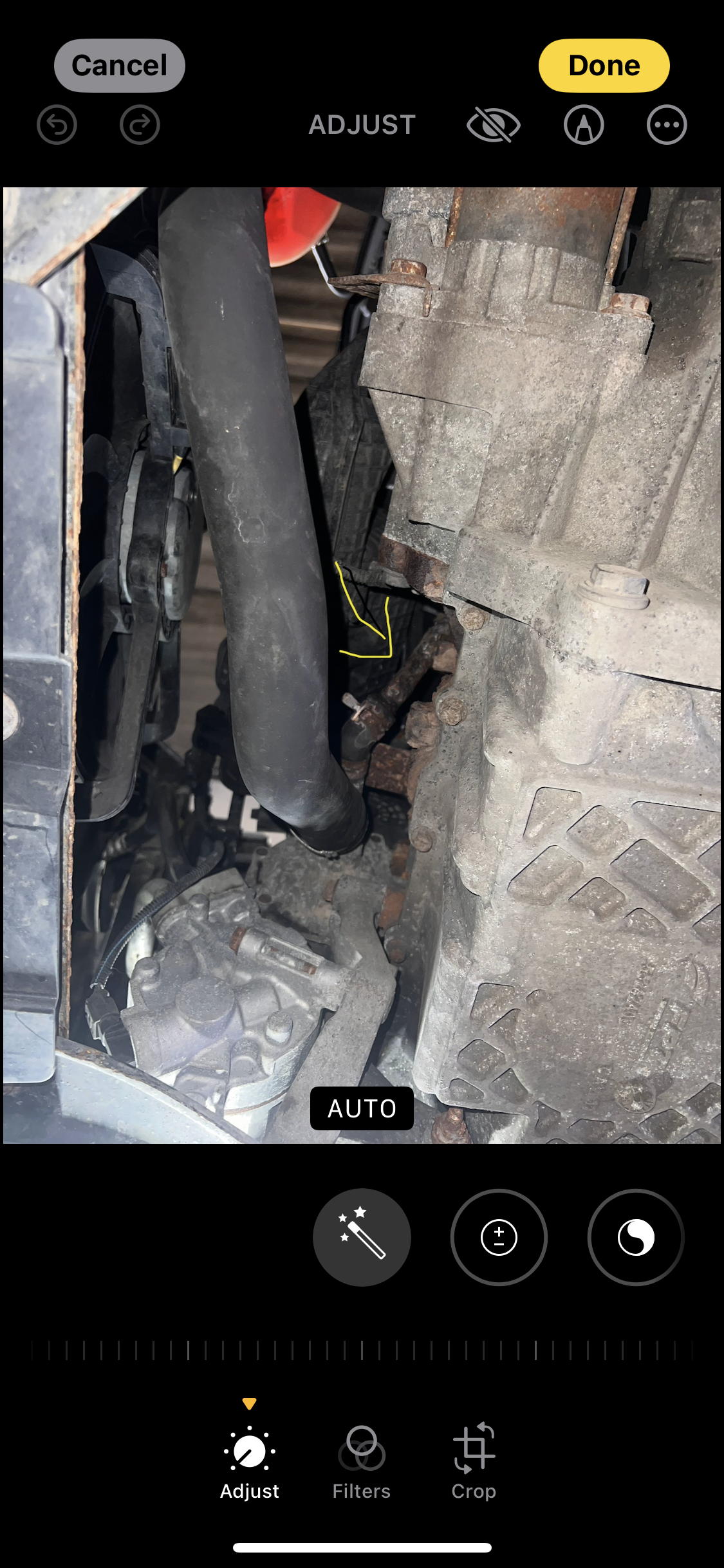

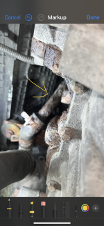

Hi, I wonder if anyone can help me please I’m at the desperate stage. We put our 2016 Fiat 500x in to have the pulleys changed as there’s a terrible rattling and we’ve been told the water pump isn’t working either and needs to be replaced but the small pipe coming out of the pump the mechanic thinks is the coolant pipe is completely rotted and if he takes it off it’ll crumble. Hes called a few places including Fiat and they don’t even have this part listed and said the car is done, unless we can source this part for him it’s the only way we can get the car fixed, we’re at our wits end as it’s been one thing after another, the worst car we’ve ever had. If I attach a picture could someone please help me, any advice would be appreciated.
