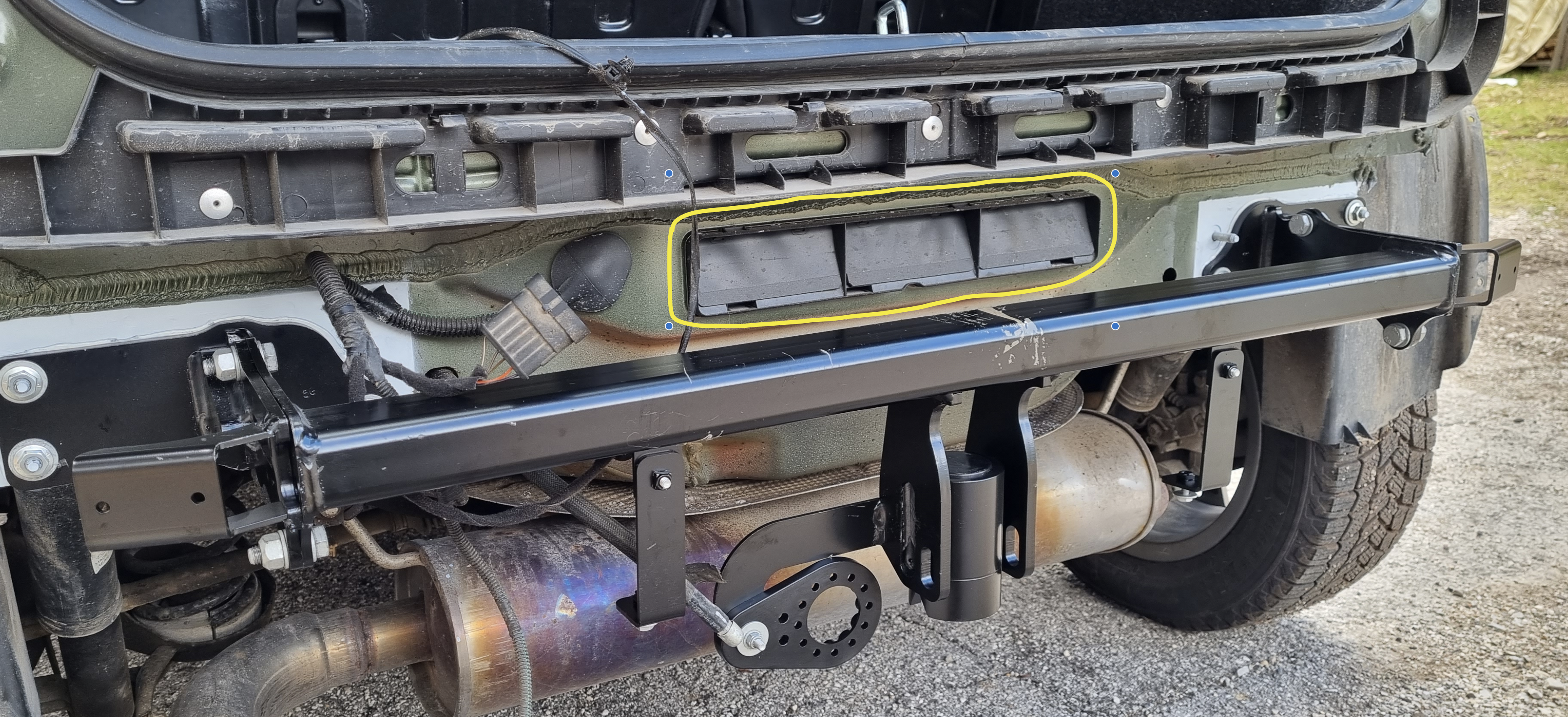

Have you tried looking towards the back of the wheel well? That's where the air exit vent is that TTR (and I) referred to at the start of his thread. That is notorious for letting water into the boot. As you drive along, any puddle water gets scooped up behind the bumper and in through this vent, especially if the rubber flaps in it have got folded in on themselves.
This photo (unashamedly borrowed from an older post in this forum) shows the rubber flaps and vent (circled in yellow), more clearly seen after the bumper's been removed (as it was here during the fitting of a tow bar)
[photo from this old thread: https://www.fiatforum.com/threads/wesfalia-tow-bar-hook-installed-help-with-bypass-bosch-pdc.493554/]
