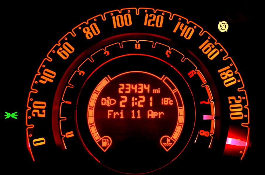

(This grubby example is not mine!) That should bring up the message on the display "Stop Start Disconnected" and light up the S/S lamp on the speedo, top right;
S/S demands that your battery be 100% (or better!:)) so your old battery has probably been deteriorating for some time and perhaps the earth strap too.
