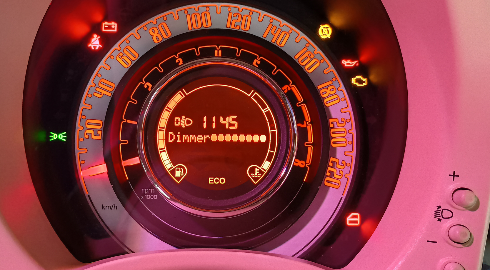

On mine, 2013 Lounge, the display dimmer setting only appears in the binnacle menu when the headlights are switched on. It has eight levels but does not completely go off so that may not help.

On my 2013 Lounge (Euro model), the display dimmer setting only appears in the binnacle menu when the headlights are switched on. It has eight levels but does not completely go off so that may not help.
I set it on the 12th 0f July 2013 to full brightness and haven't ever accessed it since, so I'd forgotten it even existed!🙃
