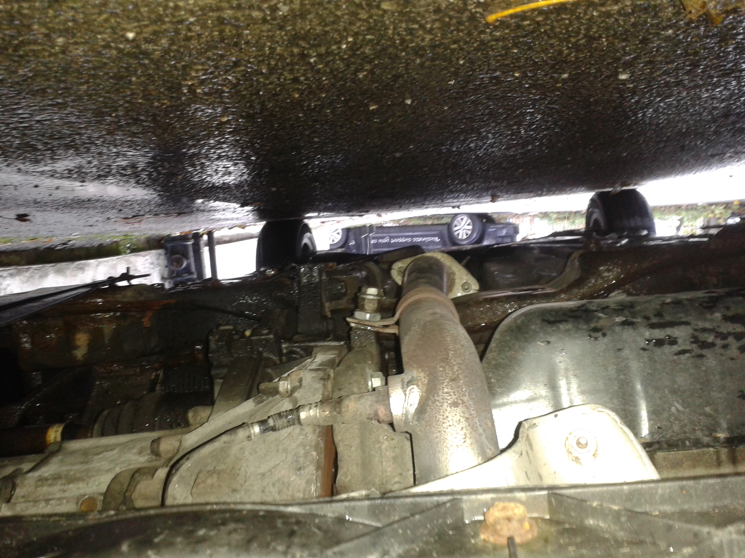

Mine was doing this too, sounded like a jingley rattle, thought it was pinking or knocking.
It was actually the bracket that holds the exhaust to a stub on the bottom of the gearbox, see this image ive uploaded, it might be upside down but you will see the bodged bolt - the hole it goes into is aluminium and becomes threaded, when warm it tightens up and stops the exhaust bracket from rattling but when cold is a pain in the backside and rattles, mine is a petrol, unsure if the diesel has this bracket.
