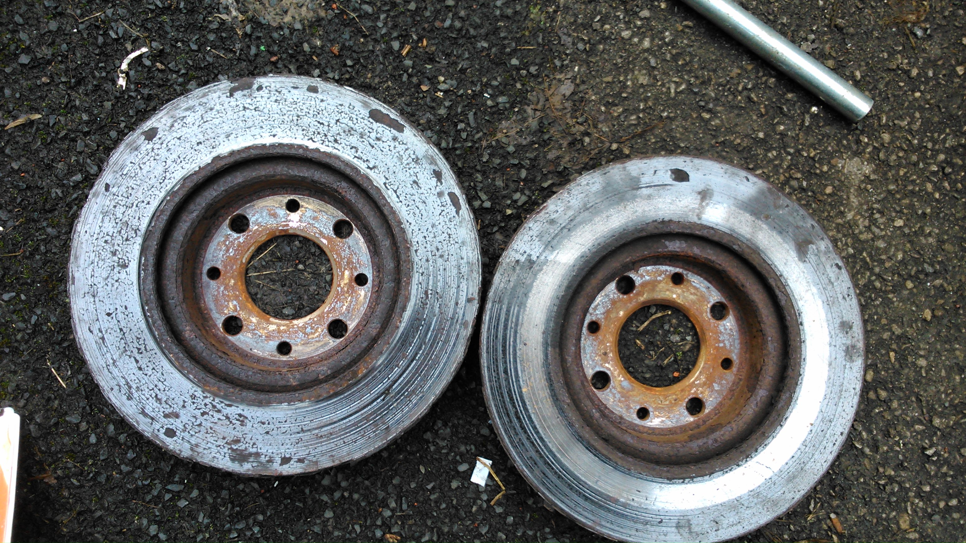

Brakes changed over weekend - found that the drivers side pad had binded to the disc. I thought this was the cause of all my problems but changing it hasn't really mad a difference yet. There's no scraping to be heard and it brakes fine now so I don't think it is still binding. Pads themselves had decent life in them but the discs were badly scored. See below :eek:

The pistons didn't slide back in easily - took a fair bit of force on a small G clamp but I'm not sure what's normal. First time doing it :). But Drivers side was much more difficult to push back in then passenger side.
sounds as if that the drivers side. may well be a bit sticky then..
just keep en eye on the temps,
after a 10 + minuute drive - trypulling up gently using the handbrake , then compare the temp of wheels / wheel nuts,
on front pass + drivers wheel areas.. if the drivers side is binding it will be HOT - rather than warm,
charlie
charlie
They were both hot (couldn't touch the disc) after a 5-10 minute drive, I guess this means I'm looking at new calipers :(.
