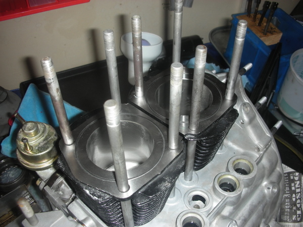

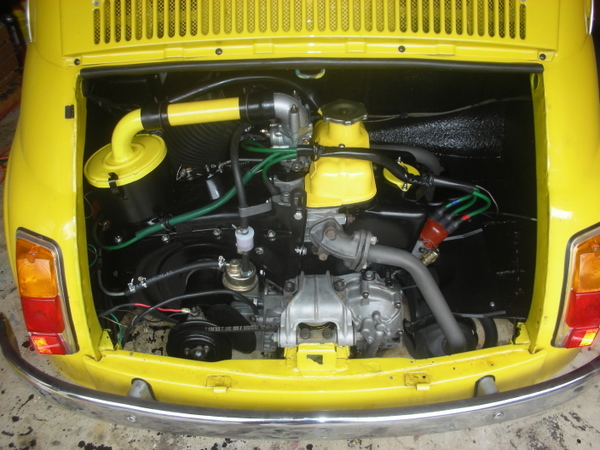

All done. Purrs like a kitten. I can't wait to wear it in so I can really test it.
Dave
