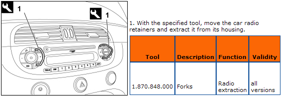

how do i remove the HU?thanks.
I hope this is what you need?! See attached pics
Here you can buy that "tool" what you can use to remove the HU. But to be honest I don't think you really need that piece of wire ;)
