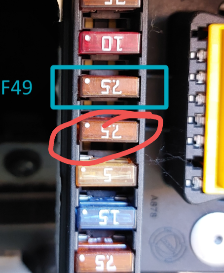

Fuse F49 in the cabin fusebox:

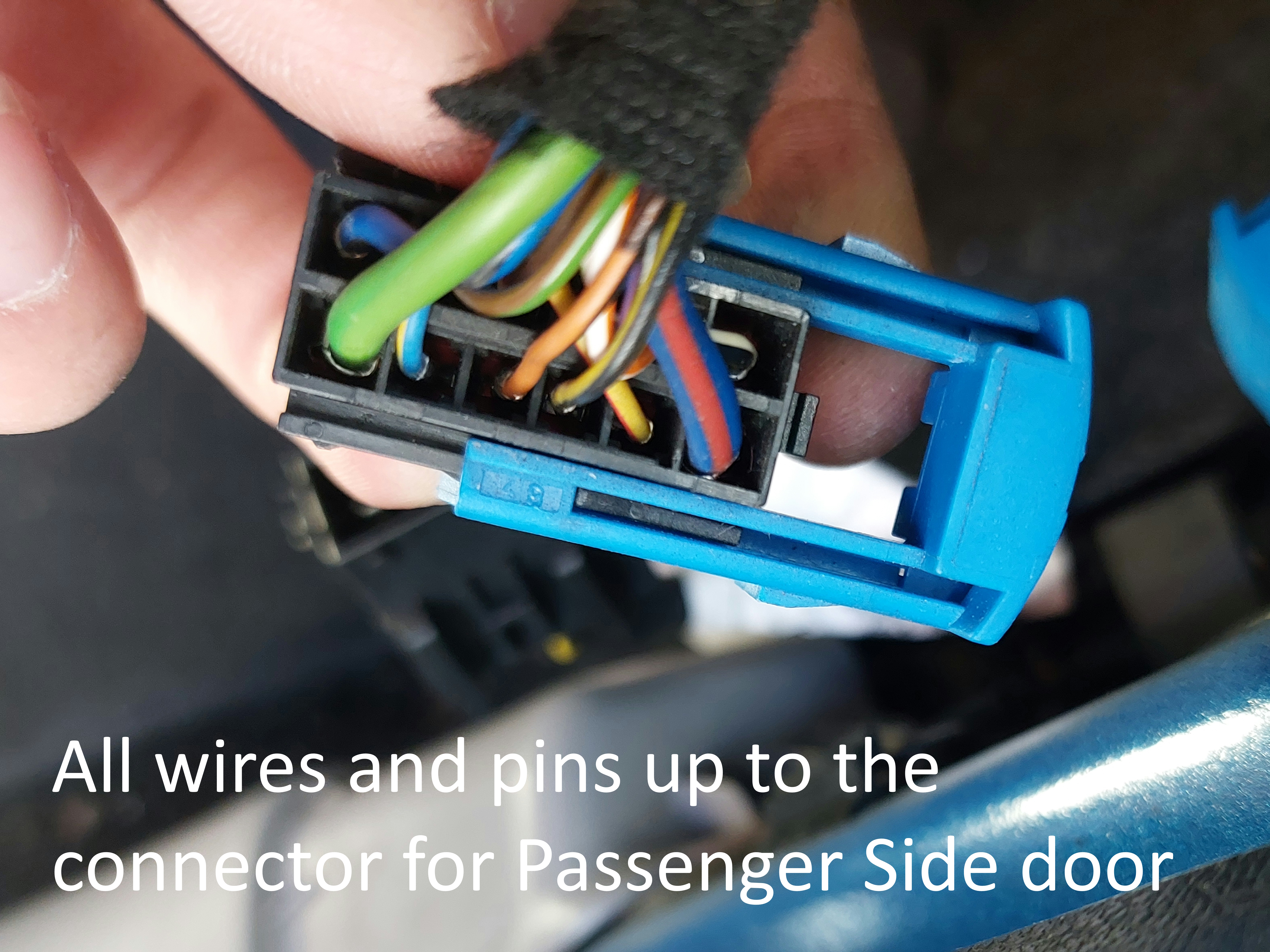

And the wiring looms up to the door connectors have all 12 pins with wires connected:
Both door wiring looms, however, are missing pins:
According to the schematic in my Haynes manual, that's everything, so does this technically mean that all I need (other than the switch and the mirrors themselves) is a set of door wiring looms that have the connector for electric mirrors?

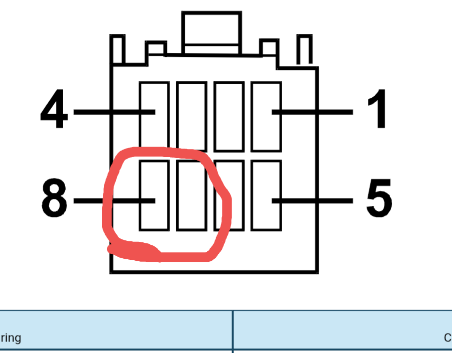

Light blue and white pin 7 and 8
Should be battery voltage at ignition on when measured against a chassis ground

I make fuse 49 one lower not that it makes any difference they are both 7.5 amps

Had a look on eLearn myself and it seems that H030's pinout is:
Pin 1 & 3 - Left Mirror Control
Pin 2 & 4 - Right Mirror Control
Pin 5 - Ground
Pin 6 - Power (from switch to mirrors)
Pin 7 & 8 - Power (to switch)
So technically could I stick the positive multimeter probe in 7 / 8 and then the negative one in 5 since it goes to ground? Or am I misinterpreting and must I make my probe reach a bit further and find an actual grounding point?
Quite right, it would appear I have read it upside down- Tip off should have been that the numbers were the wrong way round 😅

The proper ground is on the passenger side A post
Same as pin 5
Seat belt bolt will also works
Same as pin 5
Super, thanks, will test today
How easy is it to find the correct door harness they were only fitted to higher end models
Asked a car breaker I've bought bits off previously and they're willing to sell me the pair of mirrors, switch and door looms, so that turned out to be the easy part ;)
