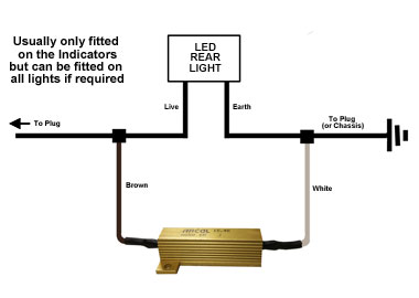

I agree with Ray. If you've swapped the LED lights from side to side and the problem is still on the left indicator circuit, there must be a resistor pack in the MH converter wiring between the cab and rear lights that has gone faulty.
thank you for that link I will send for them but never been into these types of things ( more into mechanics ) do I just insert each end of the resister into the live and earth as i did to put into the extra 21watt flasher bulb ,sorry to be such a thicky .You have all been great with all your advice Brian
Yes

thank you for that,i have sent for them from your link regards brian
