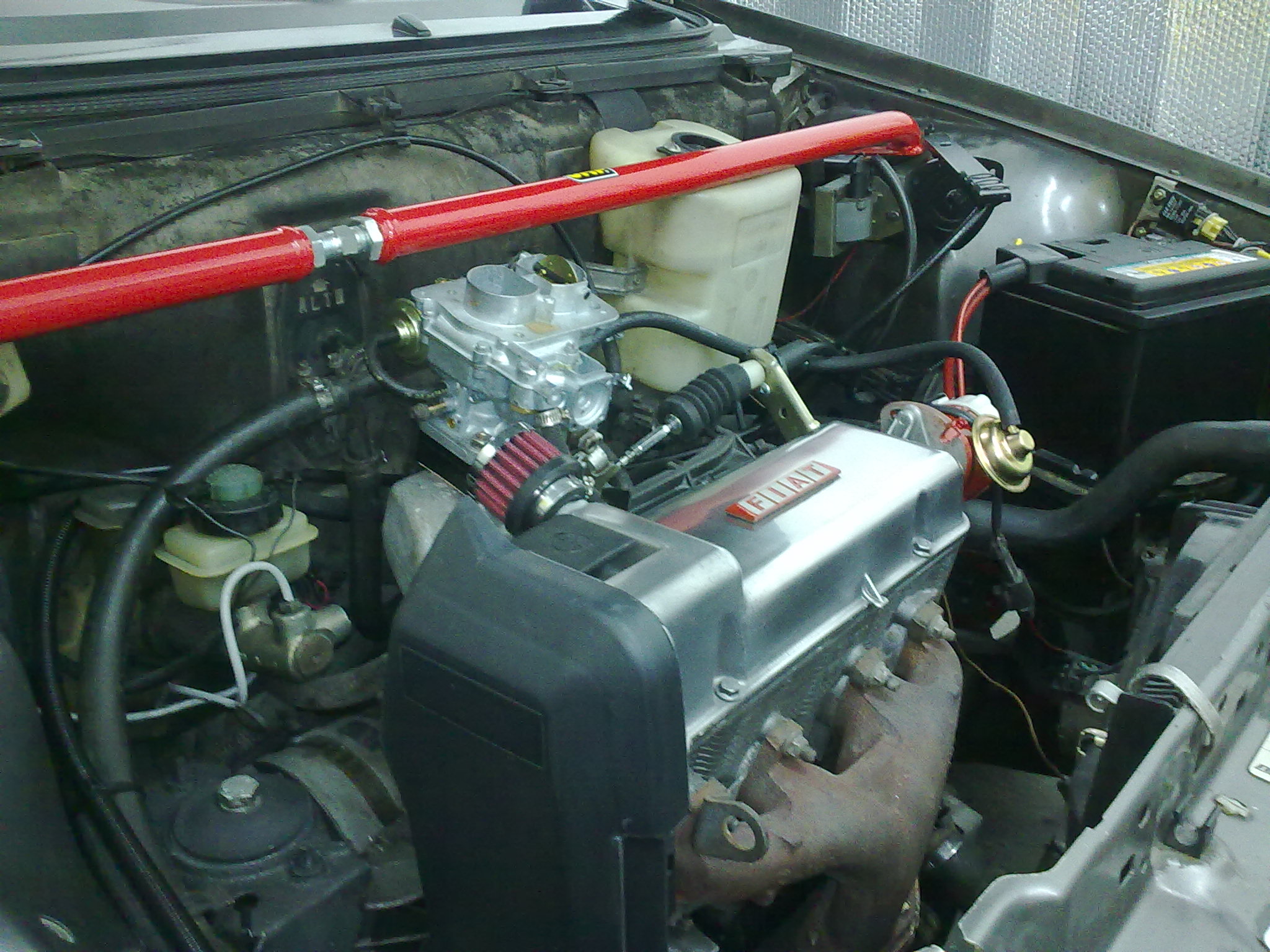

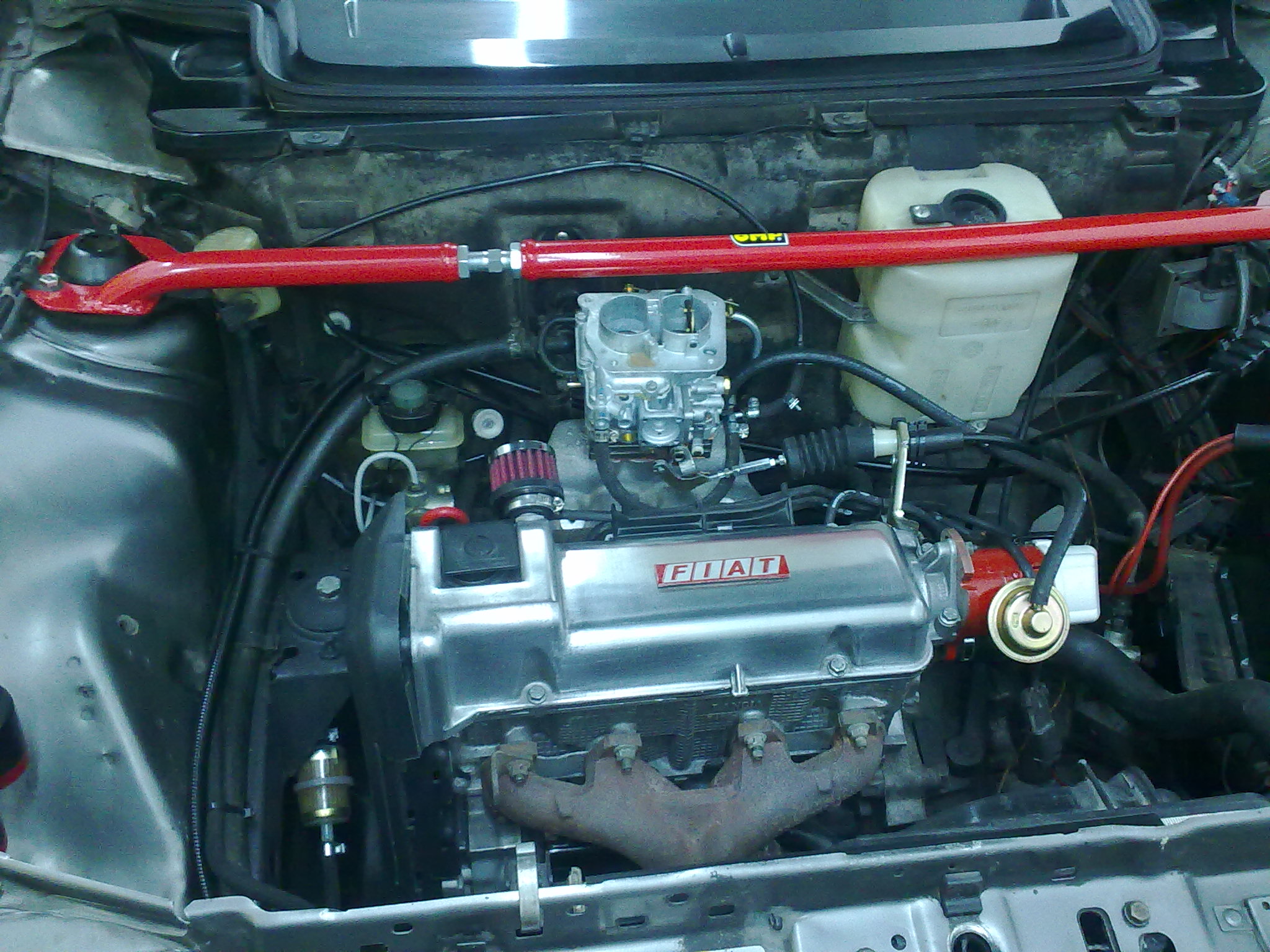

Took a new direction and switched to a weber 32/34 DMTL for greater stability and smoother idle....
The manifold is a punto 75 with modified injector holes and custom adapter flange....
A k&n filter to fit the carb and 4-2-1 stainless manifold are in on the way...
Great work! :)
Thanks for letting us know what parts you used to make it fit and work.
-Alex
welcome mate! I see you're a Fiat / Alfa driver as well :)...
a couple of details on the punto 75 manifold...the injector holes need to be blanked out... I used a 3/8" taps to thread the holes and used plugs... one of the injector holes need to have an elbow fitted so you can attach the vacuum hose to it....
The reason it the standard elbow at the back of the engine protrudes too much and dosnt fit coz of the firewall....so it needs to be removed and plugged accordingly....
just adding some more detail to avoid surprises

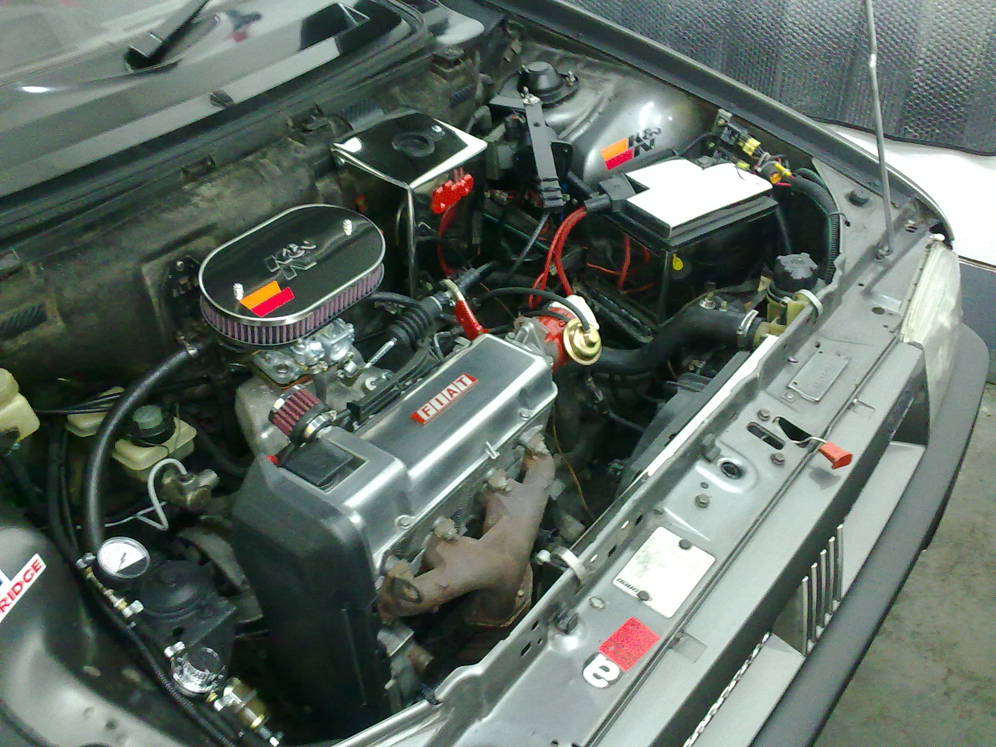

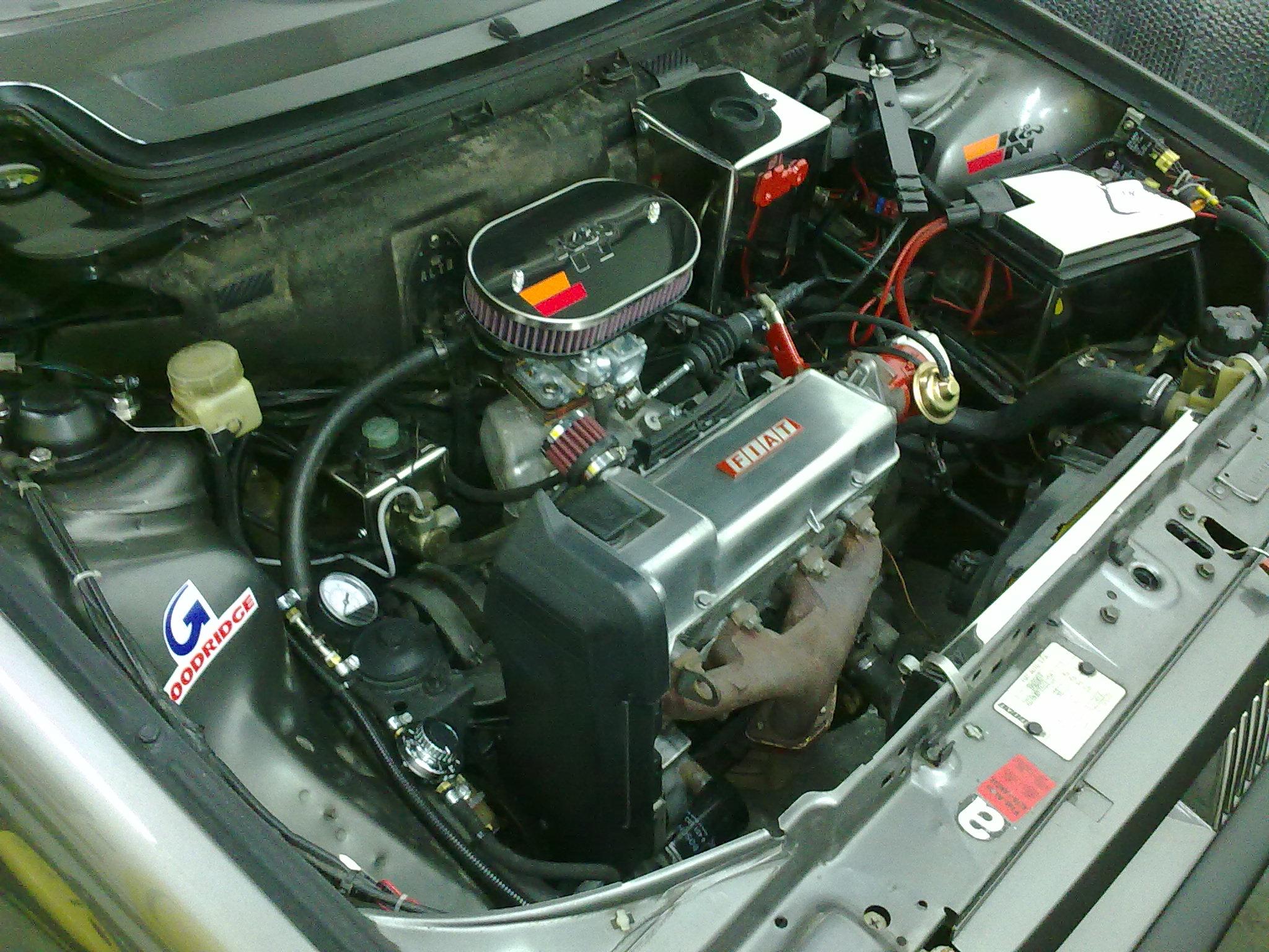

After two months of painstaking work the engine is nearly complete; its missing only the 4-2-1 stainless manifold which the Italians are taking ages to finish and ship....
Had to run significantly larger jets to get the engine responsive and aggressive
55/110 primary
70/110 secondary
mixture seems ok, starts easily, runs ok ...plenty of power....lets see what a manifold and a full exhaust does to this baby...

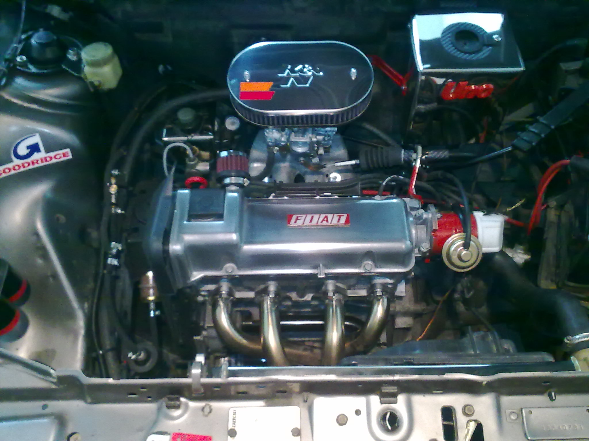

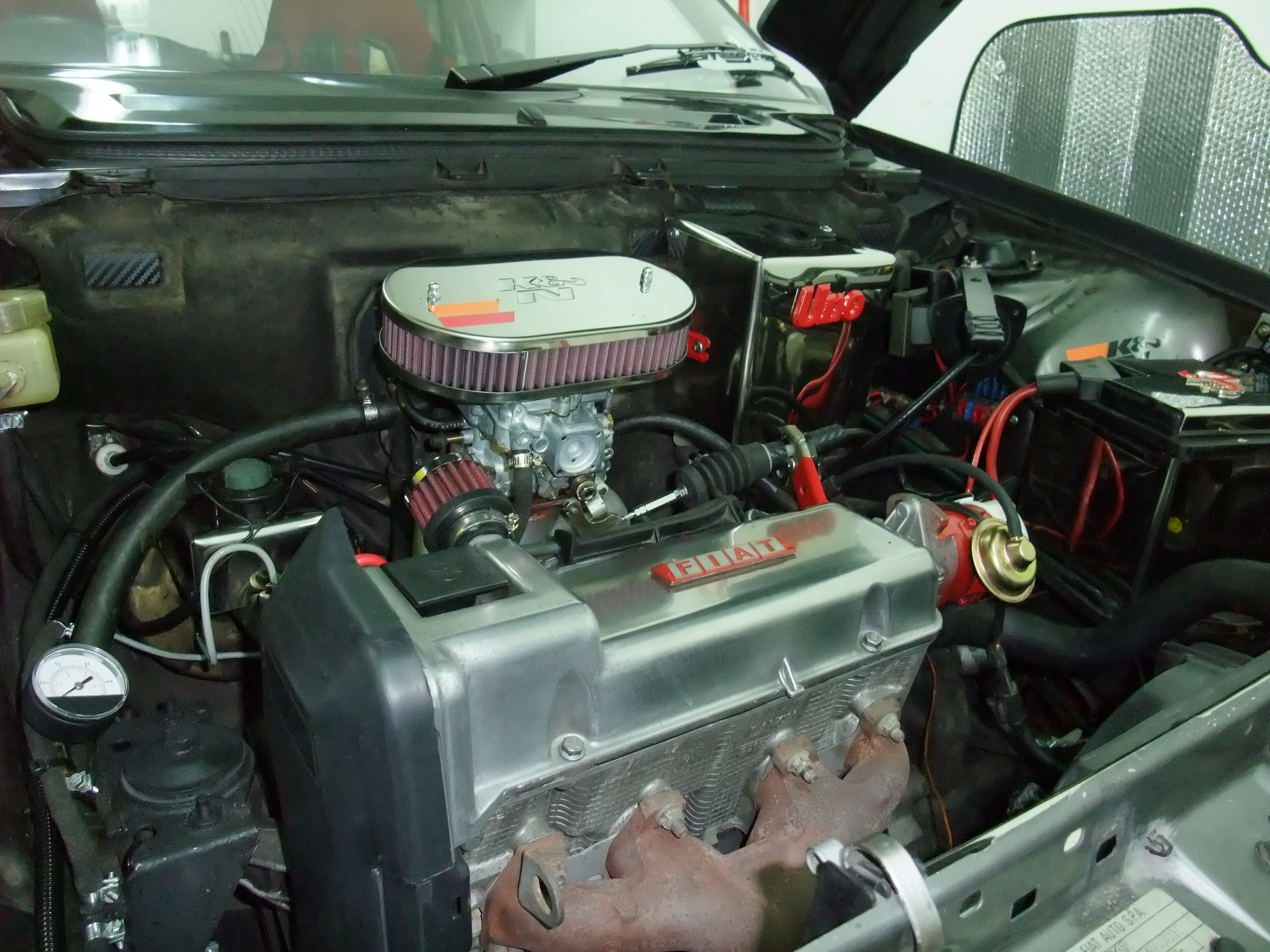

yes its on the way here....Should be here in a couple of days...In the meantime I finished the lambda probe harness with waterproof oem connectors and oem cable trunking and hooked up the a/f gauge....so once i get the manifold, i'm good to go...
And finally the Italians did send the manifold :) after a few mods and a few welds to attach the centre section of the exhaust...here it is....
The lambda probe also gave me a good indication of mixture settings....
idling and revving up to 2500-3000 rpm...mixture ok to slight rich...so i kept he same settings and same idle jet
above 3000 rpm... mixture lean off the scale...swapped jet to one size bigger (115) and mixture remained stable up to above 5000 rpm
with the above settings under full throttle ....engine is lean once again...tomorrow i will swap the secondary main jet....
i got a massive boost in power by swapping the primary main....i couldnt believe it...
