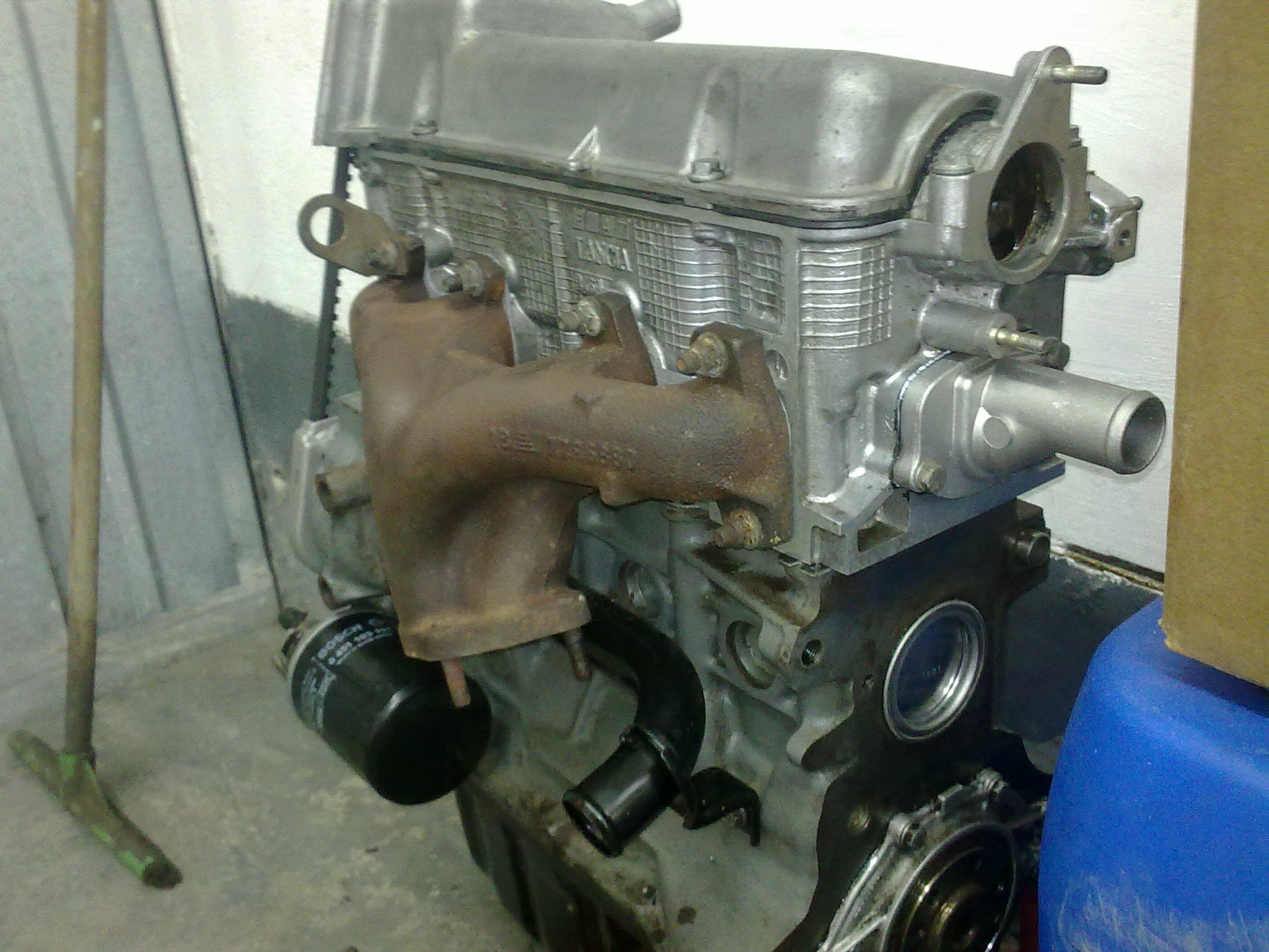

Hi everyone, just finished a 1242cc punto 75 engine swap into an uno...however its not exactly a straight swap as everyone thinks....

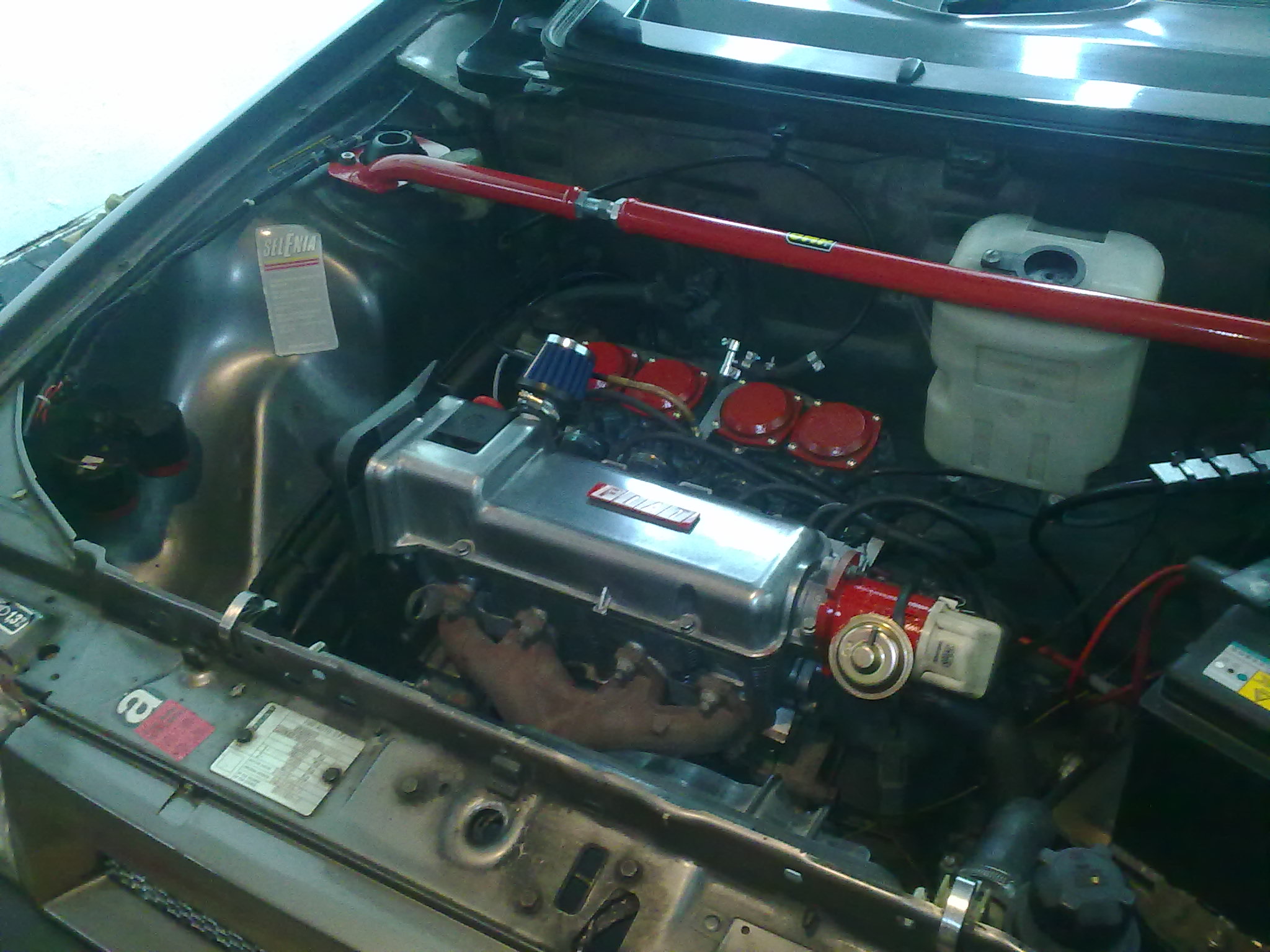

Pics attached:
1 - Engine as bought
2 - Engine reconditioned, all seals and gaskets, pumps and hoses etc renewed. Internal condition checked especially cylinder bore and valves.
Took me a whole day to go from 1 to 2

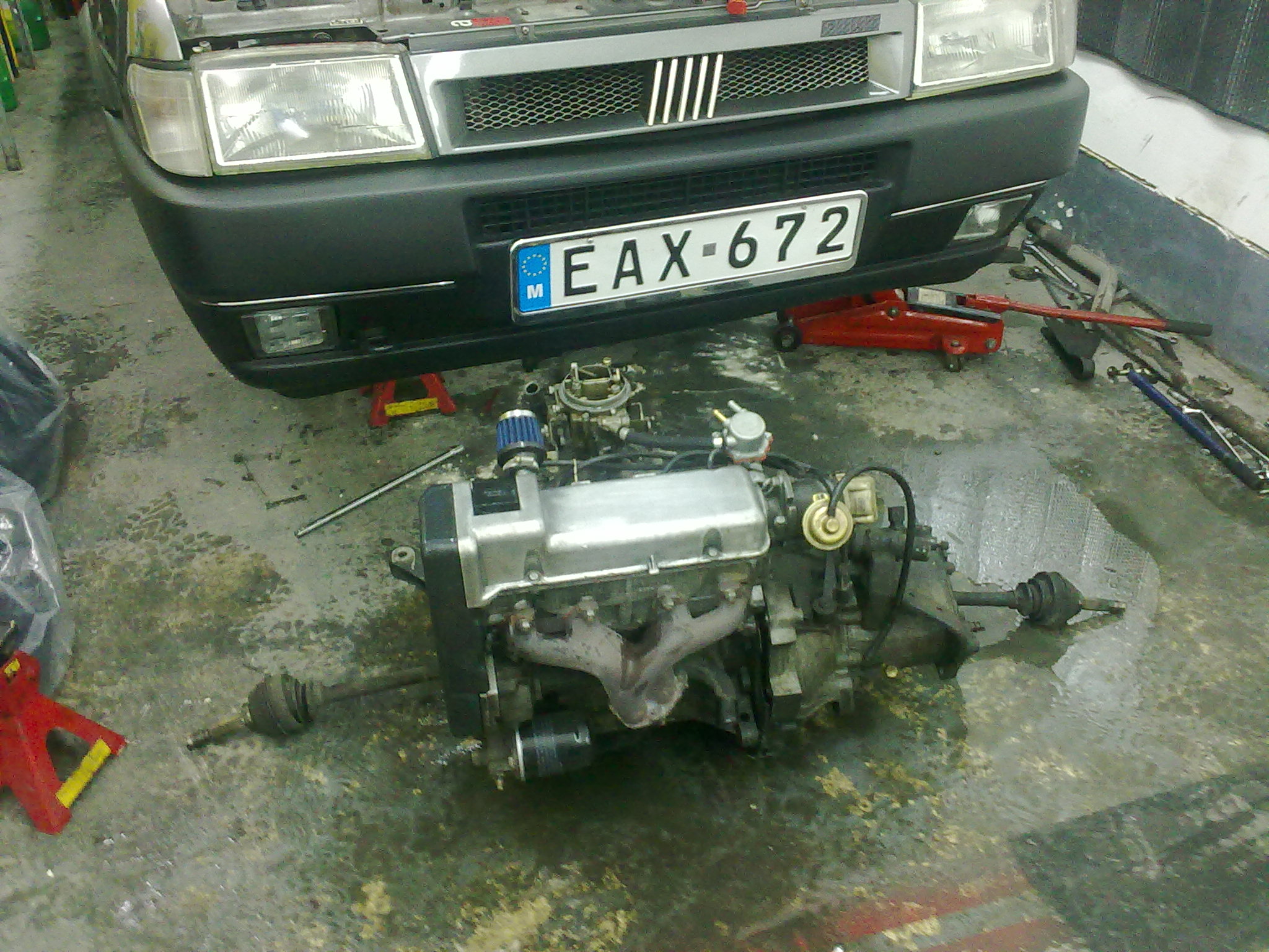

3- Old engine and gearbox out of the car
4 - Conversion complete a full day's work to carry out
