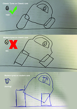

that is a totally different car, which has a massively more sophisticated steering and suspension geometry which is worlds apart f4rom a classic Fiat 500.
that is like getting the Mona Lisa and the latest edition of Star Wars and saying it is better on a massive up to date TV screen. it is an irelavent comparison.
A classic Fiat 500 does not have the ability to keep the foot print of a wide tyre or a modern tyre carcas's foot print in contact with the tarmac. As the car leans it will lift most of the foot print off the road then suddenly loose grip.
Horses for course.
the current Cinturato CN54 tyres are the best tyres for the classic 500. going wider than 145/70R12 will ruin its handling as a road car, and even that will take its tole and make the steering a bit slower and heavier.
just fit the 125R12 CN54. you will have more fun and they are cheap as chips.
we do them fitted to standard wheels with new Michelin tubes, and it is cheaper than paying to have uyour tyres removed, painting your wheels and then paying to have them fitted again. just deliverd all done, simply bolt them on. you dont have a car in your shed on axle stands while all that faffing gets done.
on top of that you are having inner tubes fuitted by peope who understand inner tubes.
Never seen anybody corner like that in a car, a motorcycle yes. Not sure you fully grasped what was being talked about. Those angles in a car would most likely tip them over. Might I remind you that Mona Lisa was most likely a prostitute and you are a tire salesmen. You sell nostalgia, no one in their right minds in 2024 runs car tire inner tubes. Again you are trying to sell classic configuration, but that doesn't mean it's right or any better.

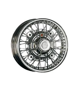

How about a set of genuine Borrani wheels?
https://www.borrani.com/fiat-wheels/nuova-500.html
The wheels we use are the ones we get from Ricambio. When you look at the maths of our wheel and tyres it is a real good bargain, particularly if you compare it to buying a new tyre to fit on a wheel that you are planning on restoring:
