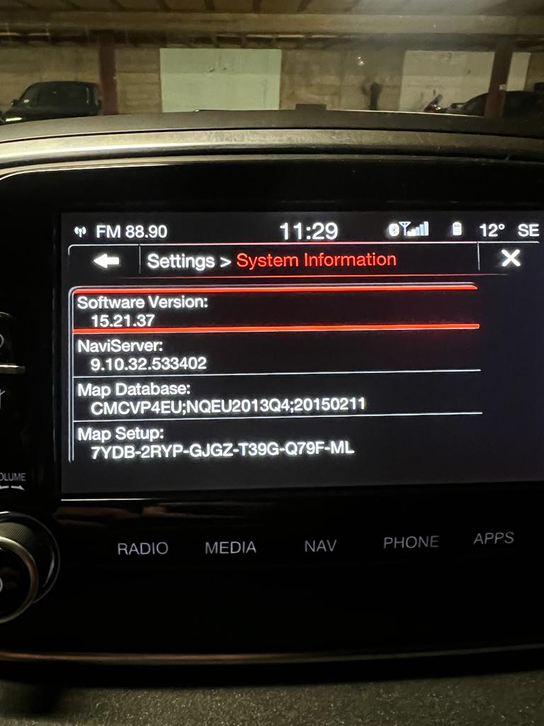

I have a 2015 500x. When I bought it I set up the Uconnect app and connected my phone and all was well. Now 8 years later I wanted to update my maps and the Uconnect app stopped working in Feb - the MOPAR website it redirects to tells me I have no cars connected. On the car any attempt to use Uconnect tells me to open the app - which of course does not work. The software update button is greyed out and I have this info on the screen. Any ideas on how to update and recconect?

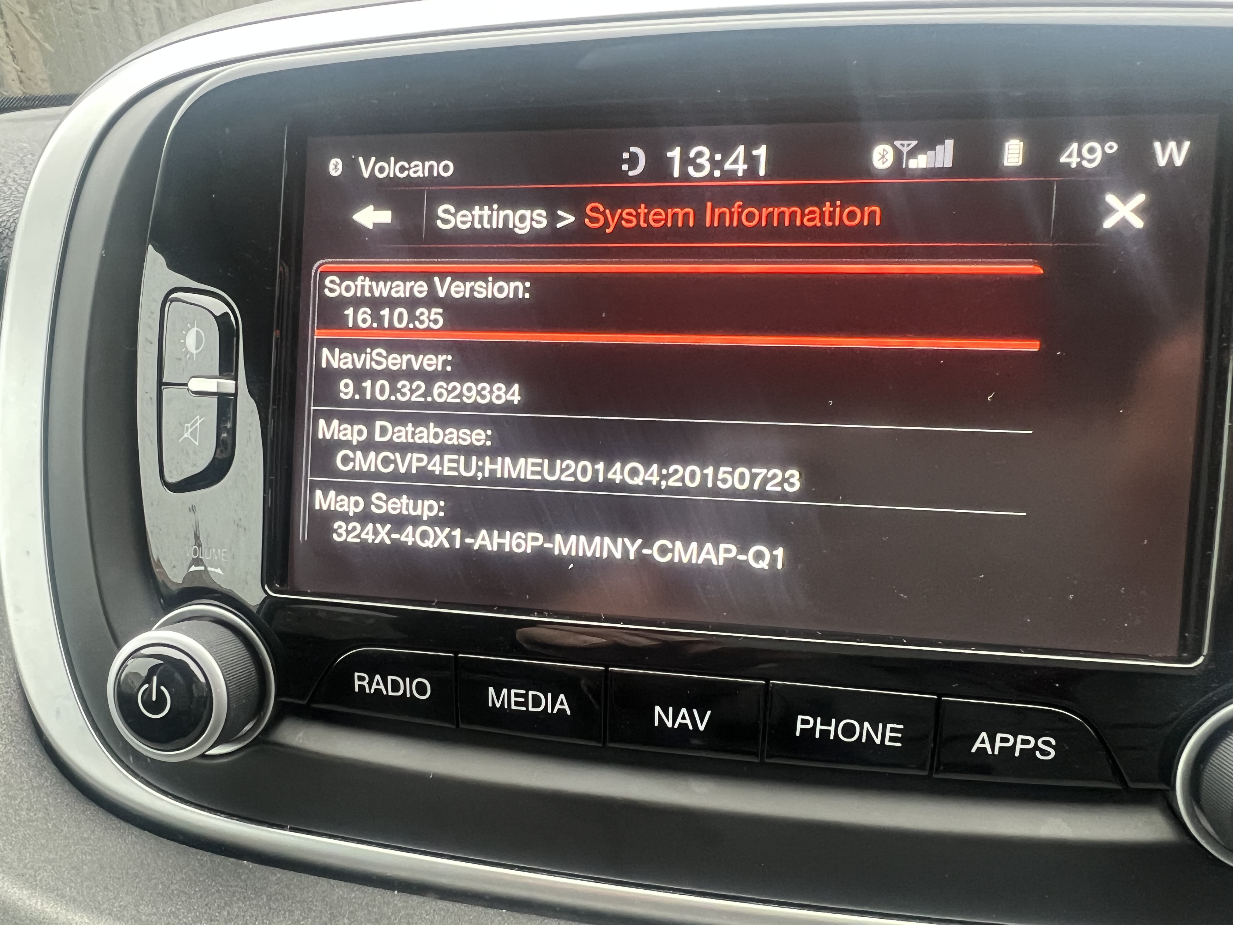

So I seem to have got a free map update. Although, I’ve no idea how I can check the unit’s software version or download it now?

Thanks for the tip on updating maps. Just got an update for my 2016 500X from TomTom. Mine took about the same time too. Now I can find my nearest Aldi ;) I have no idea where to find 'System Information' either but mine has Uconnect 5 rather than 7.
Thanks again.
