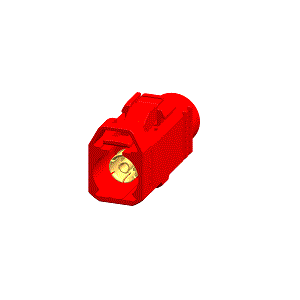

I need help activating the reversing camera in our mobile home, Fiat Ducato 2022

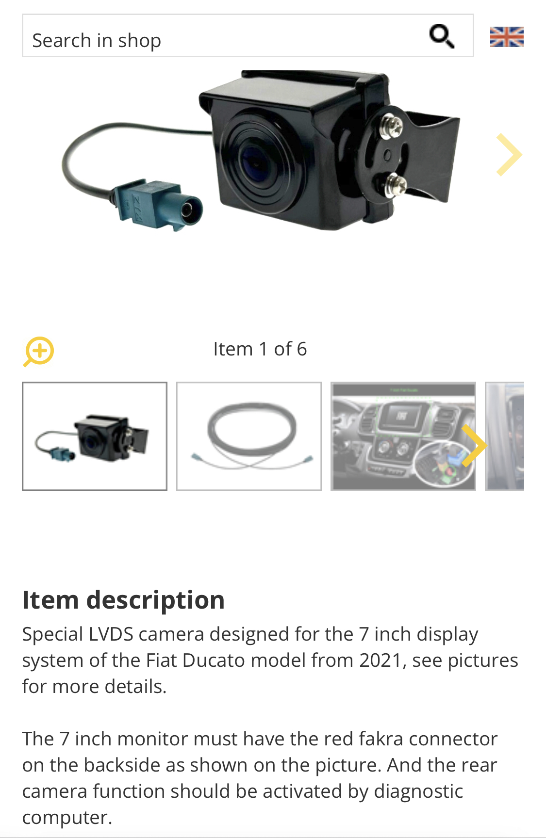

the problem is that I can't activate the camera input so it starts when I put it in reverse then the camera should start if it is plugged in otherwise the screen should turn blue when it is activated, But it is not possible to activate it, I have a diagnosis program Auto-com it's called and an account on "FCC-ID" and there is a function "Activate reversing camera" but it responds activation not possible.
This camera i hope to using
