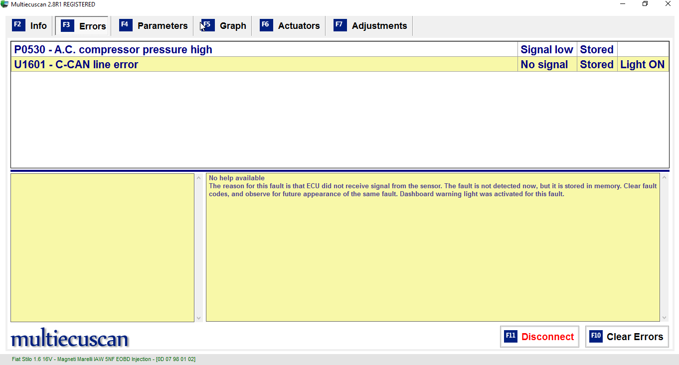

today tried to start lasted about 30 seconds, after 5 times starting finaly it ran and when it got warm was fine. checked for codes with fes, u1601. cleared it and tried restarting and checking for codes and all was good bar the ac fault which i know because it's disconnected due to the whole ac sys being shot.

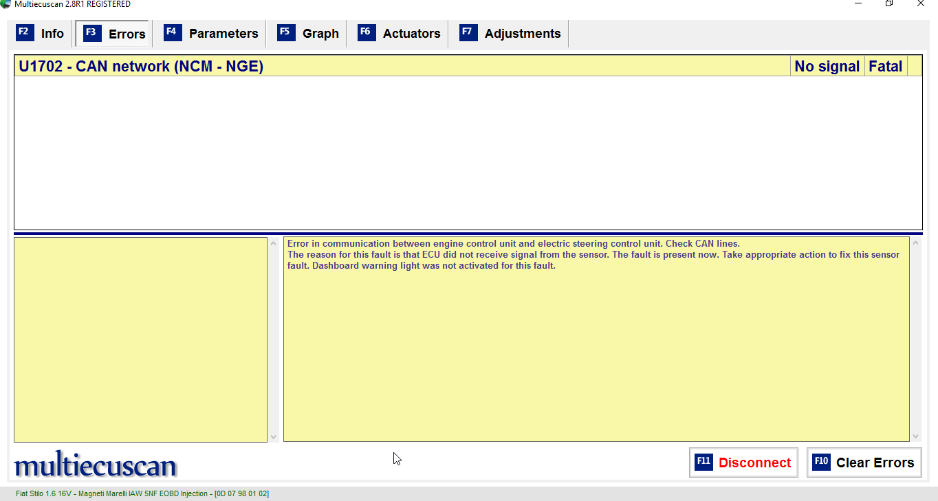

back togeather and plugged up, neg terminal back on, fes connected and ready, ignition on, BEEP BEEP BEEP!!! ABS ESP ASR LOOSE CONNECTION....started the engine and have no power steering, checked for codes, now coming up with u1702!!:bang:
battery and alternator are good, all fuses are good, any suggestions anyone?
