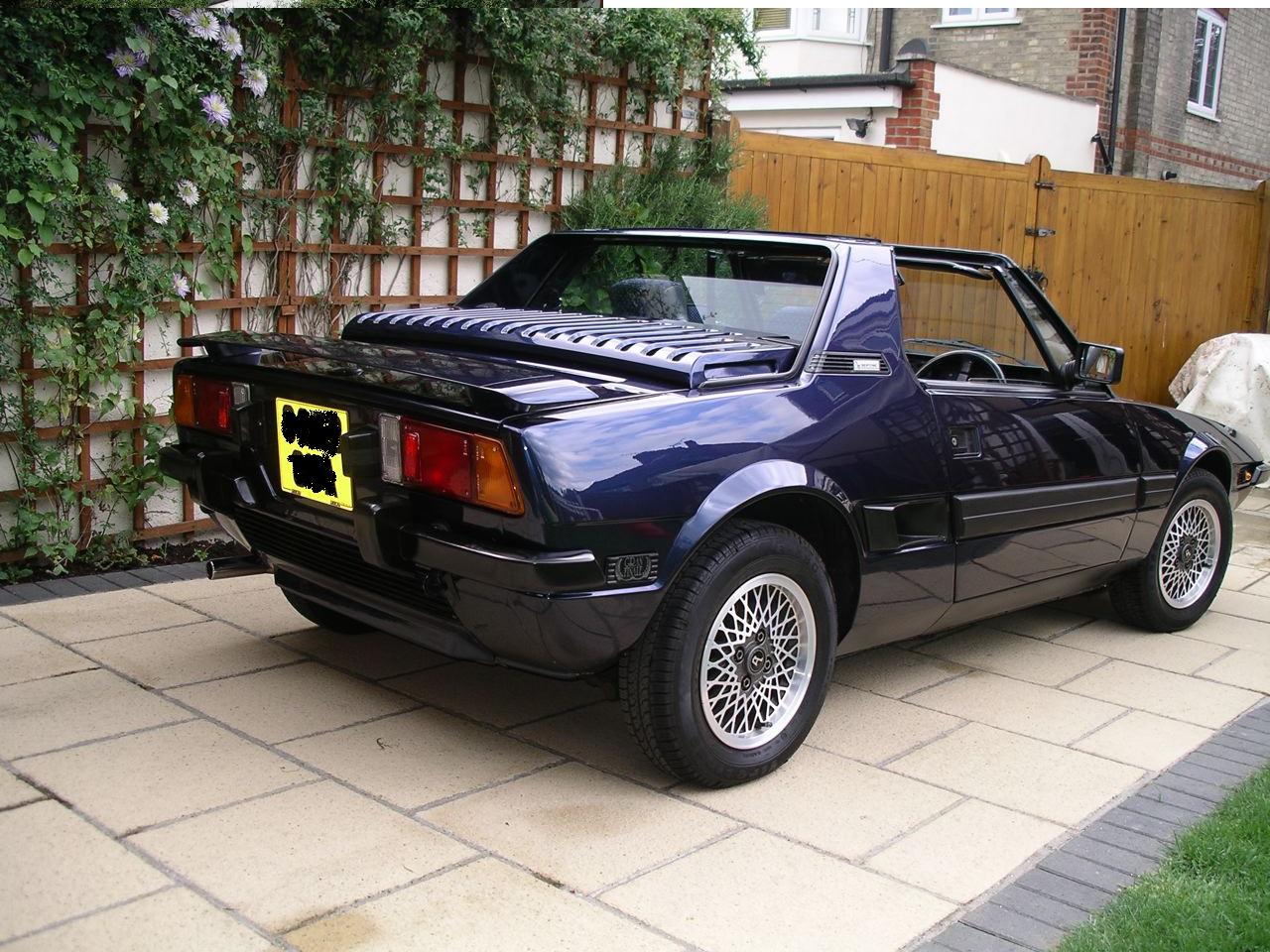

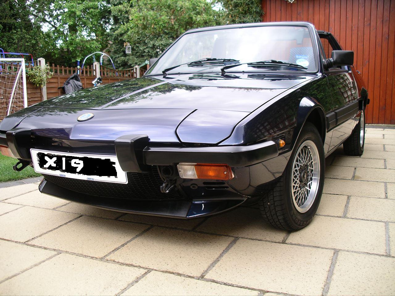

Hi all,
I've had my X for over ten years and whilst it was in good condition when I got her, I have since tidied her up to almost perfect condition, I have retrofitted the original 70's bumpers for obvious reasons and she has since been lowered by 30mm...I have attached a few piccys below......my next job is to get some larger tyres, so my question is what do you think would be the widest tyres I could get on the current wheels...the standard 165 pirellis don't do the car justice !

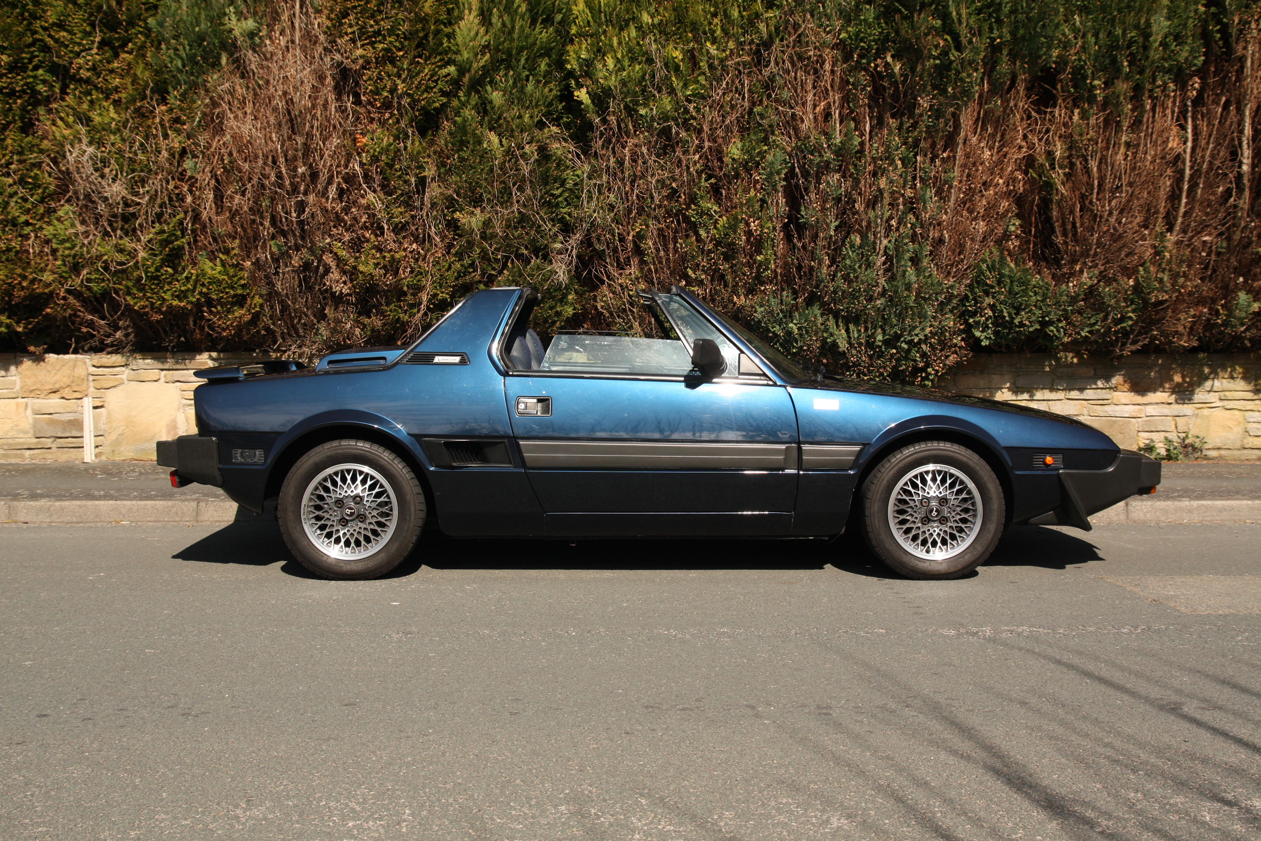

Hi, I've run my Gran Finale on the OZ Ruote wheels with 13" 185/60 Yokohamas for years. Its lowered on Jamex springs and the wheel arch liners are still in and there is no fouling or scraping. Personally I think the look is just right as I don't think the X1/9 needs bigger wheels just meatier tyres. I don't really know what tyres are available in this size now though.

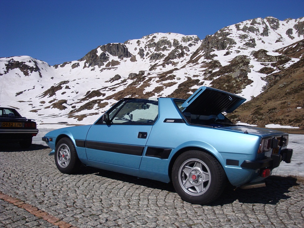

Hi Enzo
I use Continental 175 60 13 I have tried 185s on 13" wheels and I find them to be a little vague
Mark

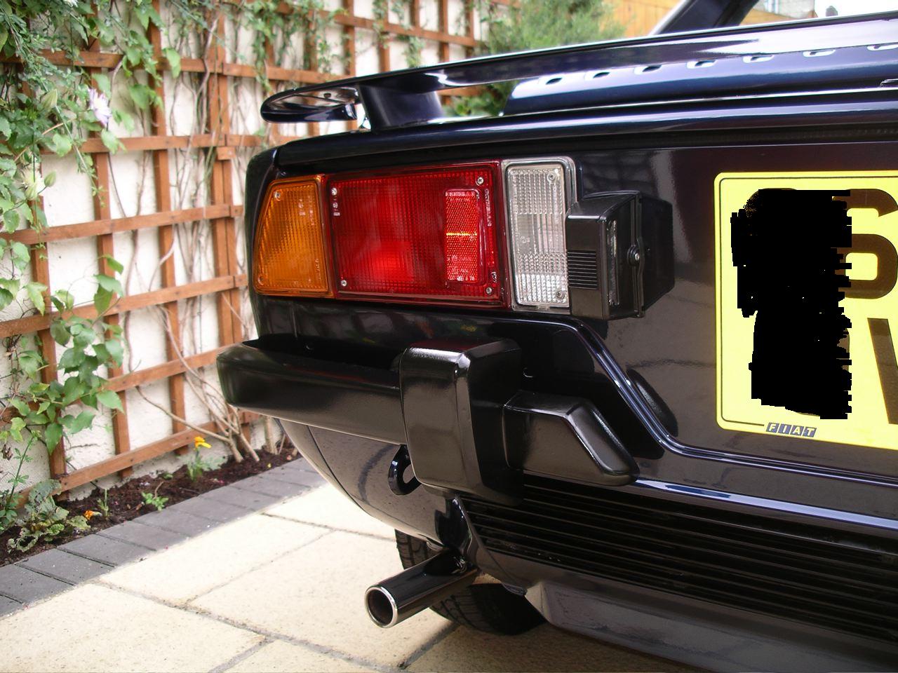

Hi enzo123
Cracking looking car,i have fitted 185/60/13 and they look very nice.Just a quick question off topic where is your rear fog light fitted, is it in the rear lights as i do not want a separate fog light if possible
Thanks Shaun

Hi Shaun, thanks for your reply.....185/60 or 185/55 seem the way to go ...
Thanks everyone for your replies ....
With regard to my fog light, its not physically fitted to the car at the moment ...I don't personally like it as theres no decent place to locate it
without it looking a bit crap....its wired and works, so at MOT time time I just hang it out the boot and then put back in the boot straight after!!
I don't drive my car in fog only in fine weather so doesn't really matter to me ! Love your Lido by the way....have you had it long ?

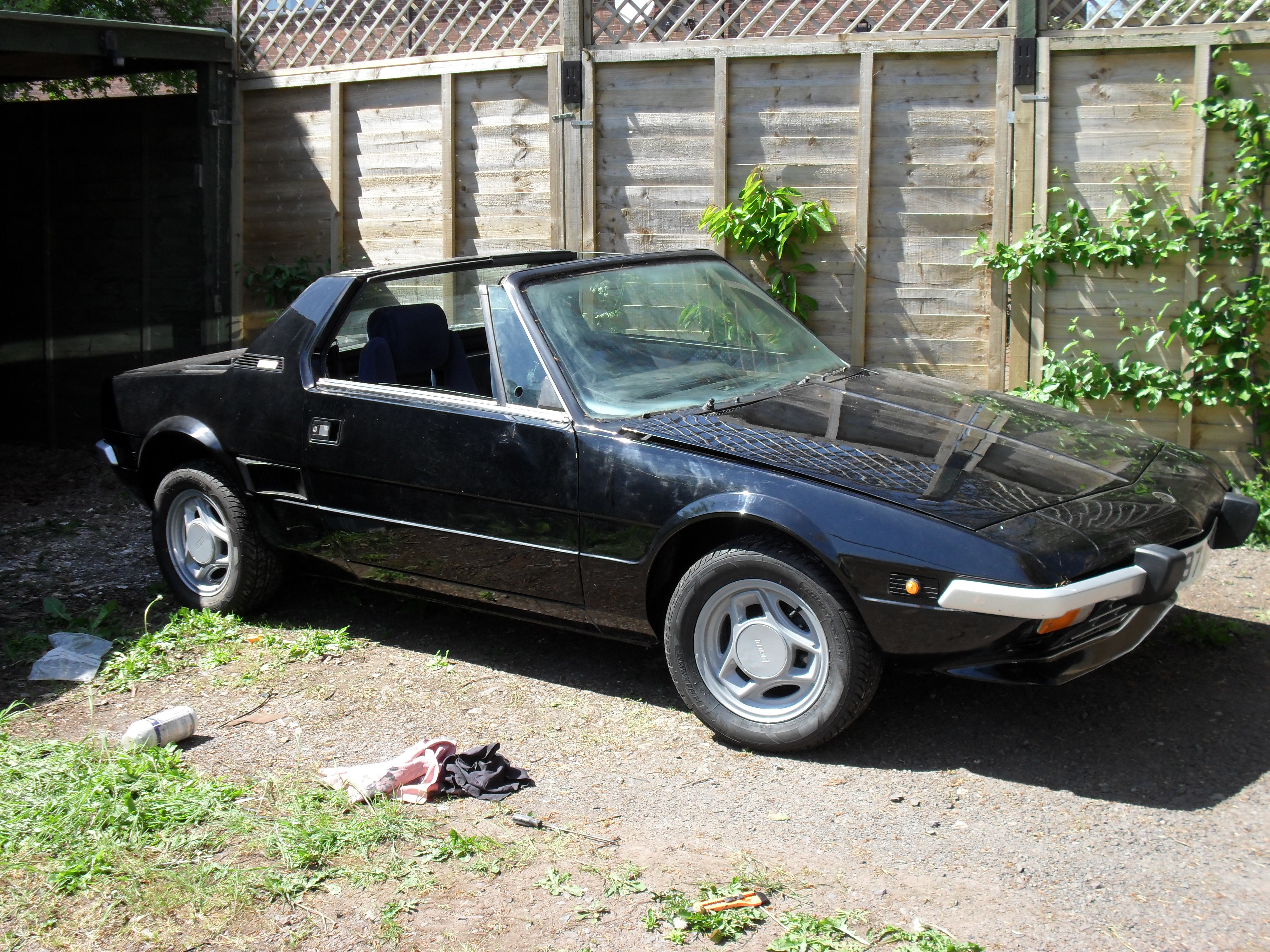

Thanks enzo123
Just wanted to know for the MOT. I been restoring it for about 2 years on and off and should be on the road by the end of the year.I love the look of the Lido but mine is not unfortunately.Just cheated a bit with the fibreglass bumpers and wheels.I have managed to find as much chrome as possible for it and made the front grille myself
