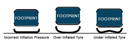

Well there you go, one of the causes of outside edge wear is under pressure tyres in corners.
If you look at the "recommended" tyre pressure chart for Stilos on 16s it says 2.1bar for the ENTIRE Stilo range. The JTDs and Abarths are over 300lbs heavier than the 1.2. You don't need to be a scientist to see that can't work

I can only say what i use Stu and you have to make your own mind up. I use 2.3bar (33-34psi) on 16s for about a year now and it runs as straight as a dart now with a nice flat footprint of even tyre wear across the tread
Before it would camber follow and need constant steering corrections. Even the 1.6 with air con is 200lbs heavier than a 1.2, almost all of it on the front
