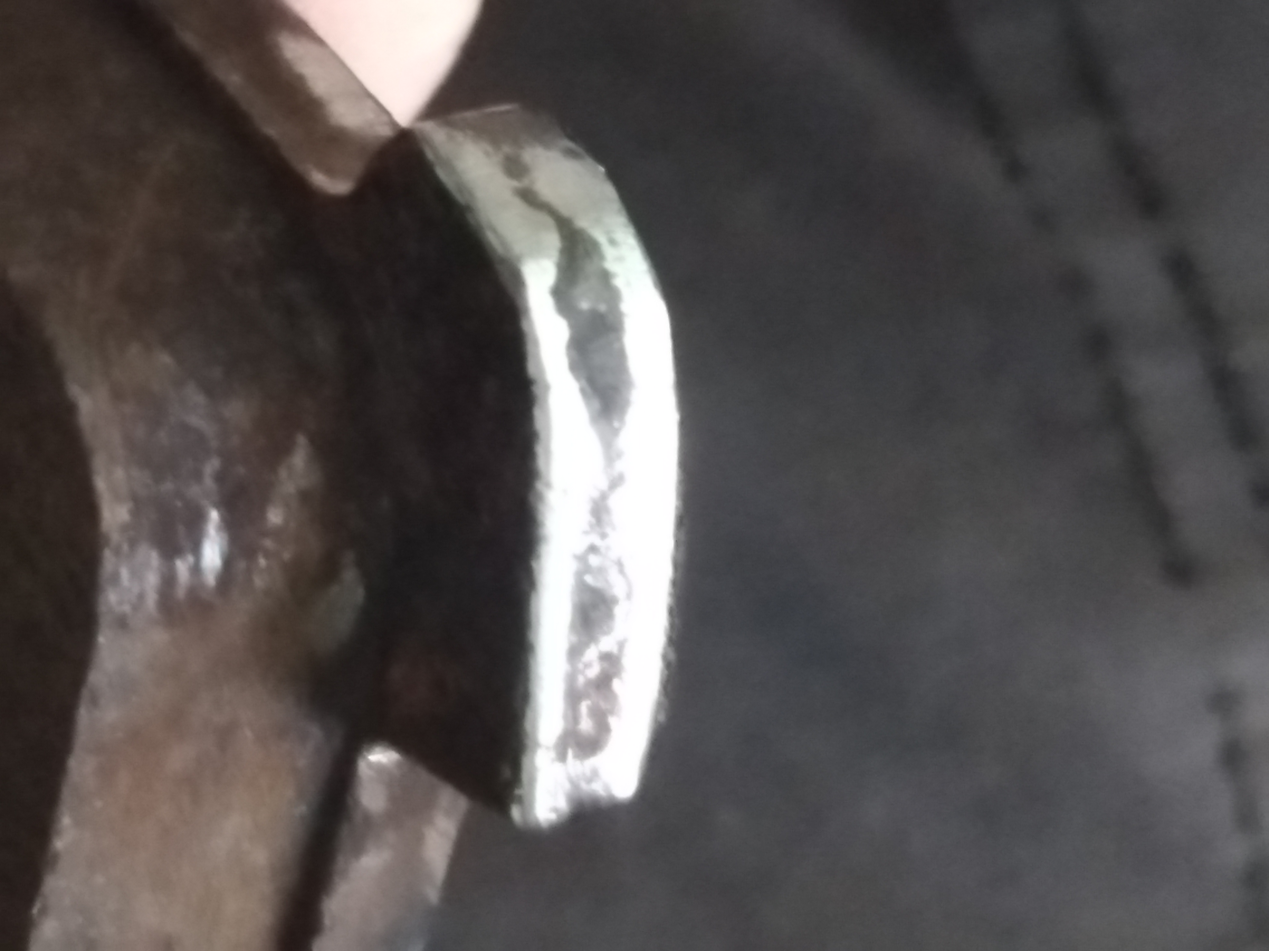

But the metal plate has been guillotine out leaving sharp edges, most pads I have bought over the last few decades have need a little work on the ears, a blob of paint is very common
A quick file to knock off the sharp edges, it doesn't have to be perfect and a slight shamfer added
And a quick spay of primer to stop it rusting

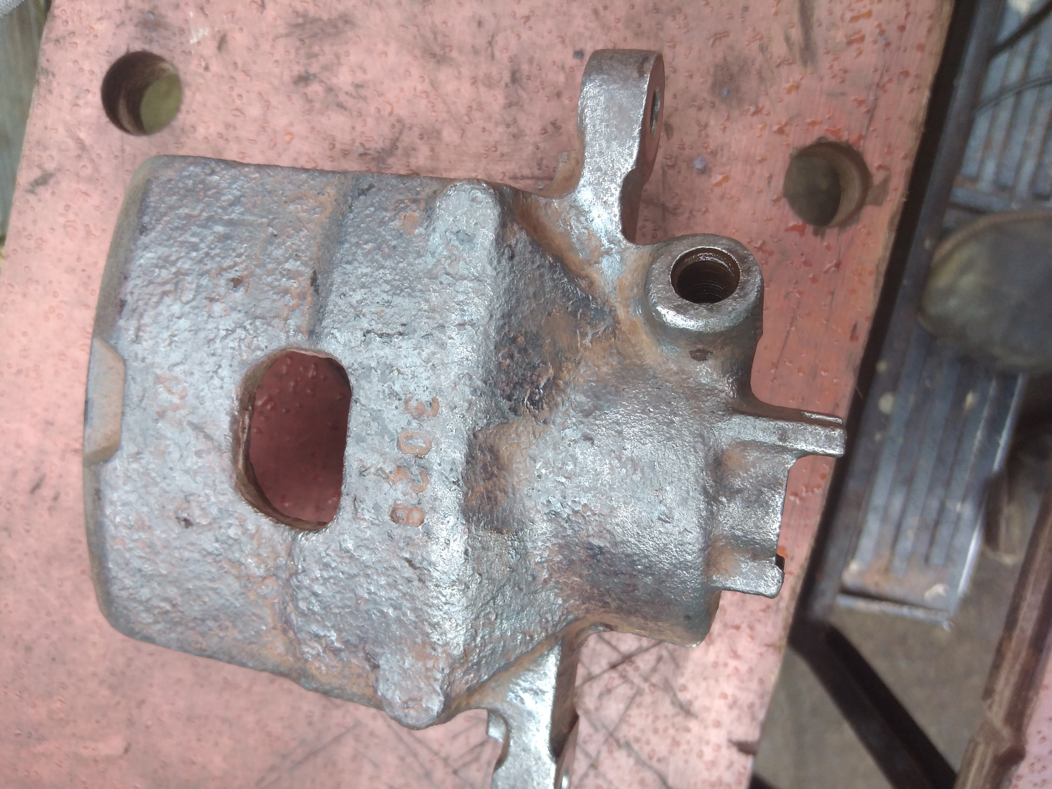

Not really necessary but it make it nicer to work on if I clean them up a bit makes much easier to assemble the seal dirt free
Attacked with wire brush
Again not necessarily but a quick spray of primer
