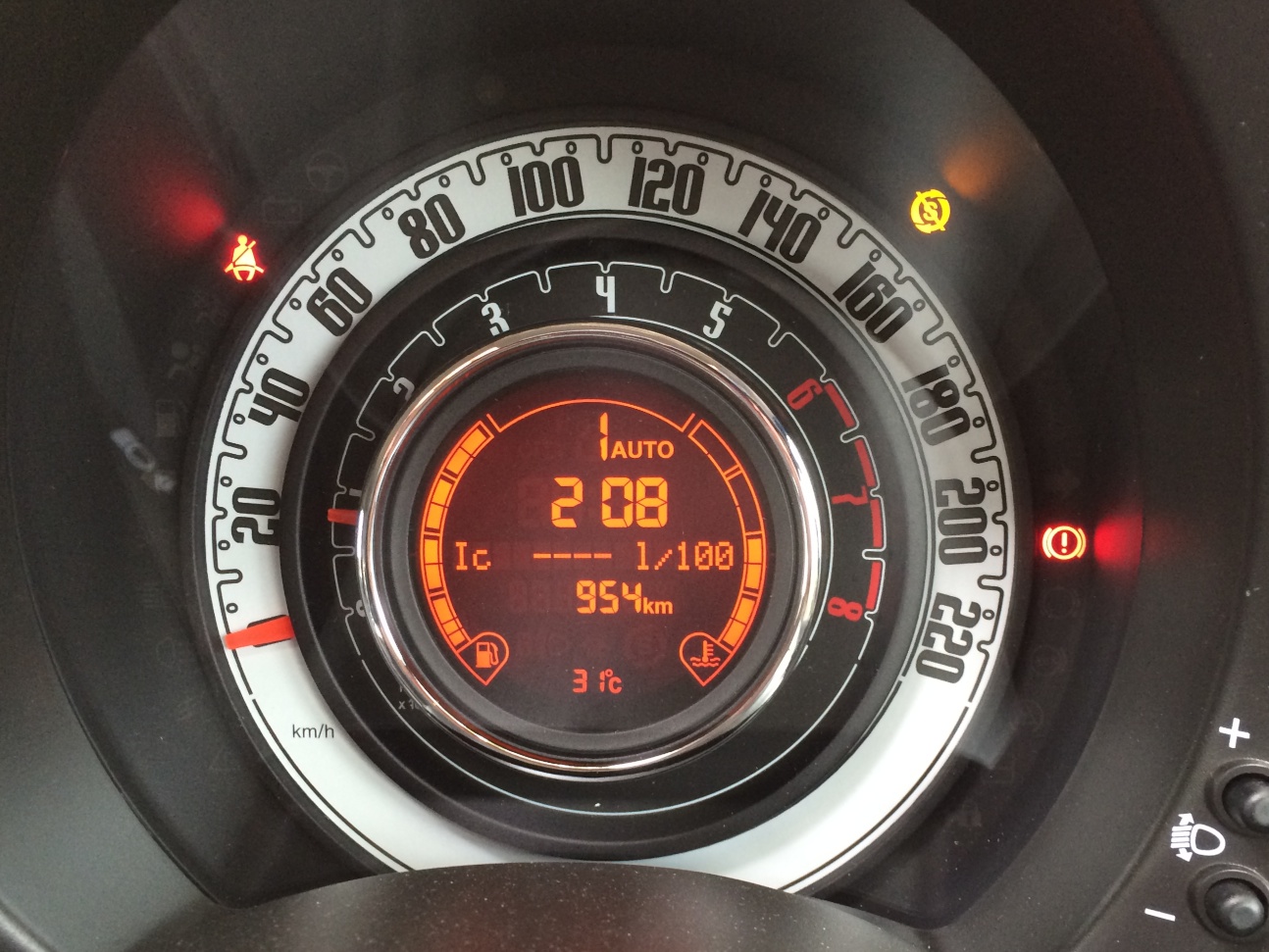

Mine appears to sit on around 850rpm after a 10-minute drive. Engine is still pretty new and hasn't been run in that much.
Ours sits on around 1000RPM. I always thought it was high. I'll have to hook the scangauge up to it to get an exact reading.
