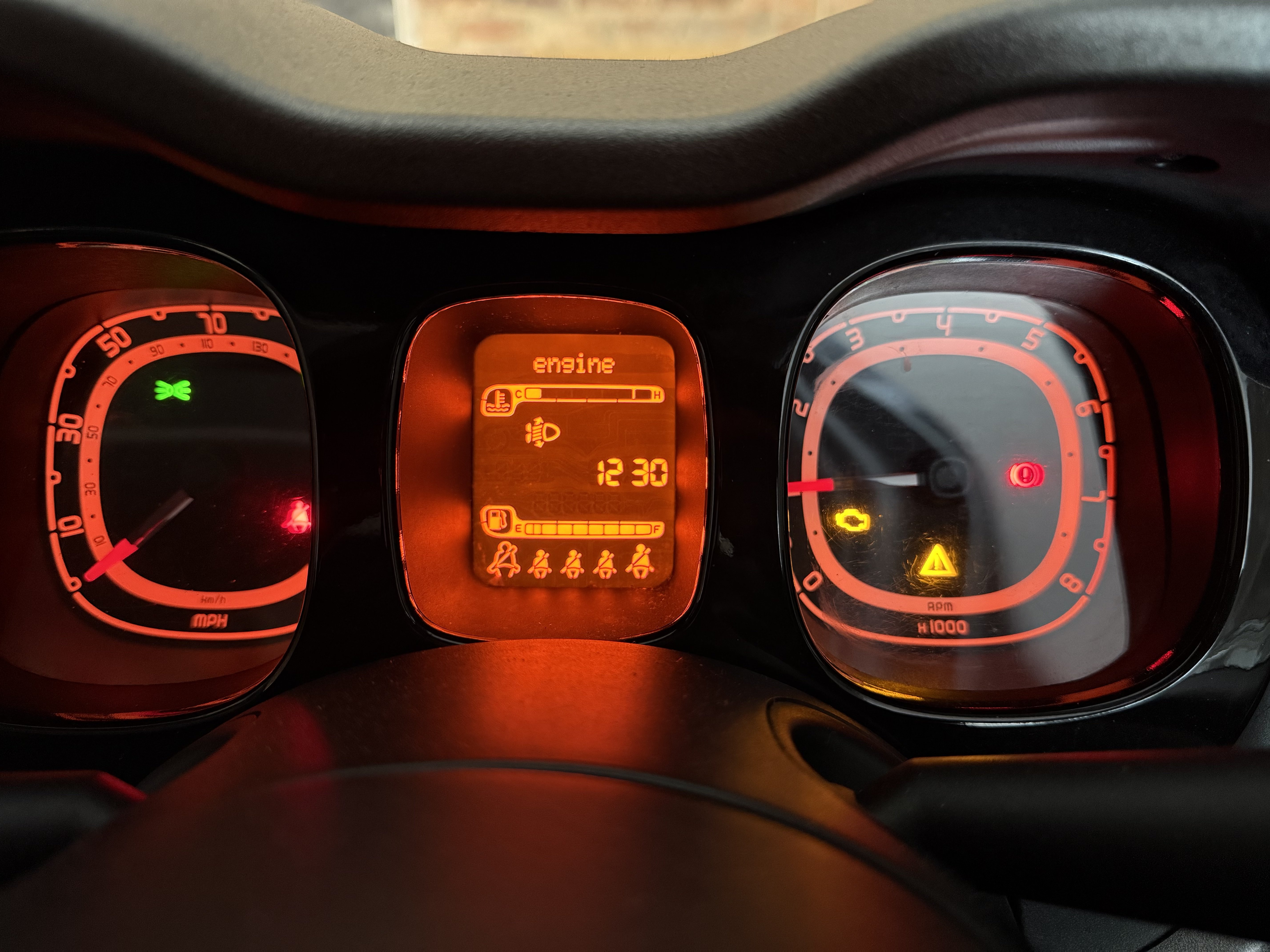

Battery Fully Charged. Still getting engine warning light and hazard light, with messages “STARTSTOP UNAVAILABLE” and “CHECK ENGINE” on the top of the display 😬

New battery fitted and still getting the engine warning light, hazard triangle and check engine/stop start message.

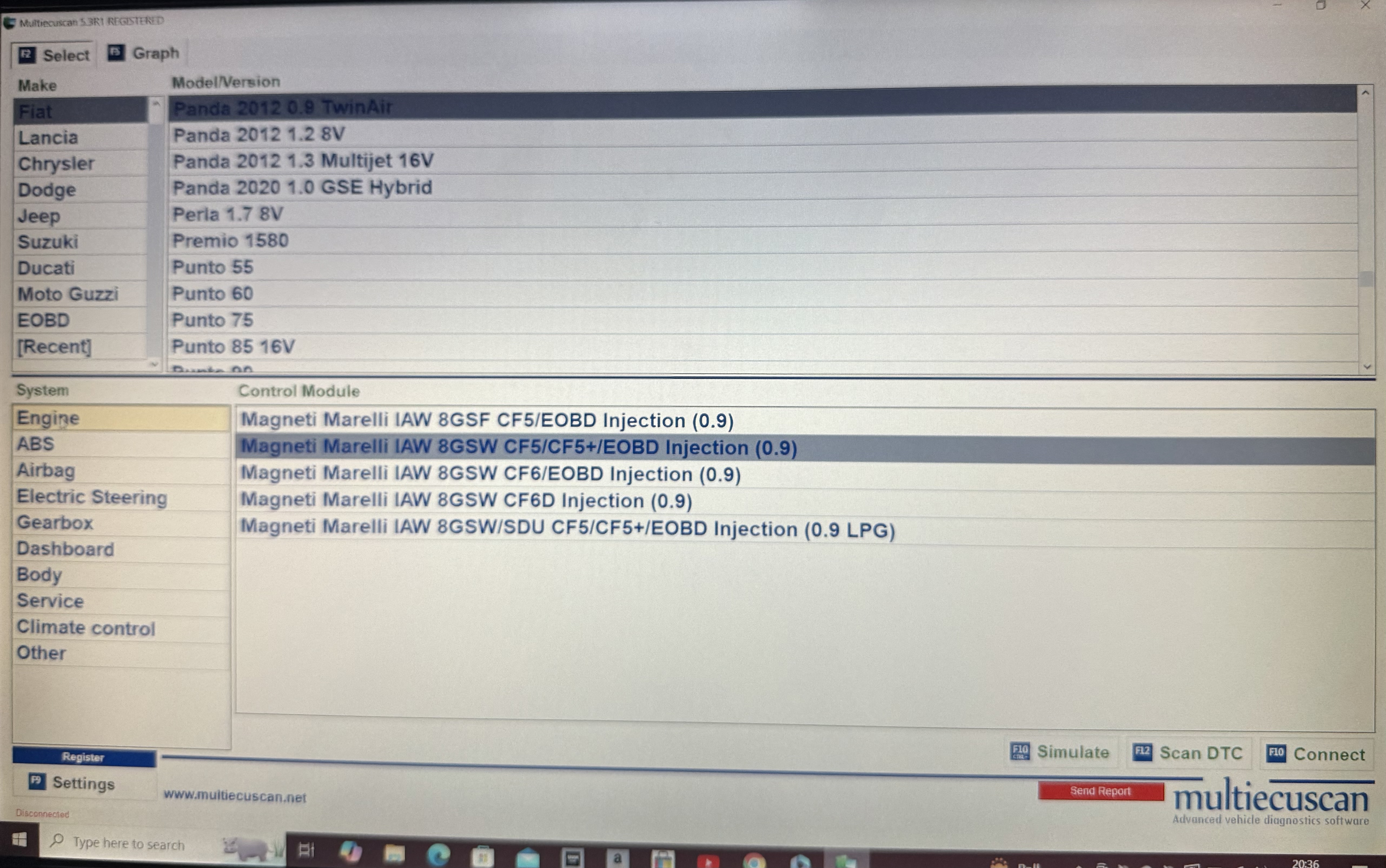

I’ve tried to connect again to MES, will connect for service etc. but can’t connect on the engine section. Not sure which of the 5 options is the correct one, but none appear to connect. I get the error message below.
Does anyone have any suggestions?

I believe CF5 is euro 5 engine and CF6 is euro 6. You don’t want the last option as that is for LPG only. If you can connect to some other modules but none of the four engine options then I would suspect your ELM lead or connectors as it should connect to one of them. What other modules can you connect to?
Just tested:
None of the engine options connect.
ABS doesn’t connect.
Electric steering doesn’t connect
Gearbox doesn’t connect (4x4 coupling control)
Climate control doesn’t connect (I don’t think it’s fitted)
Other doesn’t connect (parking sensors- not fitted)
Airbag will connect
Dashboard connects
Body connects
Service connects
I’m not really sure what should and shouldn’t connect to be honest so wasn’t sure is it was an interface issue…

Use "SEARCH for Devices,"
It will find all the various kit on the car🙂
Which cable are you using.. Check with the MES Supported Vehicle list 😉
So do you have an adapter connected to the ELM device? To access the ECU you don't need any of the coloured adapters, just the ELM327 lead on its own. Just try that and see how you get on.
Perfect, thanks. Removed the yellow adapter and managed to connect to ‘Engine’ on MES.
